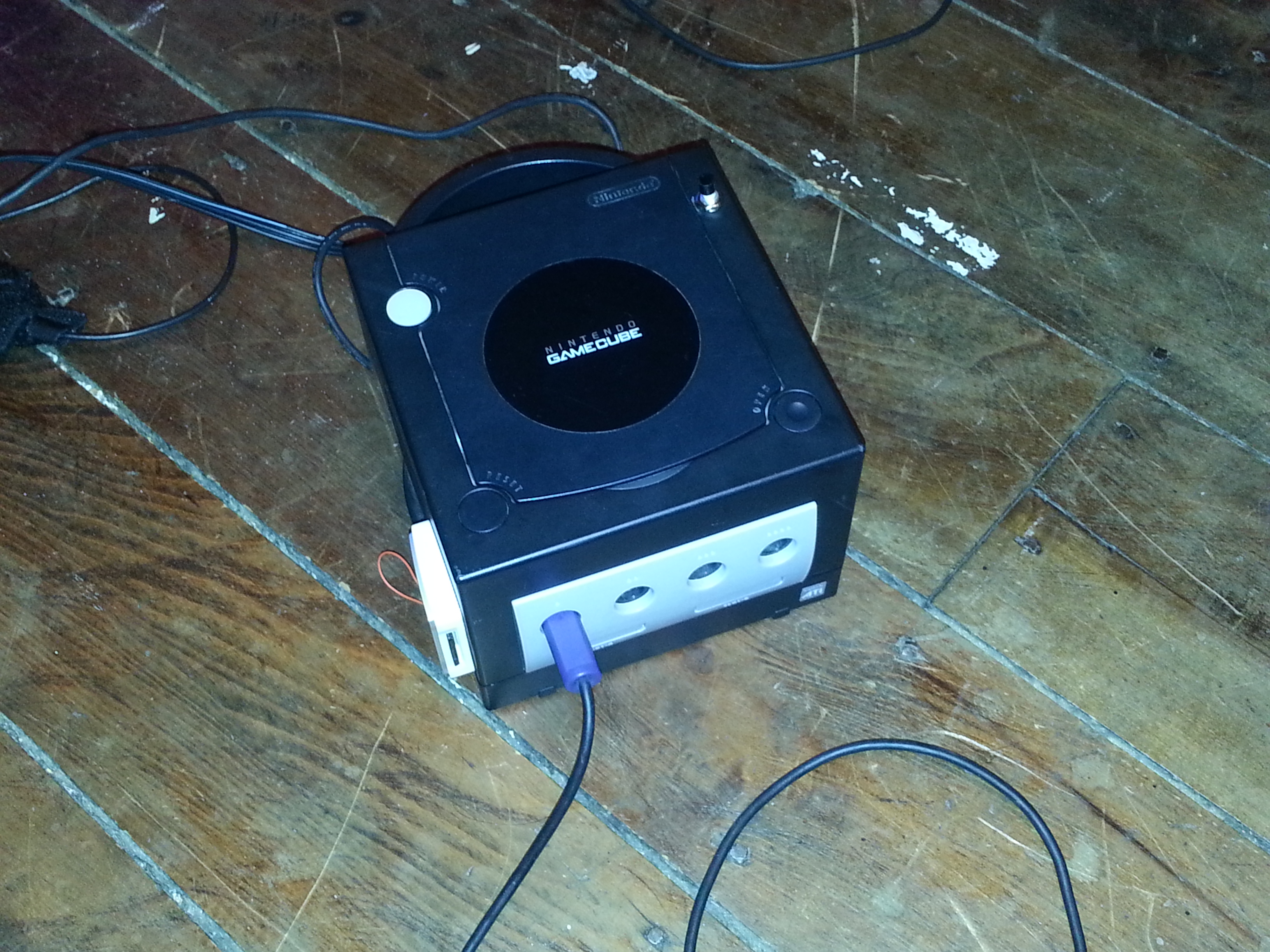

I uhh, made some improvements:
- (89.81 KiB) Not downloaded yet
- (77.31 KiB) Not downloaded yet
- (84.62 KiB) Not downloaded yet
- (76.9 KiB) Not downloaded yet
- (76.56 KiB) Not downloaded yet
Nice pics
I really do miss that old CRT feel sometimes. I mean it was inevitable that flat panel displays would take over in the end but I just didn't realize what I left behind when I threw all my old CRT sets out
After dropping the sd card into the hole next to the slot and taking the console apart to retrieve it I decided to fix that:
I also taped the sd slot ribbon cable down so the plastic bits from the lid no longer collide with it when opening / closing the lid. Sorry I keep posting new pics I just started modding my first gamecube last week so I'm going through the paces quickly.
- (97.68 KiB) Not downloaded yet
- (85.02 KiB) Not downloaded yet
I like the placement of your SD card slot! Though it's unfortunate that your DVD drive will no longer function
I look at it from the perspective that I now have a bunch of fully working dvd drive replacement parts haha.deckard wrote:I like the placement of your SD card slot! Though it's unfortunate that your DVD drive will no longer function
