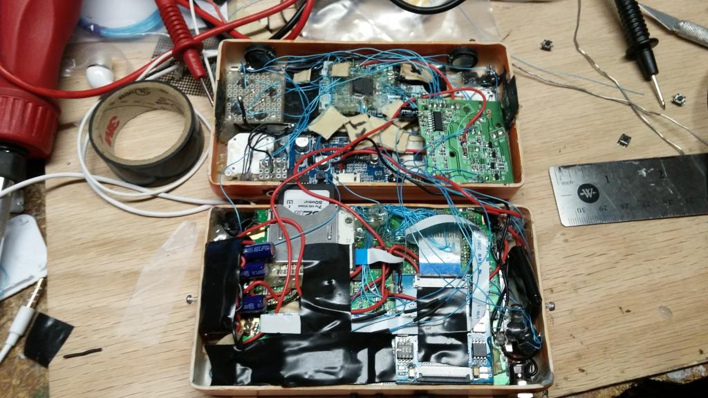

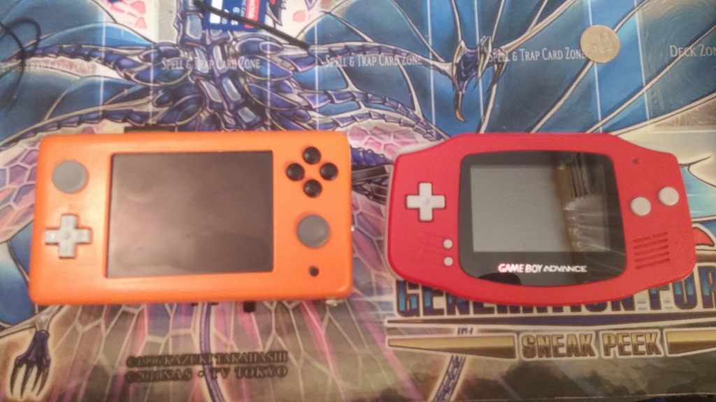

Here's another portable that I finished up a couple months or so ago. I call it the Creamsicle Cube. The case was made by Gman. I bought it from him since I was interested in making a small portable Gamecube and I hadn't yet received my vacuum former to make my own. Well here it is folks and feel free to tell me what you think.
Features;
3.5" screen
Dual 3ds Sliders
Stereo Audio with switching headphone jack and Digital volume control
Single Tact Modded L and R buttons
Wiikey Fusion flashed with the latest Swiss
8 Sunon Mighty Mini fans with trimmed GC heatsink for cooling
OMGWTF cut CPU 11 motherboard with IPL 1.1
Measures 138mm (W) x 75mm (L) x 38mm (D)

That's a pretty sweet form factor!

Thank you. I just wish I culd have fit the battery in like I planned. I ended up having to prioritize better cooling instead.

Tell me about it. I almost had it with this one too. There was space, but I had to use a thicker heat sink instead. Oh and thank you. :D

It took a couple weeks, but most of that was waiting for the parts to come in. I want to say it took about 36 hours in total.
