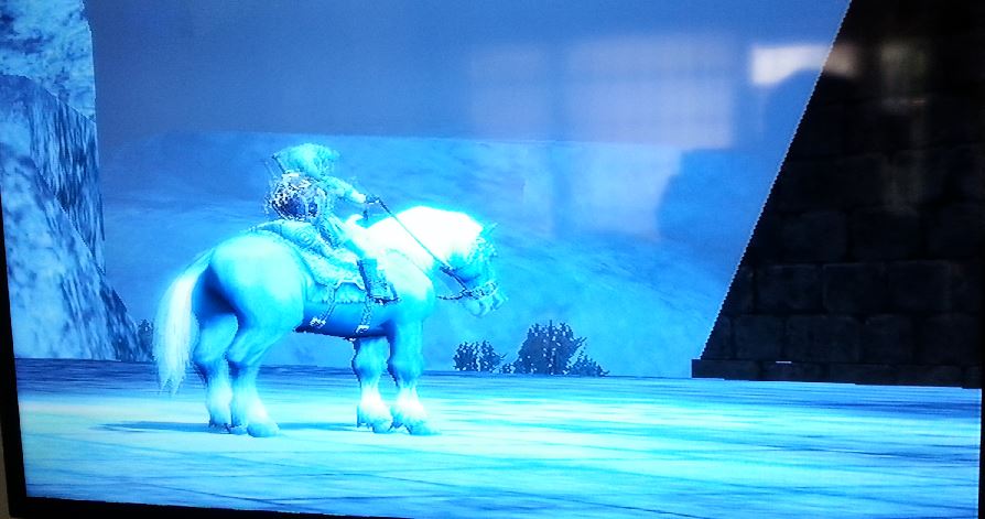

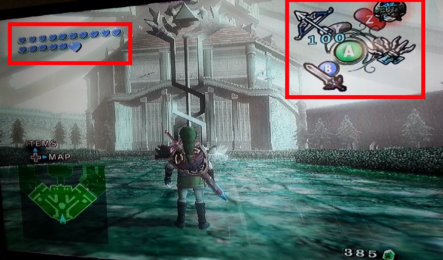

Game The Legend of Zelda - Twilight Princess (redump.org verified, compressed with DiskEX-v0.9)
Region NTSC-U
Medium SD Gecko
Swiss version r363, r342
Optional save file (.gci) n/a
Optional on screen crash dump screenshot n/a
USBGecko log output n/a
Detailed report of the issue
- the game sometimes runs in blue colours after selecting progressive mode from the game menu
- forcing 480p from swiss seems to work every time

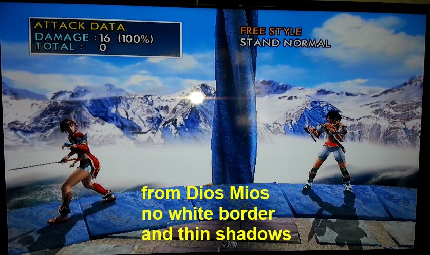

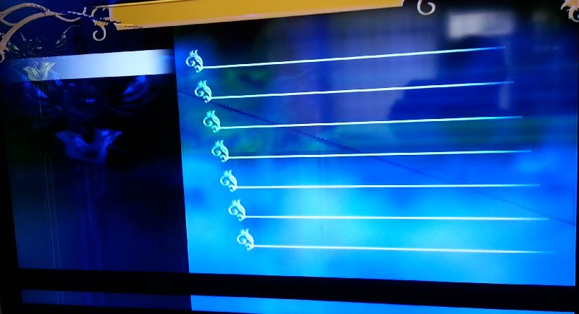

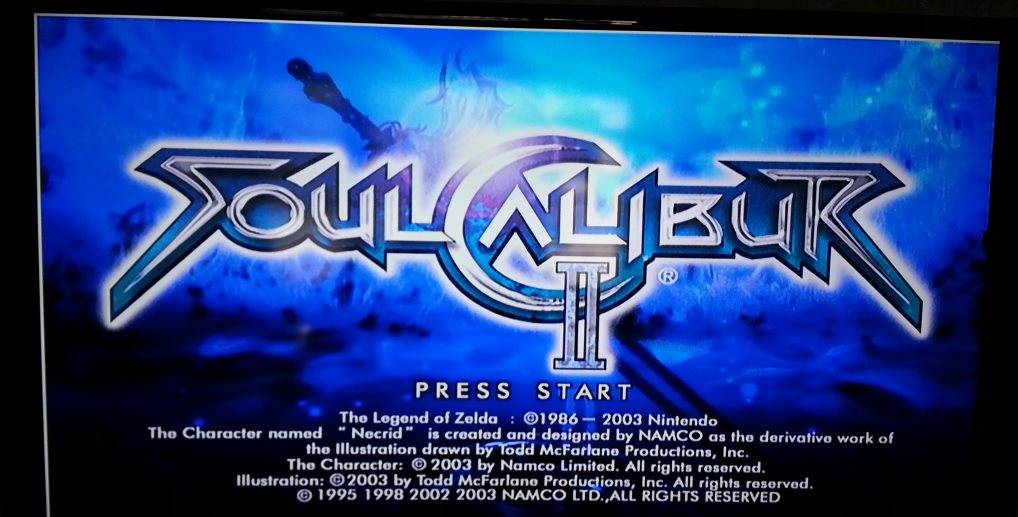

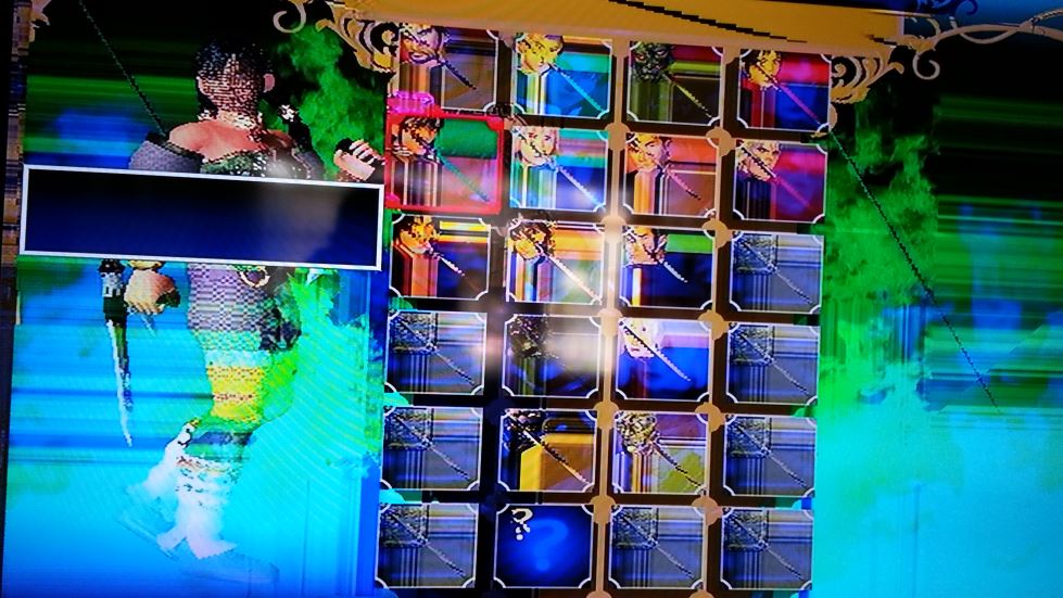

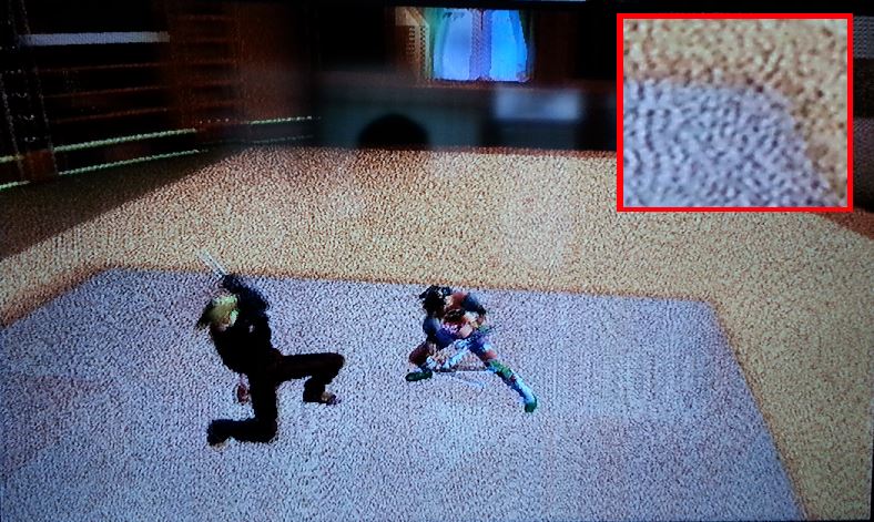

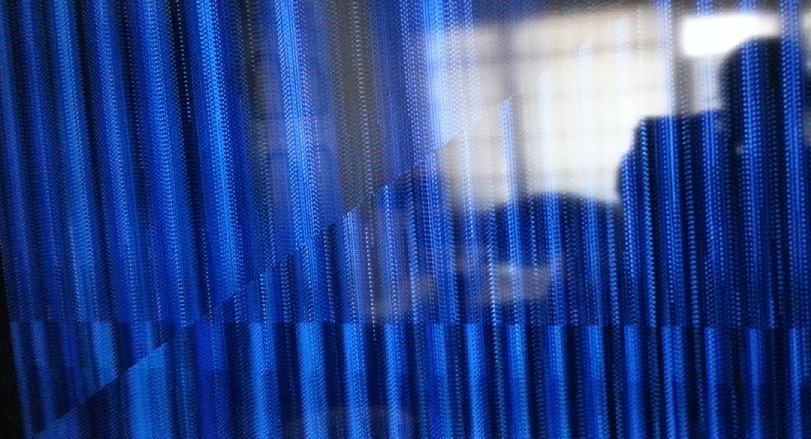

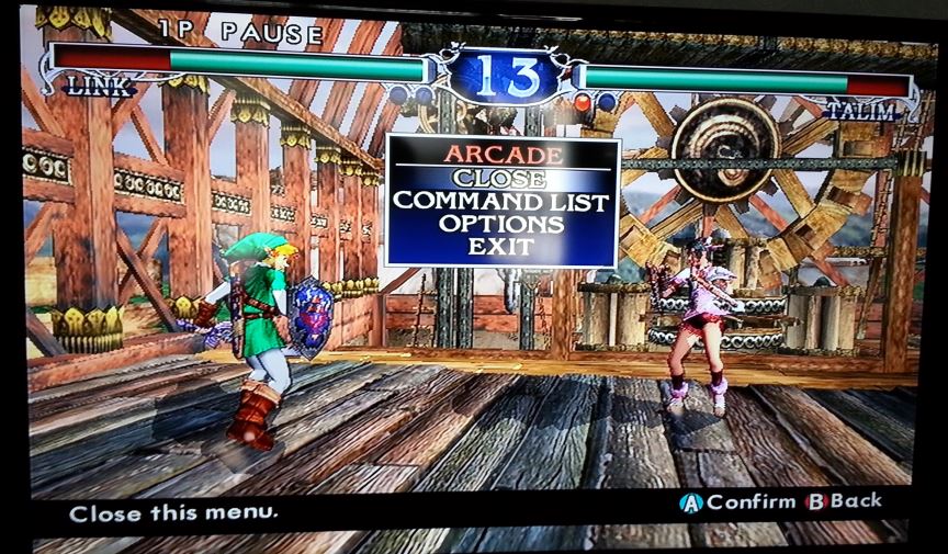

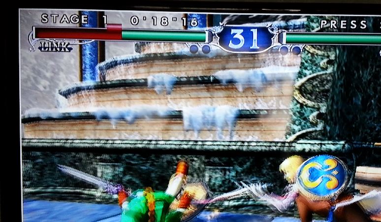

Game Soul Calibur II (redump.org verified, compressed with DiskEX-v0.9)
Region NTSC-U
Medium SD Gecko
Swiss version r342
Optional on screen crash dump screenshot USBGecko log output n/a
- Running the game without patches/480i forsed/480p forsed/fast mode/compatible mode makes all graphics glitched on title screen and everything after that [most of the times but not every time].
- With compatible mode glitched once so far.
Other small issues After start of battle the picture jumps (about a pixel) from top and left, in some levels white border appears. If return to title screen and main menu the border is still visible. This issue doesn't appear in Nintendont or Dios Mios [the same level is shown on the second picture below from Dios Mios with no border].
The shadows are too fat. The second picture is from Dios Mios and shows thinner shadows.
I always run the games with lid opened.

Region NTSC-U
Medium SD Gecko
Region NTSC-U
Medium SD Gecko
Swiss version r342
Spoiler
Show
Other small issues
Spoiler
Show
Spoiler
Show
I have one suggestion. Can you put the file browser with different button instead of A + toggling from the menu. There are so many free buttons.

Re: Submit Compatibility Issues Here
Edit 3:
Zelda TP actually doesn't have problem with widescreen patching (it was just a luck to run normally in my previous testings). Starting the game without any patches also run in wrong colours. [the console is PAL]
Tried with another SD card fresh formatted and the problems with both games appeared.
I want to put a little update with the newer version (r363). Everything seems fixed except one but I know why it appeared randomly.
The Zelda colours - look the edit, shadows - fixed, jumping screen -fixed, white border - fixed.
The glitched graphics in Soul Calibur II - if I mash start and/or A button on sofdec logo to skip the animation with smoke the game works perfectly (every time so far). But if I wait for it the graphics are glitched (but not every time, I've seen the smoke few times perfectly with previous versions).
Edit:
The Zelda colours aren't fixed, it's random but I don't know what I do differently.
Edit 2:
While I was editing this post I had left Soul Calibur II playing in a fight. I was beaten, few cutscenes appeard, after that high scores and the smoke animation started again, glitched. I've pressed a button to skip and everything was glitched like before.
Edit:
Edit 2:

@megalomaniac: Your issue is because of slower speed of SD Gecko but mine is different see the pictures.
I don't thing you understand me so everything I can do is to make more pictures and I am done about reporting these issues:
The smoke animation:
Main menu:
A battle:
I've never uploaded pictures about Zelda because I think the issue is common.
Title Screen:
In game:
Main menu:
A battle:
Title Screen:
In game:
I remember coming across this very issue regarding Twilight Princess (NTSC version) in an older revision of swiss when played trough SD gecko (for testing purposes). Apparently the red and blue colours are swapped (green is fine). I just tested it now again, and it seems the problem only occurs when displaying in progressive mode (480p). On top of that there were some artifacts (a few lines) at the top and bottom of the picture.
When selecting 480i however, the game's colours display correctly. Maybe the problem only exists in certain titles (Soul Calibur 2, Twilight Princesst) when selecting progressive mode?
The game plays fine in both 480i and 480p with wasp fusion though.
Looking into it at the moment, thanks for the pictures
The color swapping happens when the switch into progressive mode is done during the wrong field transition, it also normally stutters along at half-rate and crashes if it tries to change modes again.
