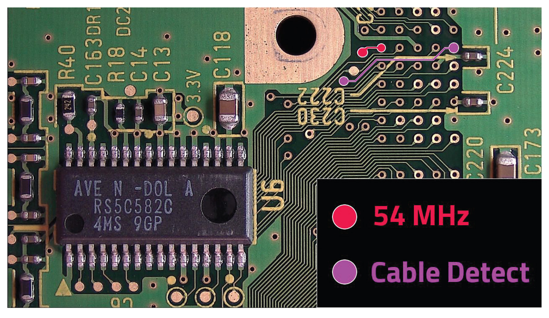

Just a quick thought. I'm the kind of person that likes to try a few things before moving on. Say something happened to the pad/trace at pin one on my digital port, would the location below (see attachment) from BAC's GCvideo guide suffice as a backup soldering point or is that only present on D0L-101s ? Thanks.

So I think I found my problem. The trace for pin one on the bottom side of the GC main board lifted. Anyone know a suitable alternate solder point for the cable select on a DOL-001? Thanks

OK so it was indeed a lifted trace. I wound up scraping away the silk screen to expose the trace, soldered a single copper strand to the trace, then jumped it to a wire connected to pin 20 on the pluto. Fired up the cube and Progressive scan is working ! Thanks everyone for all your help !
Re: HMDI Pluto II Help
So I lifted cable detect aswell. Causing no audio or able to use controller for menu . Need some help finding where that trace leads. Thank you in advance
