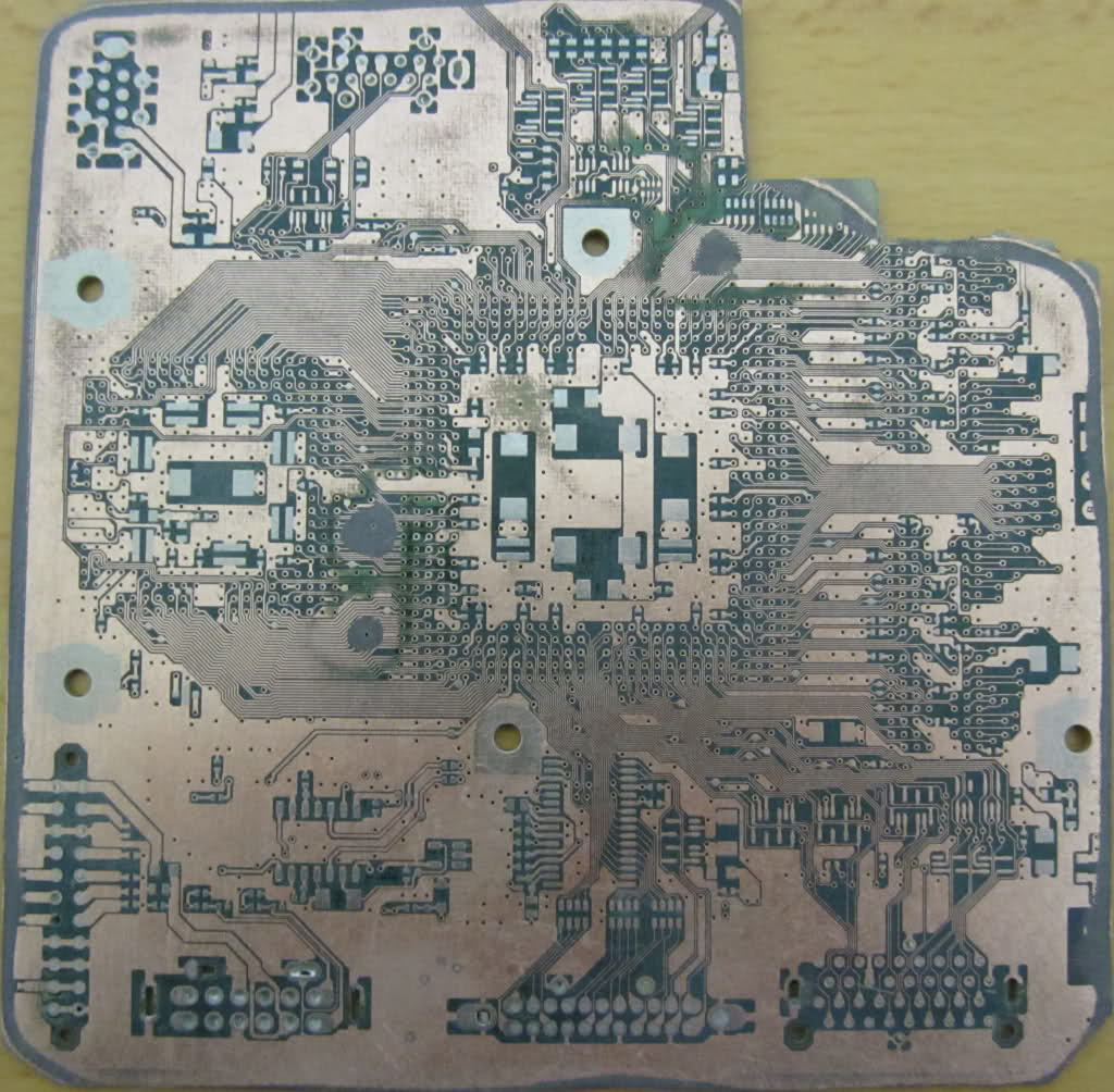

A friend helped me remove the initial DV port giving me this:
https://photos.app.goo.gl/AQ9ODZGL36Cf7Om03
I had some difficult cleaning up the pins on the motherboard and may have damaged ports 1 and 3:
https://photos.app.goo.gl/7g1tQpSunXrXVois1
or
https://photos.app.goo.gl/Tte26In2GUXArVQ32
I found this online in order to determine where the pins should lead:
https://www.gc-forever.com/forums/downl ... hp?id=2482
I checked to see if there was a connection between those points and couldn't get a reading so I attached some wires to the joints:
I've used 26 gauge wiring up until this point where I use part of an old PATA cable. Testing the connection seemed to yield good results with no resistance between wiring and attachment.
After doing that I did all the work to attach the mod:
Again I've used part of an old PATA cable for the controller connection.
I've also put a 100 ohm resistor as described in the guide.
Sadly plugging it in yields the following results seen in the video.

Fully functioning now. I'd soldered the controller into the wrong place on the fpga board. It only works on my computer monitor with the line doubler on..
