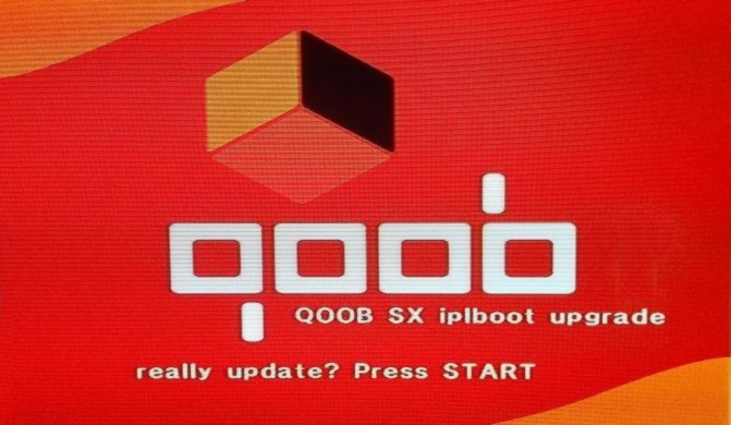

I hope you don't mind, I have just made a little change to your ELF! Now it shows the text "QOOB SX iplboot upgrade" instead of "QOOB SX upgrade to 1.3c" which it not true!

I also build an ISO everyone can burn on DVD and upgrade:

Re: Qoob Chip
Post by novenary » Thu Jun 14, 2018 7:33 am
That's a good idea, I'll include it in the build script.

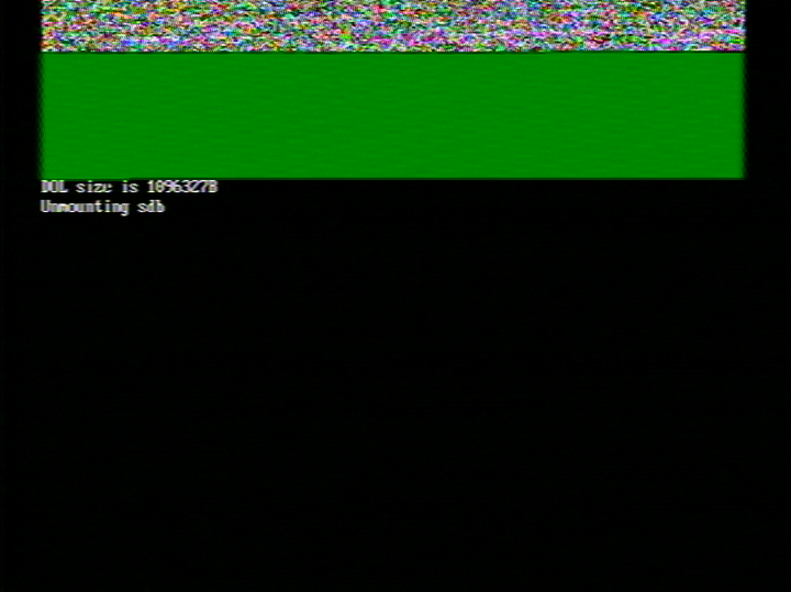

Maybe I need to do more testing then. All I've tried is loading a dol over USB and it worked. I didn't test SD loading nor flashing to the Qoob. The difference is r5.1 is actually compiled with optimizations for size, r5 wasn't due to an oversight.

toxic9, do you see something like this when it fails to boot?
Do give r5.2 a try, I've tested it on my Qoob Pro this time and it works.

Post by toxic9 » Sat Jun 16, 2018 2:09 pm
Hi friend!
Yes, that's something like that!
r5.2 is perfect now. Pro and SX versions are OK.
