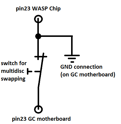

I was wondering how multidisc swapping would work with a grounded pin23 connection.
I'm guessing I'd have to install the NC switch so that for an open lid pin23 on the motherboard gets disconnected from GND and pin23 on the WASP?
Like shown here:
(8.38 KiB) Not downloaded yet
Or would I have to move the switch above the GND connection to keep disc (SD Card) swapping working?
Thank you!
