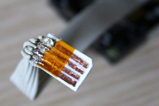

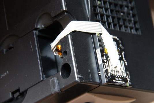

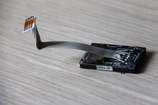

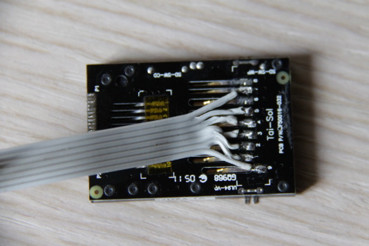

Posts: 924
Re: Hi, about Serial port 2 USB for Swiss, any chance?
Post by Papy.G » Thu Sep 19, 2019 10:18 pm
I think this made off parts and bits off the trash (except for the copper adhesive foil and soldering tin :P ) will do, just for testing prupose, to begin with:
(85.93 KiB) Not downloaded yet
(87.43 KiB) Not downloaded yet
(83.28 KiB) Not downloaded yet
(85.45 KiB) Not downloaded yet
Still, I'm not sure if the 6 and 3 must be connected, since my SD cards and adaptors show common ground, I think I've read the 3 is supposed to be able to be the sense pad in the SD specs, but can we skip one of the grounds here, or bind them one side and the other and put only one ground cable? :?
I have to check citrus's diagrams… :roll:
You watch it as a "made of trash" but I feel envious. I would like to have one. Hopefully emu_kidid will soon improve compatibility and watch you posting working videos.

Posts: 924
Post by Papy.G » Thu Oct 17, 2019 11:01 am
Yes, but as long as the public release of SWISS wasn't compatible and confirmed working with Citrus's µSD card reader, I was not able to test my "homework". ;)
And, no, it doesn't work (My homemade reader). :oops:

Try going by the wiring diagram i made. i have a working internal install, you may just need to swap D0 and D1 by my guess as i had those mixed up originally myself.
the pin out shown is opposite side, on top side of mobo not from under side.
Yes, I have crossed the lines, this is because of the different erroneous sources such as your diagram.
In a dedicated serial connection, one has to cross the lines between DI and DO from both side, but on SPI, serial data lines are named MOSI and MISO, beacause the lines between Master and Slaves must not be crossed, you wire MOSI to MOSI, and MISO to MISO.
Your MOBO didn't originally have the SP2 connector? I made my male connector with the edge of a yogurt cup, adhesive copper foil and kapton tape.
