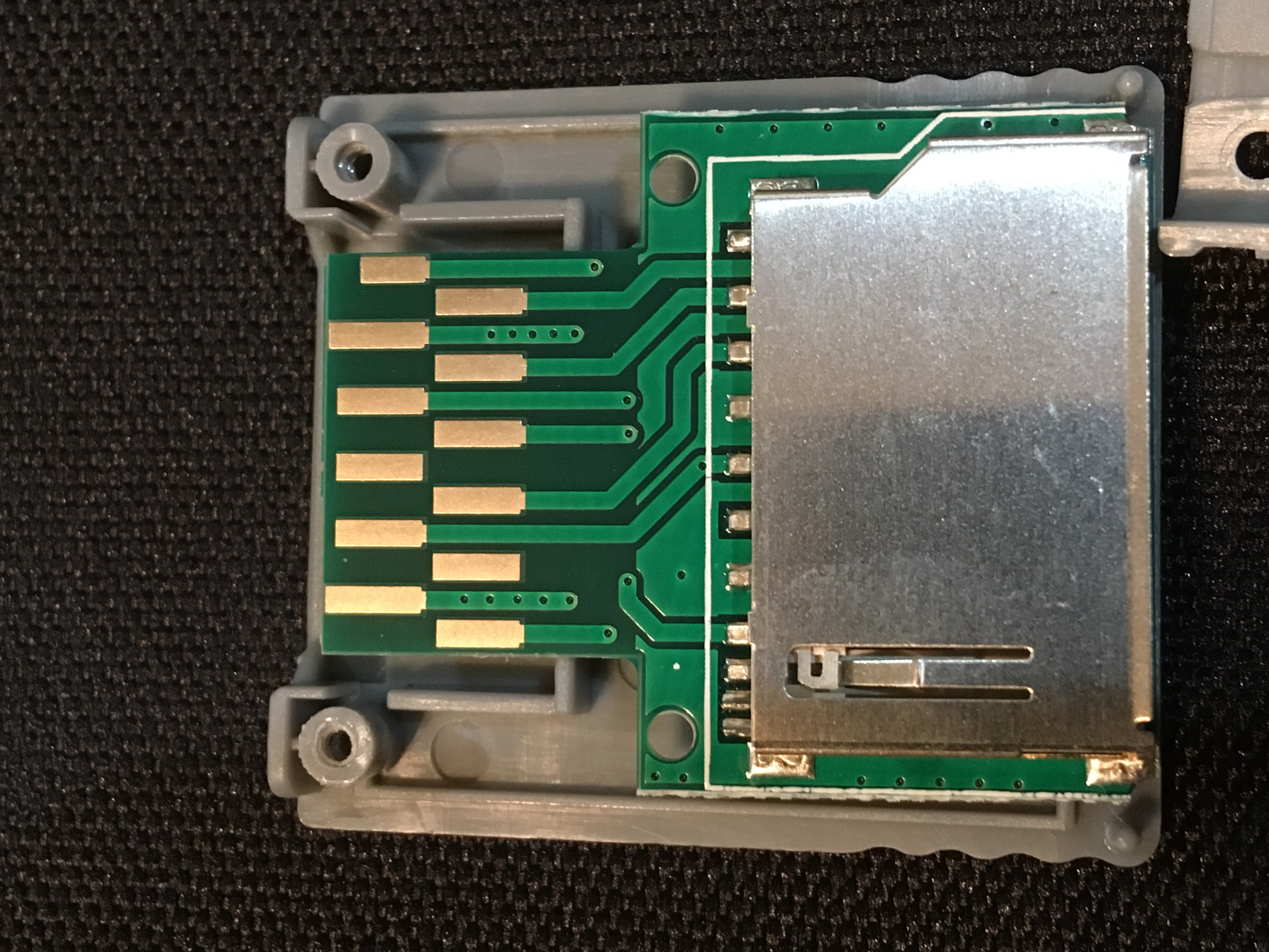

However, I can't seem to get Swiss to work through the Wii's homebrew. I can see the booter application for Wii consoles in the Homebrew Channel list but when I use it, all that happens is my Wii just reboots to the Wii menu, it doesn't boot into the Swiss menu or anything. All guides I have found on it... They are just so broken and confusing I can't make heads or tales of what is going on in them or how I can adapt what I currently have setup via Modern Vintage Gamer's Guide to get Swiss working as well.
I thought maybe I need to have a special SD to Gamecube memory card adapter with Swiss loaded on that... So I bought this...
https://www.amazon.com/gp/product/B06Y1 ... UTF8&psc=1
It's a cheap Chinese knock off thing but, upon investigating the PCB after it arrived... I have noticed that it doesn't seem to follow the same wiring diagram posted here, or at least it doesn't seem like it maybe I am wrong. I am not an engineer nor have I started going to school for that...
https://www.gc-forever.com/wiki/index.php?title=SDGecko
So, I am quite worried about using this item. I don't want to damage my Wii as it is currently my only saving grace in today's loot box filled gaming era. I thought I would come on here, gc-forever forum, to ask you guys. Are my worries are justified or I am just being paranoid with this Wii SD memory card thing? If needed I can make my own, I was just trying to save myself some time and effort by finding one premade for that purpose.

So, I tried using that Chinese knock off SD to Gamecube memory card.... I don't recommend it.
It damaged my ports T_T and also did quite a bit of damage to the SD pins.
DO NOT USE OR PURCHASE THIS...
Instead... Buy this...
https://www.codejunkies.com/Products/SD ... 0580V.aspx
and follow these instructions...
https://www.reddit.com/r/Gamecube/comme ... ew_set_up/
Sad day... Now I have to figure out how to fix the damaged ports. Sigh...

emu_kidid wrote: Fri Aug 30, 2019 7:51 am Yep that SD card adaptor is fine too.
It's not. Do not use it. Damaged my ports.

Exile wrote: Sat Aug 31, 2019 2:08 am
It's the adapter everyone uses. It's fine.

"So, I tried using that Chinese knock off SD to Gamecube memory card.... I don't recommend it.
DO NOT USE OR PURCHASE THIS..."
Just get a refund, mine is the exact same up to the packaging, and It never destroyed any of the four consoles I used it in (three GCs and one Wii)
"Sad day... Now I have to figure out how to fix the damaged ports. Sigh..."
Hope this is not too bad and can be fixed. However, I'm curious to see real pics of your adapter.

Little update: I got a pair of SDGeckos recently, and part of the board that is in the GC's connector inside is little wider than the recessed plastic part that makes a "nose" for it. They were hard to plug in and, may have damaged the GC if I wasn't aware enough, so I opened them and file the sides to fit the nose width, and they are now OK.
