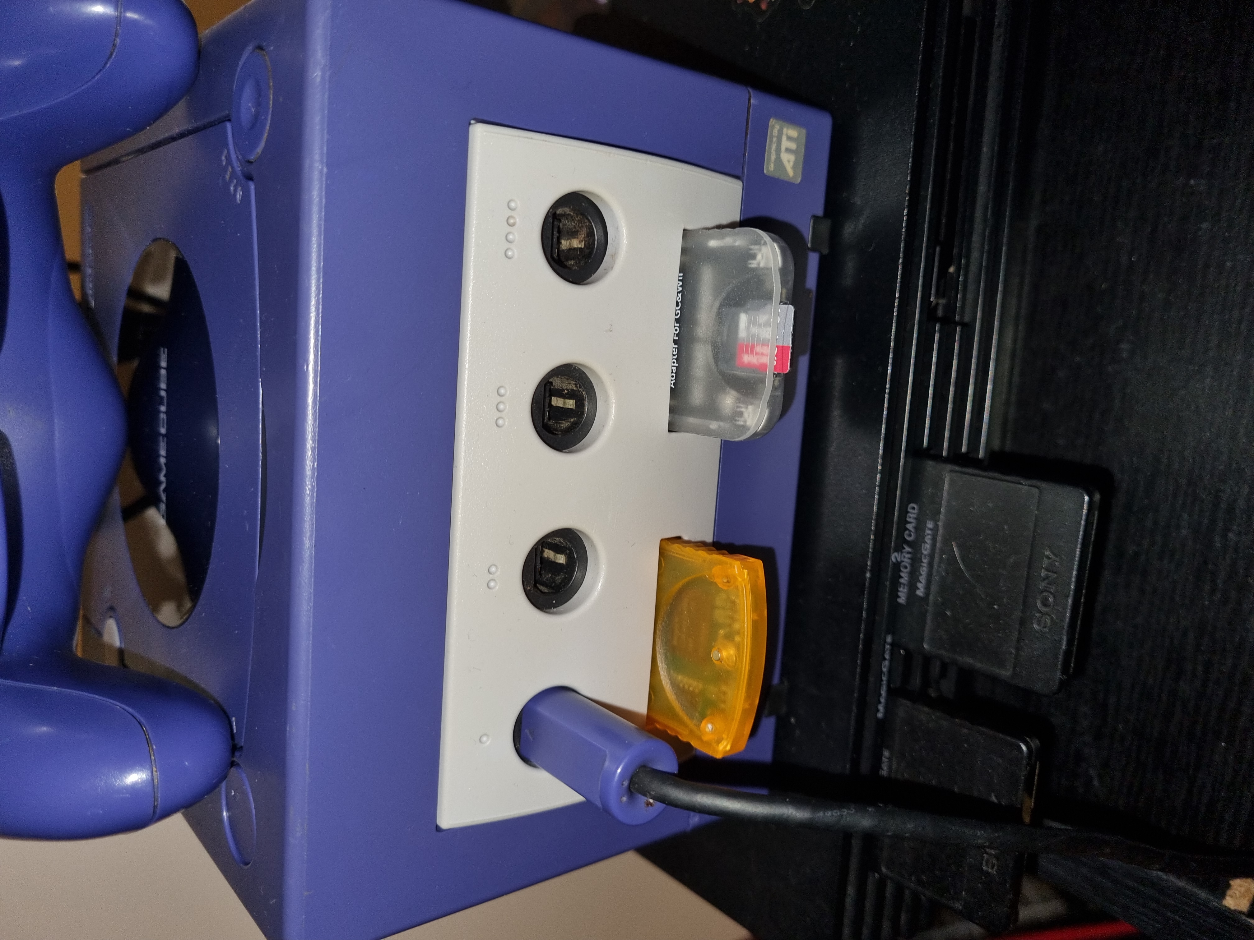

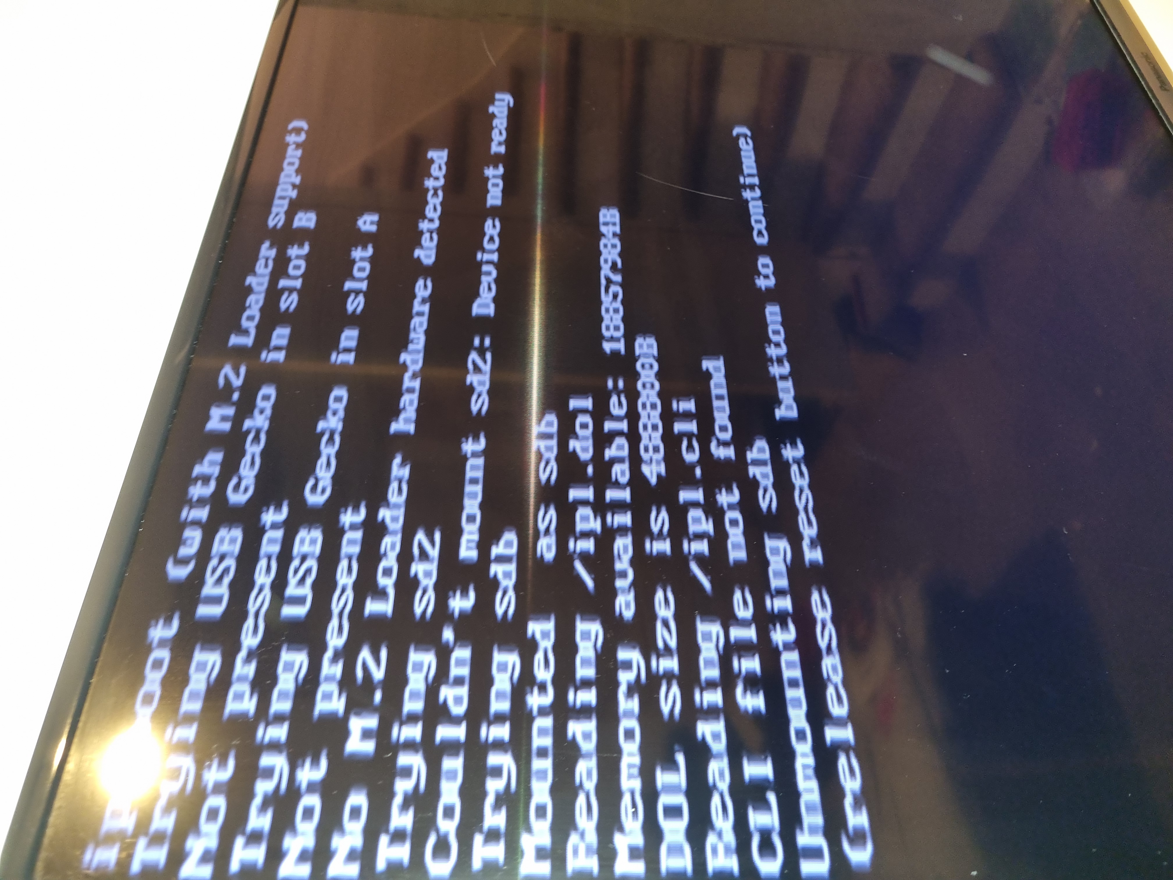

I have recently installed the picoboot mod chip into my gamecube and have it working but doesn't seem to work as it should. To start with it tells me that a gecko isn't present then loads from my gecko in slot b which makes booting an ipl really slow.
Does anyone know why it wouldn't locate my gecko to start with then load from it later?
Picoboot issues, gecko not located at first then loads swiss from gecko

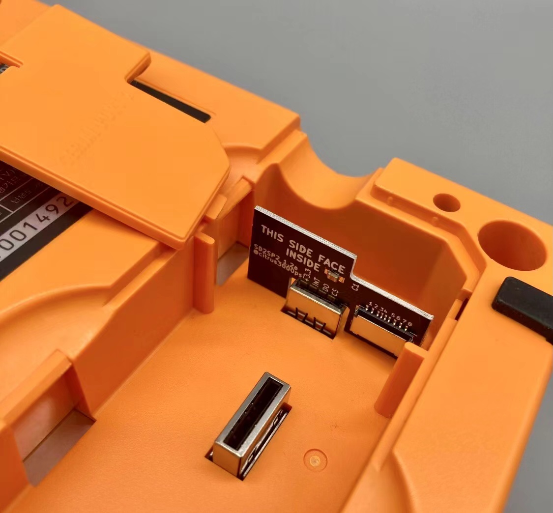

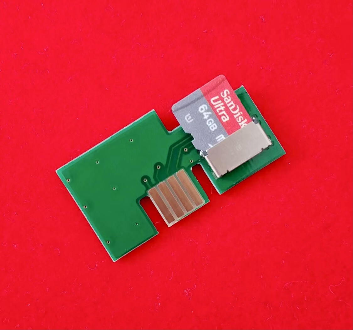

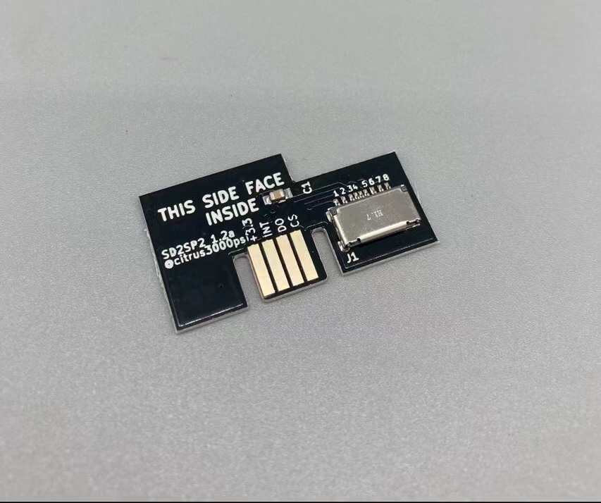

If your NGC is the first version (DOL-001) which has the serial port2 (SP2), you can try it with a sd2sp2 adapter.

I'm going to need more details to help you. How exactly is it slow? It should skip past every missing device pretty much instantly. Please describe exactly what it's doing, or even better post a video.
Re: Picoboot issues, gecko not located at first then loads swiss from gecko
Oh sorry I fixed the issue I was having seems like the v0.3 of picoboot doesn't like my console so instead of finding the ipl where it was it would skip most of them saying devices are not present then eventually boot the ipl (swiss) as a sdb( im not really sure what an sdb is) so I down graded to the v0.2 of the picoboot and now it instantly finds the sd memory card adapter and boots the ipl with no issues.
On another note I still can't get an sd2sp2 to work on my console. I would like it to work for it to be tucked away but I am able to play my backups so I'm not that fussed.
