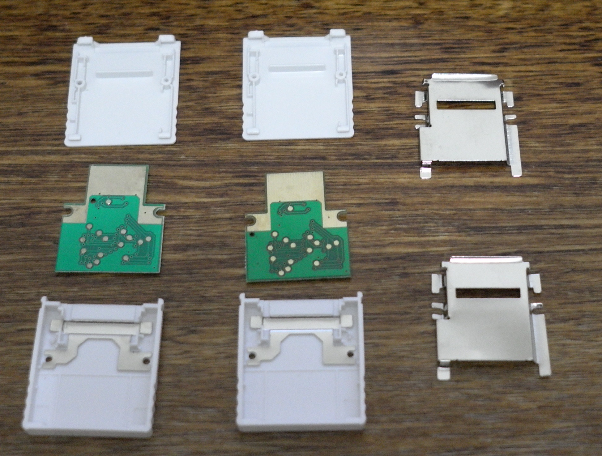

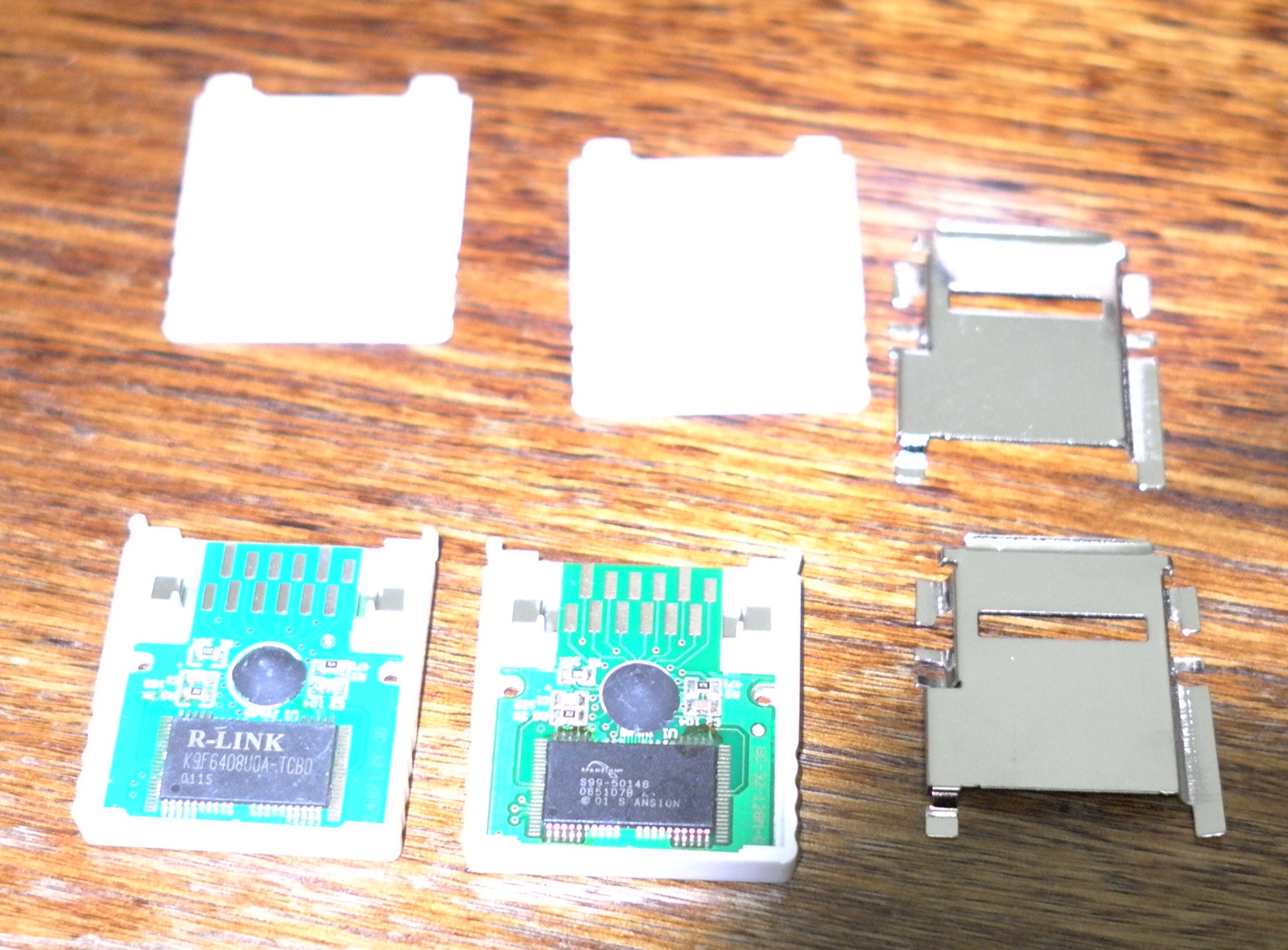

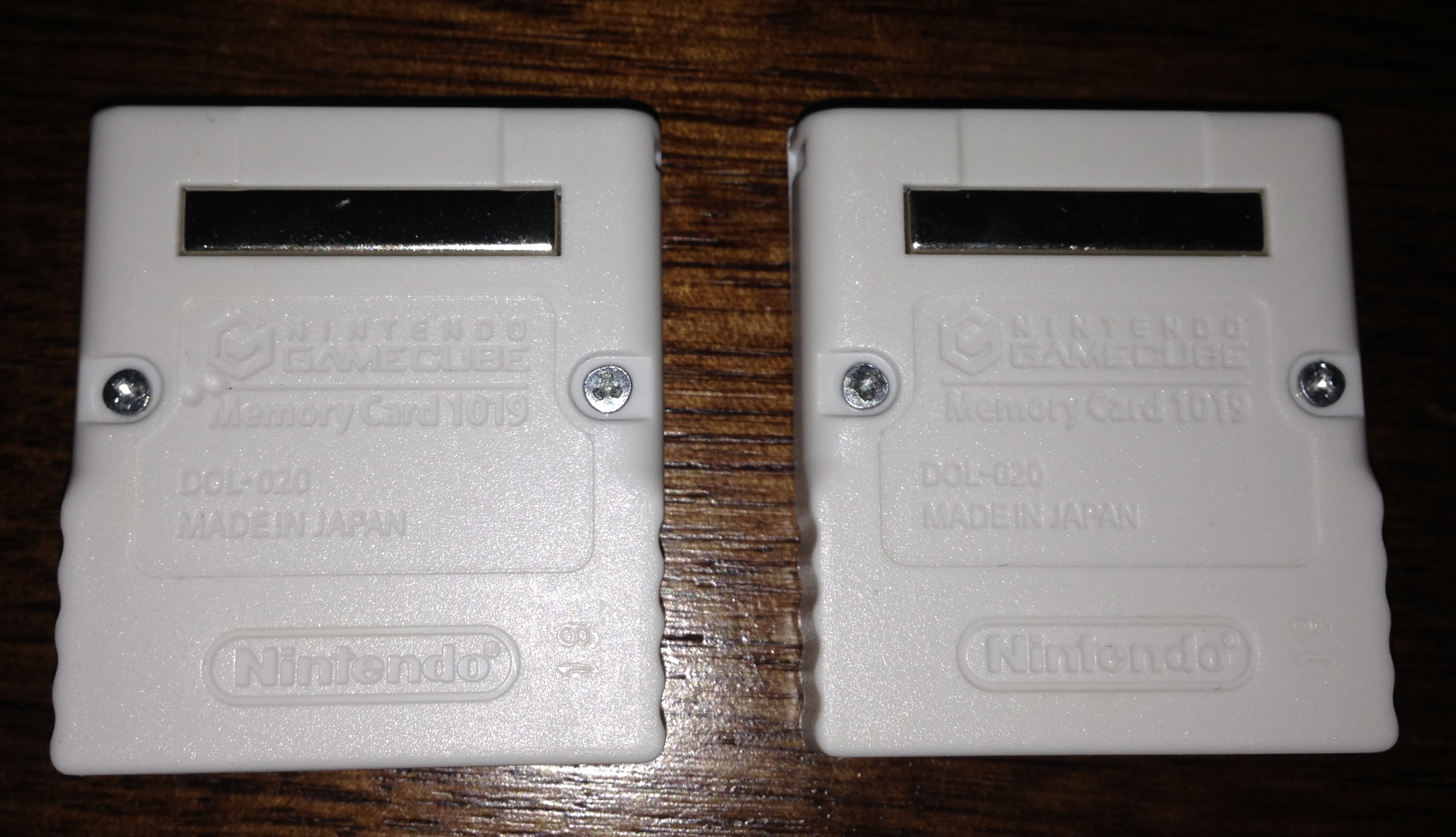

Post by SEGAdc » Sat Aug 16, 2014 4:10 pm

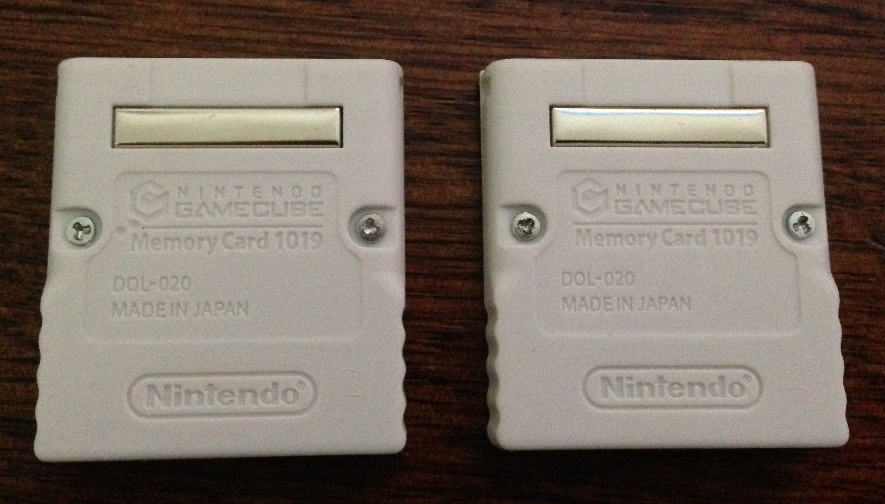

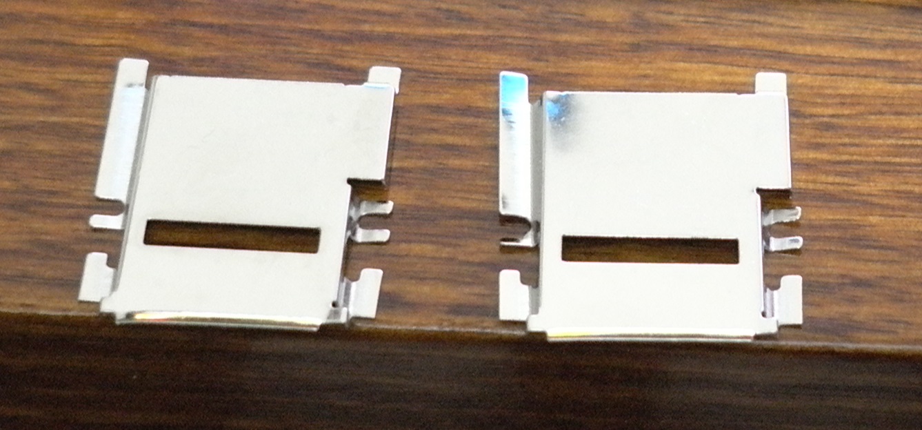

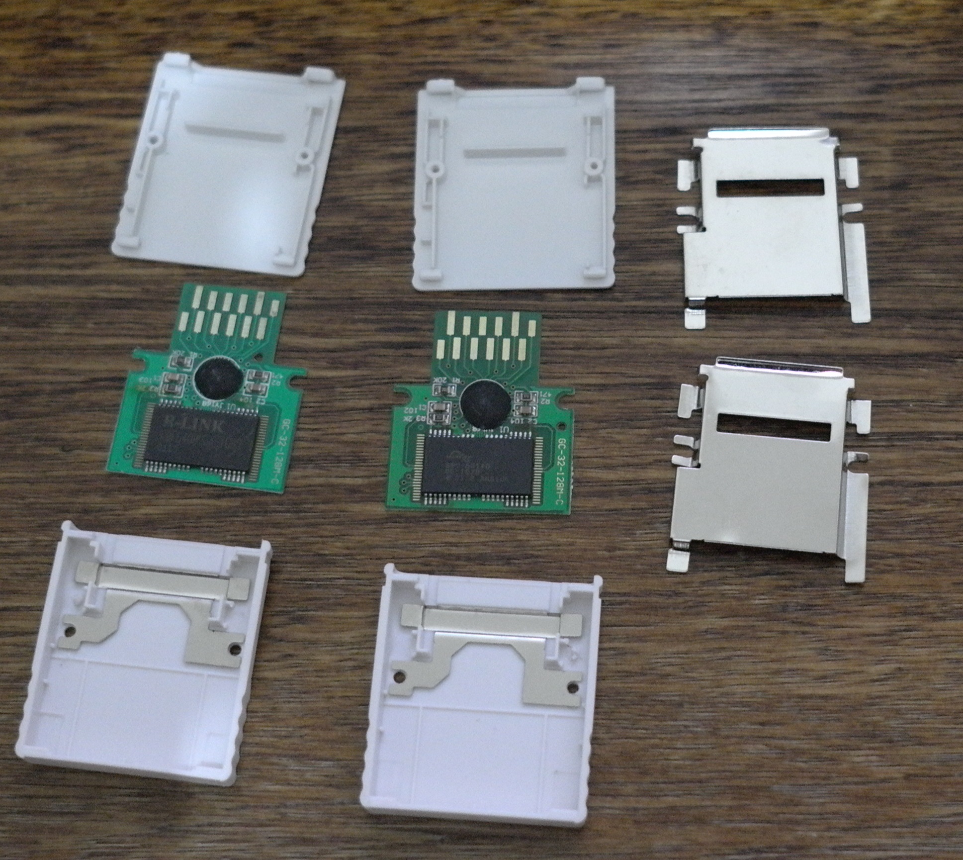

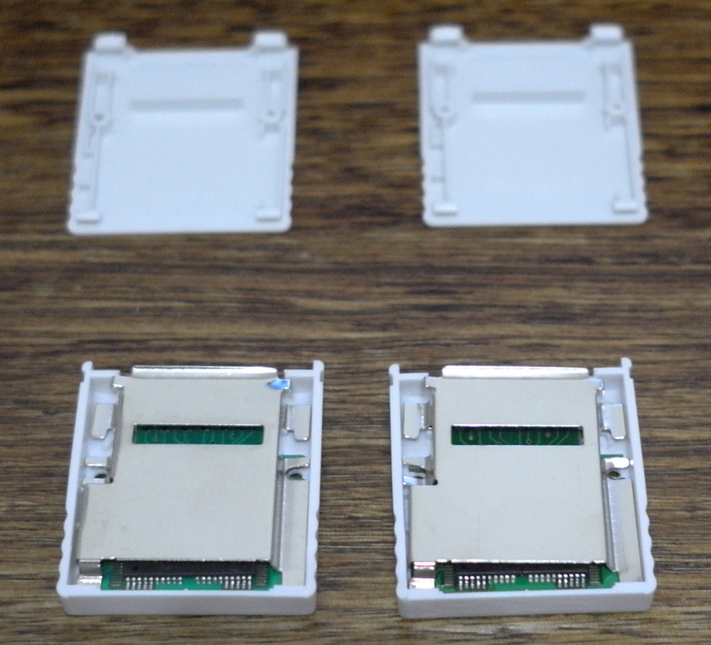

why is fake? see photo. I got 2 and they not even the same chip. lol Anyone who have a real genuine official Nintendo GameCube 1019 memory card. please open it up, take some photo and post it here. Thank you very much.

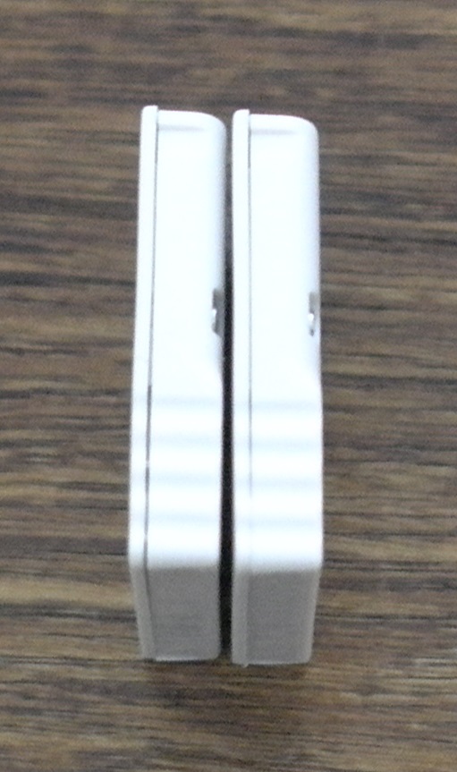

Post by SEGAdc » Sat Aug 16, 2014 4:12 pm

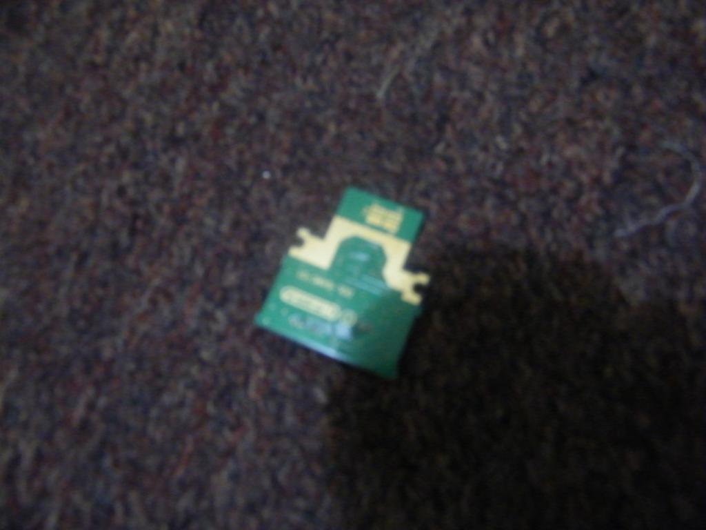

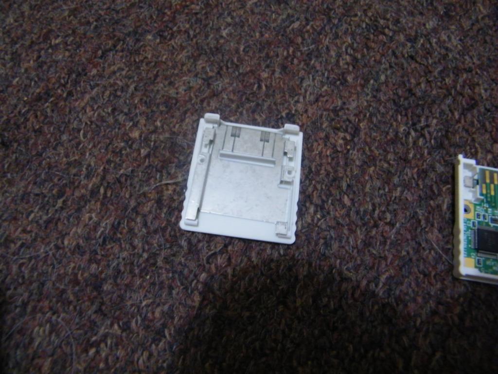

more photo. thanks for watching.

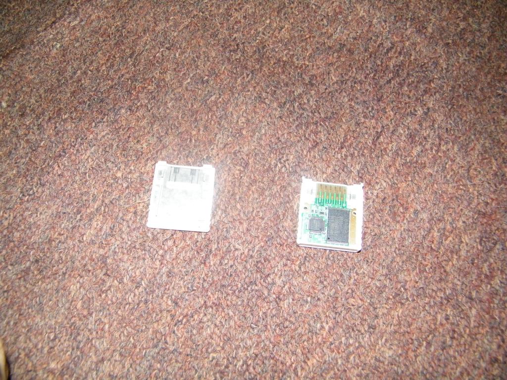

Post by SoraK05 » Sat Aug 16, 2014 10:08 pm
With the camera set to 10MP not sure why so blurry.

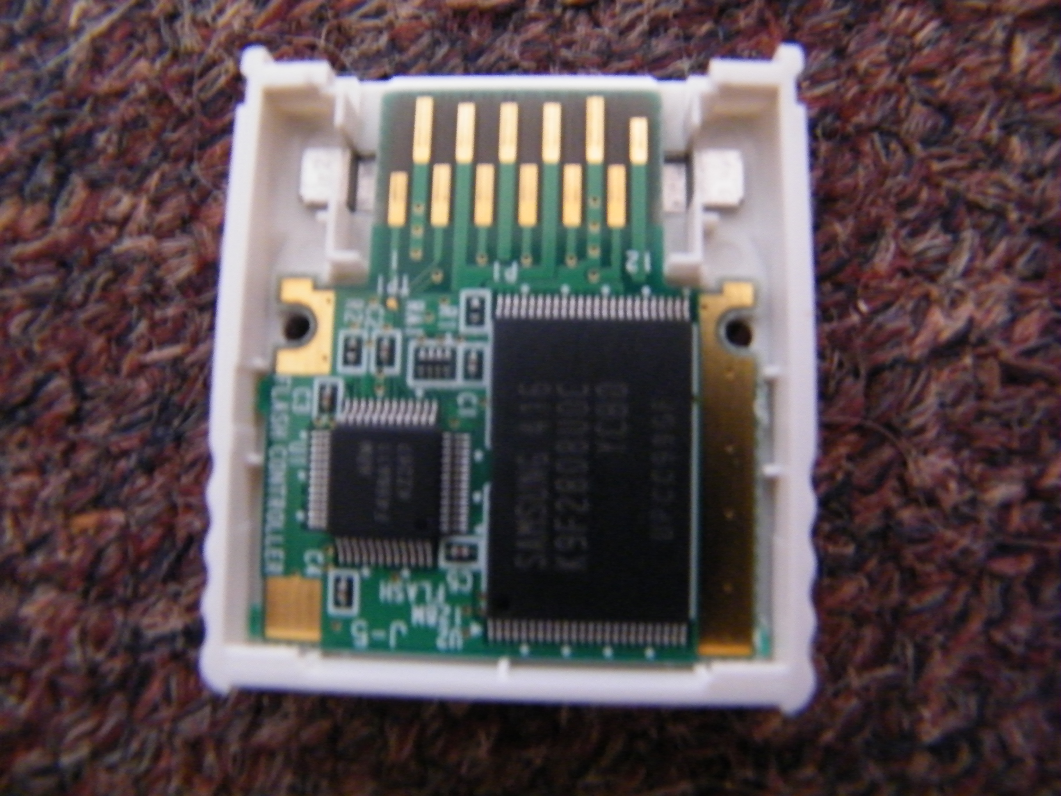

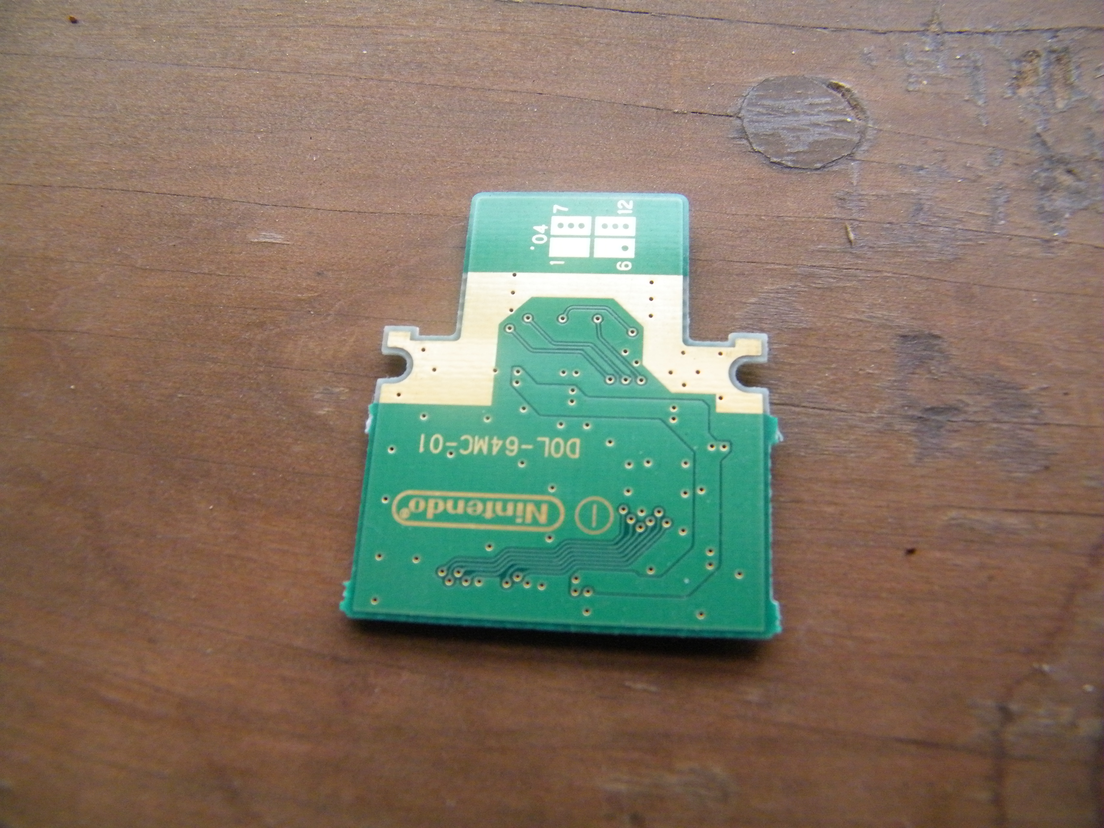

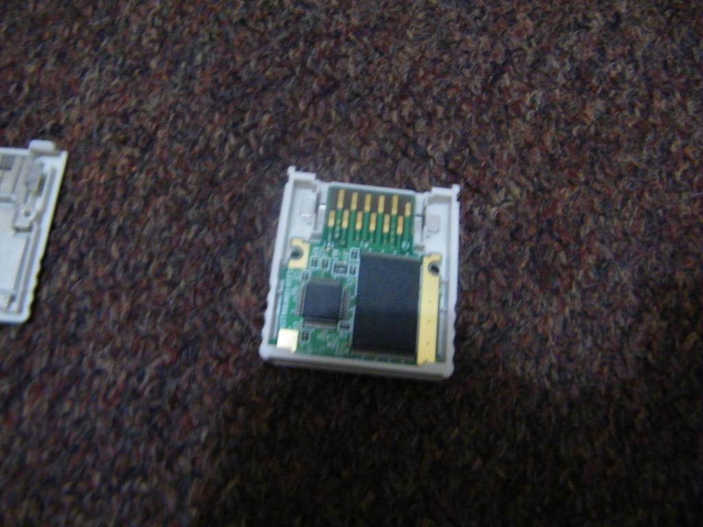

The chip pcb has 'Nintendo' and 'DOL-64MC-01' on it.
Where it plugs in it has 4 rectangles, top left one has one circle on the far left, top right one is blank, and the bottom two have 3 circles, where going clockwise and starting from top-left there is '6', '1', '7', '12', and on the right next to the top right and bottom right ones is '.04'.
On the other sides there is 'FLASH CONTROLLER' written on PCB, and there are 2 chips. The smaller chip has 'ARM' 'F49NA11' 'K2287' and the larger chip has 'SAMSUNG 416' 'K9F2808UOC' 'YCBO' 'UPCC99GF'.

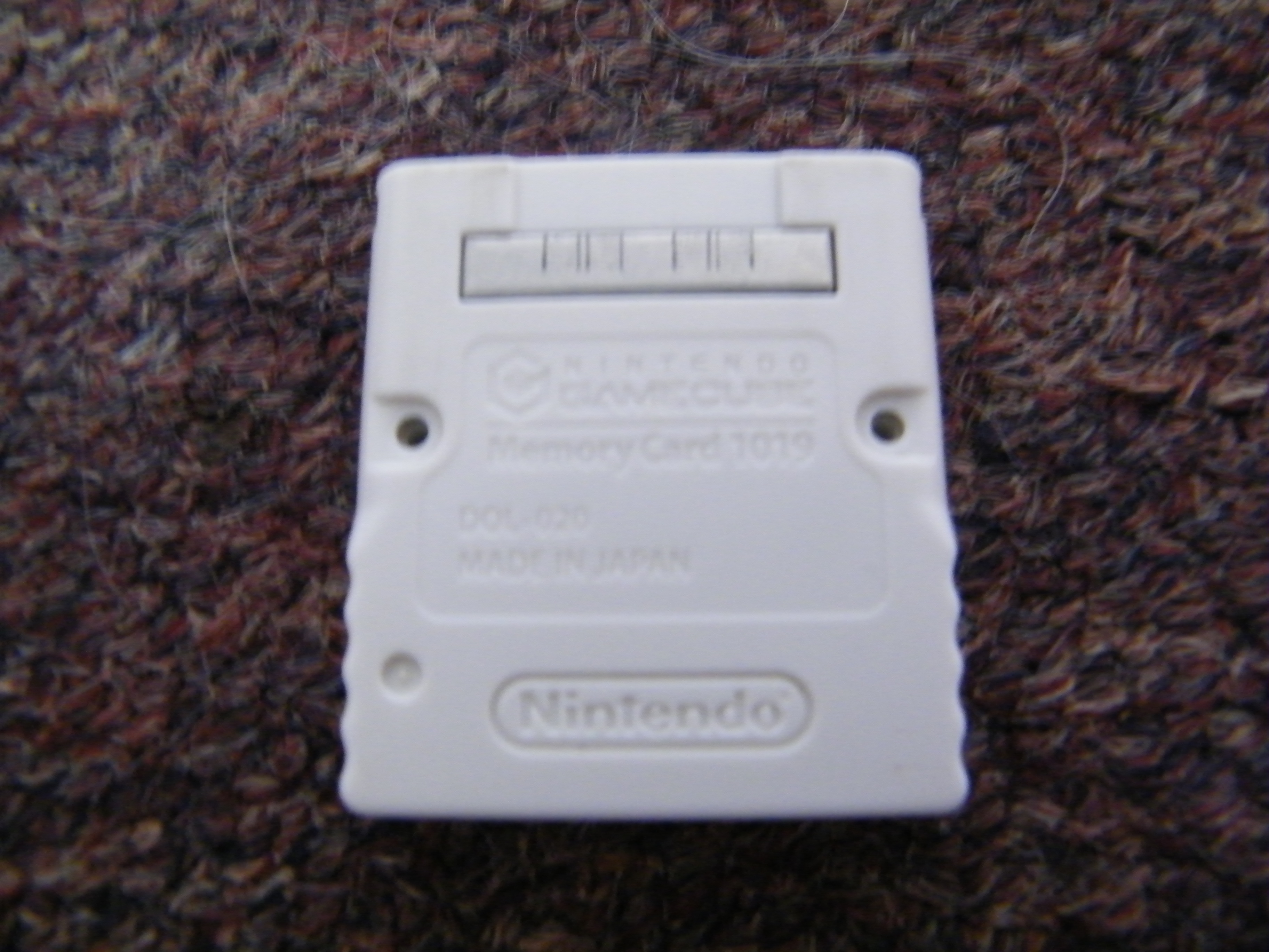

Frontside of mem card is a plastic up arrow at the top and a hollow area for a sticker, and 'NINTENDO GAMECUBE' at the bottom.
Backside of mem card plastic is 'NINTENDO GAMECUBE' 'Memory Card 1019' 'DOL-020' 'MADE IN JAPAN' 'NINTENDO'.
Photos are too big to attach and didn't allow for split 7z 001 filetype.

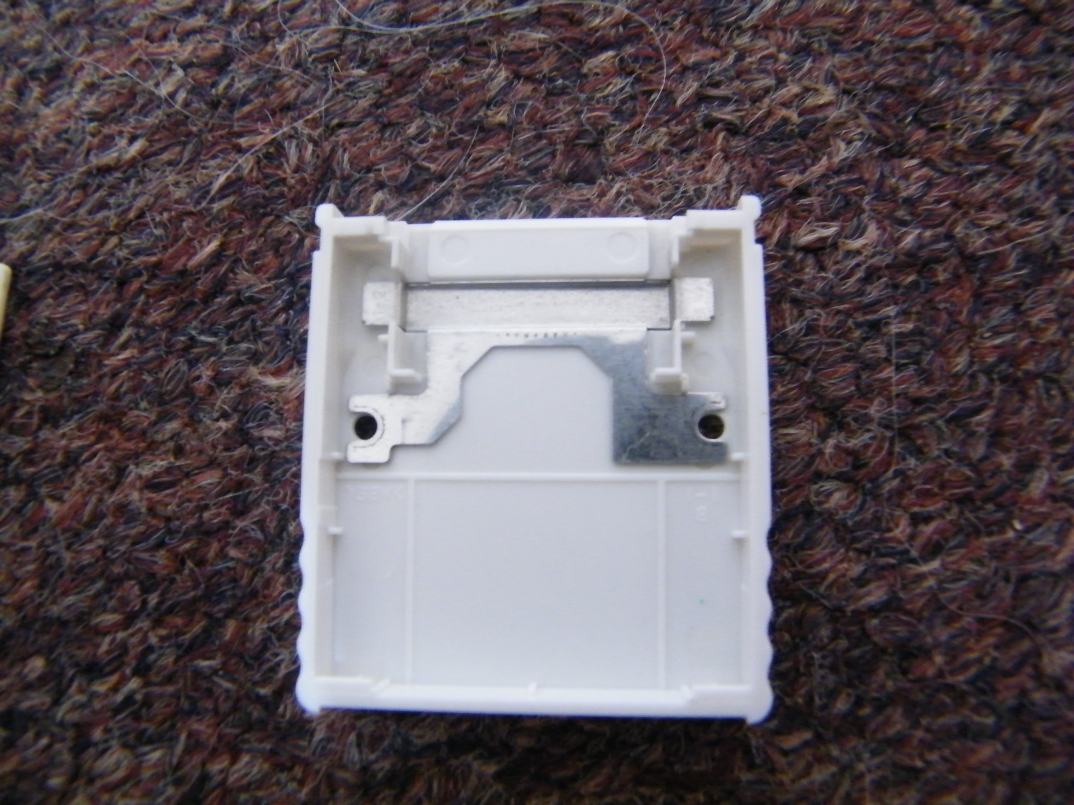

EDIT:
Here.

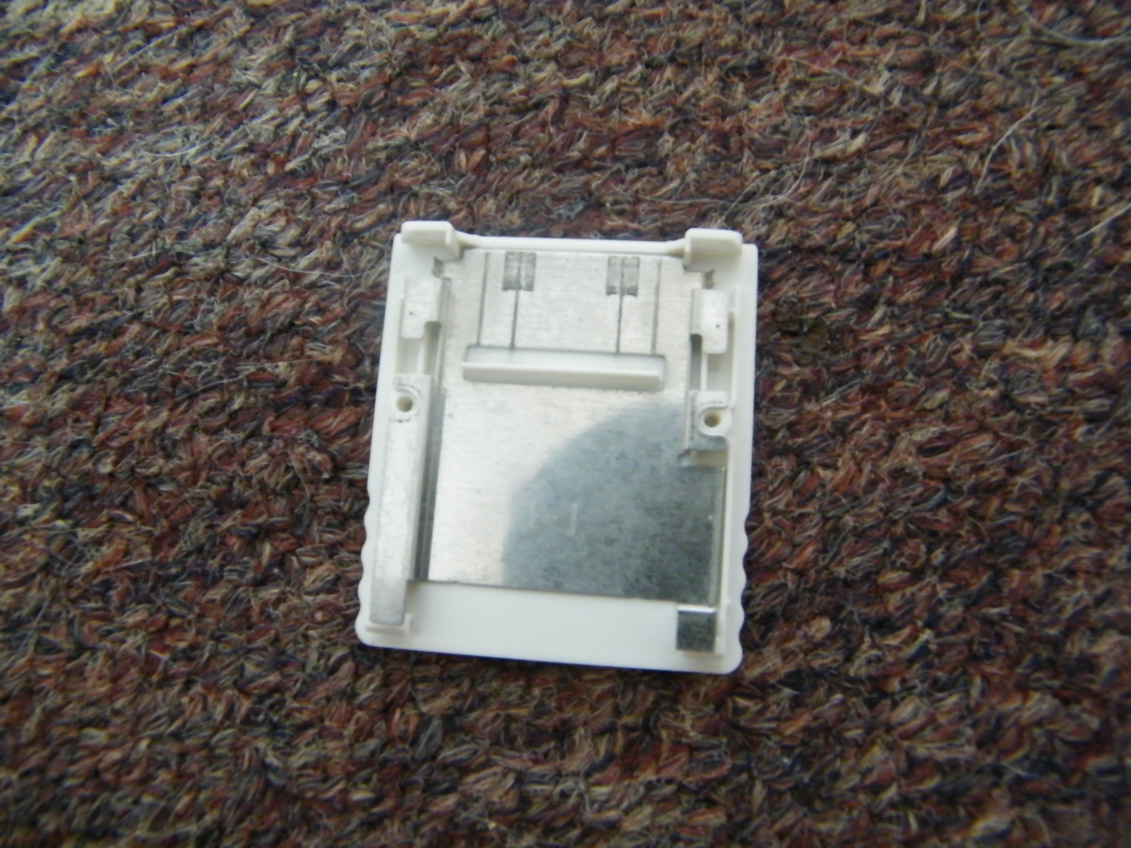

Memory Card Casing Back Inside (with out PCB)
(1.91 MiB) Not downloaded yet
Memory Card Casing Back Inside (with PCB)
(1.74 MiB) Not downloaded yet
Memory Card Casing Front Inside
(2.09 MiB) Not downloaded yet
(1.58 MiB) Not downloaded yet
(1.83 MiB) Not downloaded yet

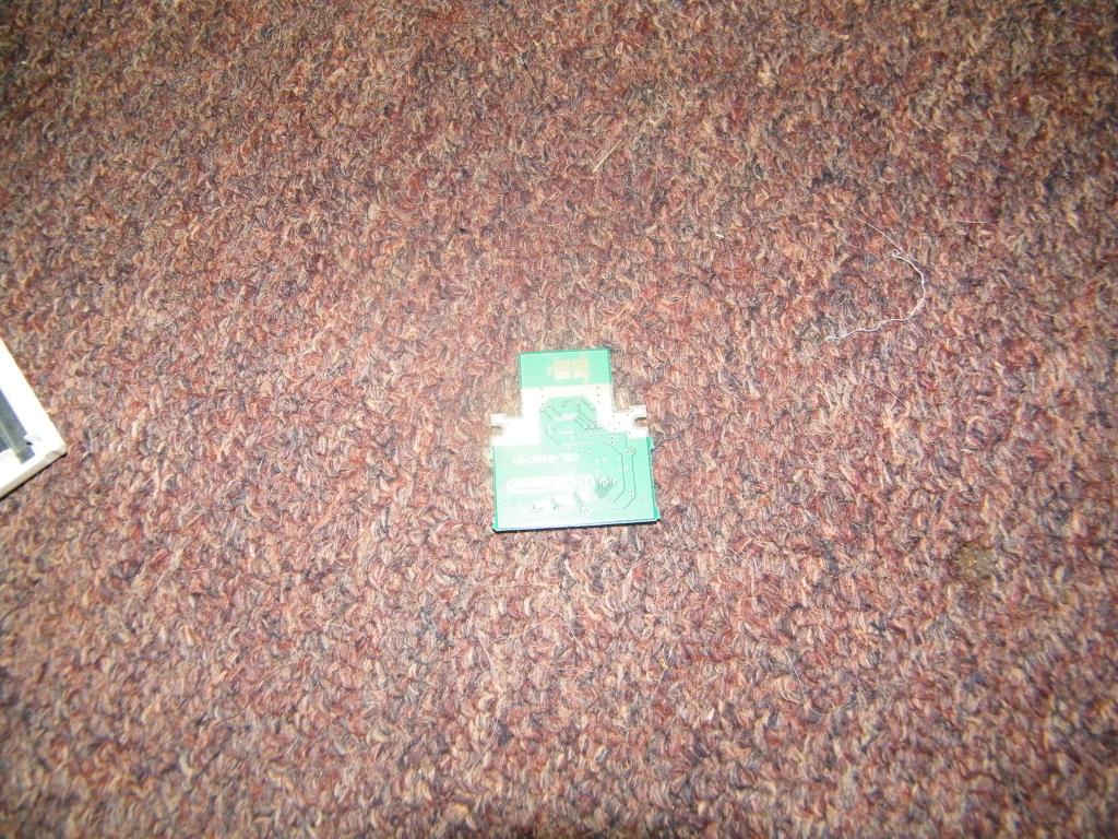

More
PCB Closeup Bottom
(2.38 MiB) Not downloaded yet
PCB Closeup Top
(2.24 MiB) Not downloaded yet
