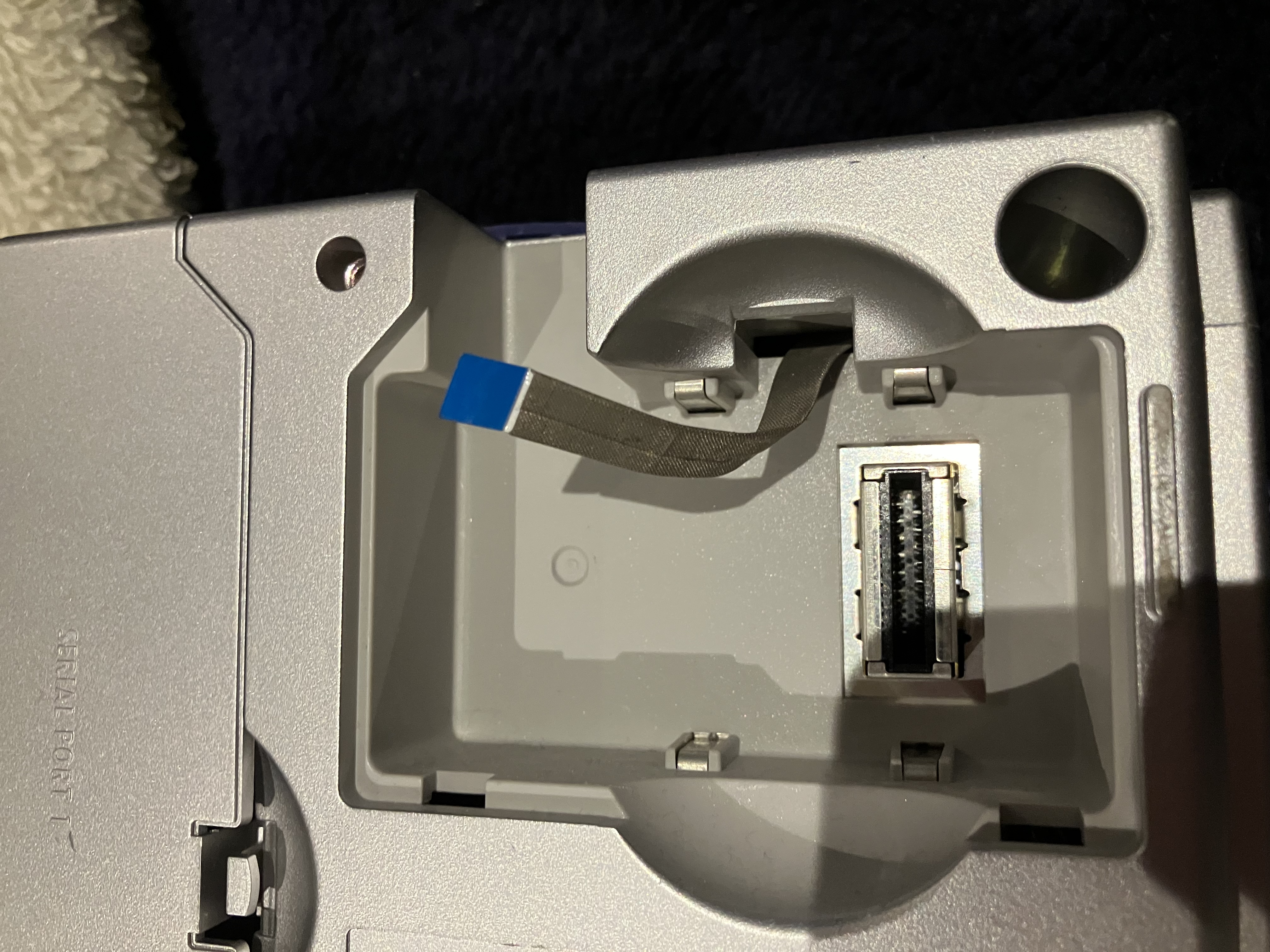

So after seeing this forum when I decided to collect 3 Qoob Pros these last few months, I thought I would remake the QOOB Pro usb board that some of you seem to have lost or damaged:
Was just a fun evening project to source parts and design. I did give the USB port some more bite with a copper fill. Accurate down to the mousebites where you break off USB board from main chip.
Tested t and it worked just fine under Windows 11. I personally use silversteel1's gekkoboot fork with MMCE support (FlipperMCE and GCMCE): https://github.com/silverstee1/gekkoboot-builds
If anyone wants, these are on pre-assembled on ebay with flex cable and international shipping from USA. Just search for Qoob Pro USB. Unknown if I will make more but I hope to soon put Gerbers for anyone to reprint as needed.
Gerbers and BOM will be here soon for free:
https://ko-fi.com/r3z3n/shop
Black is original QOOB PRO USB board. Purple are the reproductions.
My personal build with Retrogem, Qoob Pro, IcedCube shell with qoob pro usb mount molded in to back (I have the 3d Qoob Logo as well), GCMCE, Ninty BBA, and SD2SP2
