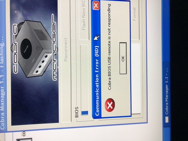

Post by sharkzor » Wed Oct 23, 2019 5:36 am
can someone please tell me if and how they connect to a viper(exterme) via usb?
I've tried winxp, win7 x64 and win7 x32 via vmware. only winxp managed to connect to the viper via the manager.
The viper goes into usb mode and the connection is made, but when i try to format the flash or upload a dol (swiss) it stops after 2secs and errors out.
Got the error ‘cobra usb bios not responding’

Post by sharkzor » Wed Oct 30, 2019 3:50 pm
sharkzor wrote: Wed Oct 23, 2019 5:36 am can someone please tell me if and how they connect to a viper(exterme) via usb?
Gave up. Didn’t work, even with a real windows xp machine.
Burned disc with dols and flash update. Viper 1.6 can be updated to 2.1 via the viper bios itself.
A viper extreme can hold swiss and compressed cleanrip dol :)
This method requires updating everytime via a new disc burn and those are hard to come by. Does someone have a launcher dol so it launches directly from sd? Something like the channel forwarders from the wii

Hey everyone, for those who needs to connect the usb adaptor from Viper Extreme, i went to a solution.
Viper Extreme USB adaptor was built over a FTDI USB to Serial chip. Unfortunately, Viper creator changed the device IDs, so if you try to install the latest drivers from FTDI site, Windows won't recognize the driver and it won't install.
What i did was download FTDI USB to Serial drivers, extracted and edited the ftdibus.inf to add the references to the Viper adaptor.
So, just go down to these sections and add this lines:
[FtdiHw]
%USB\VID_0403&PID_CC5C.DeviceDesc%=FtdiBus.NT,USB\VID_0403&PID_CC5C
%USB\VID_0403&PID_CC5C&REV_0400.DeviceDesc%=FtdiBus.NT,USB\VID_0403&PID_CC5C&REV_0400
[FtdiHw.NTamd64]
%USB\VID_0403&PID_CC5C.DeviceDesc%=FtdiBus.NTamd64,USB\VID_0403&PID_CC5C
%USB\VID_0403&PID_CC5C&REV_0400.DeviceDesc%=FtdiBus.NTamd64,USB\VID_0403&PID_CC5C&REV_0400
[Strings]
USB\VID_0403&PID_CC5C.DeviceDesc="Viper USB Adapter"
USB\VID_0403&PID_CC5C&REV_0400.DeviceDesc="Viper USB Adapter"
After that, windows won't accept to install this driver pack, since the hash won't match, so, you'll need to reboot your pc and allow to install unsigned drivers. After that, you can go to device manger, find the Viper USB adapter, update drivers, look for drivers on pc.
It worked like a charm, i just installed IPLBoot using Cobra Manager.

Now it was on Cobra 1.6 and through some experimentation I have updated it to 2.1.
All good.
I also have an sp2sd and I boot my Swiss disk and away she goes. However I think I'm correct in that Swiss itself can be loaded on the Viper?
Would anyone help this lost man please in how I do this? I can't work out what file I need from the swiss downloads nor how to get it onto the viper chip.
I'm willing to accept I've got it all wrong.
Feel free to mock me if I've missed something blindingly obvious though.
Thank you all.
Please stay safe and well in these 'interesting times' we currently live in.

Post by emu_kidid » Mon Apr 20, 2020 11:25 pm
skel28 wrote: Thu Apr 09, 2020 5:10 pm I also have an sp2sd and I boot my Swiss disk and away she goes. However I think I'm correct in that Swiss itself can be loaded on the Viper?
Swiss won't fit, but you can use iplboot as a replacement BIOS on the ViperGC and it will attempt to load a DOL from a SD card on startup instead. I believe you can write .vgc files via DVD-R onto the viper if you don't have the programmer or a parallel port. Here it is: https://github.com/redolution/iplboot/releases
There's a copy floating around here with SP2SD support, try to find it in other threads.
