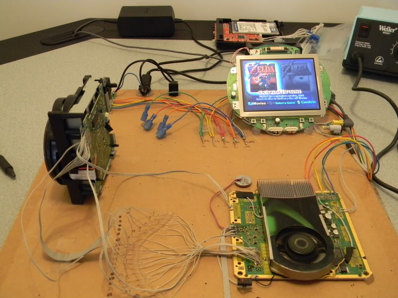

Finally got my new workspace all setup and my project area all cleaned up and better arranged for testing. yay! Figured since I'm being thorough now and testing everything to make sure its working correctly I hooked up a regular GC disc drive to my project motherboard and voila:
Now that I knew everything was working I proceeded to hook up the sundriver again and unfortunately I still get the same results as before. I'm pretty sure now that I've seen the sundriver actually working in the Wii that when its hooked to my cube its just not initializing properly (not getting some data signals it expects or the right data signals). When hooked to the Wii on boot the blue LED comes on for 3-4 seconds then flashes red for a split second and then shuts off completely. The only time I saw the LED light after that point was when it was reading from the disc while playing a game and then it flashes/flickers red.
At this point there could be many different reasons this is not working and I'll explain where I'm going to go with this from here.
Firstly I will point out that this guy: http://forums.benheck.com/viewtopic.php ... c&start=15 EntertheHatrix (even though seemingly coming across as a douchebag) claims to have hooked up a Wii DVD drive to the gamecube and had it working but supplied no proof of the matter. I will also point out that he was well informed enough to know that the pinouts of both consoles closely match each other (also note that the wii pinout is difficult if not impossible to find, if not for emukidid supplying it to me I would still be in the dark). Is he lying? I'm not sure. But it does give me a little bit of hope.
I'm wondering emu, if the guy that supplied you the first Wii pinout or even the WODE guys would be willing to share a bit more information with us? Namely what data certain pins are expecting when the Wii boots up (mostly the pins we are leaving unhooked 32-29 and 23 on the Wii side). We already know exactly what the GC expects when it boots up because it is detailed here: http://wiki.nintendo-scene.com/Gamecube_DVD_Protocol This tells us exactly what the GC is looking for before it can start reading data from the disc. I wouldn't ask and I will be very willing to do the work myself if it comes to it but its gonna be a while before I can invest in even a cheap logic analyzer. Possibly a month or more.
For now I think what I'm going to do is try to get ahold of a 2nd Wii for testing purposes so I dont have to keep taking mine apart and pissing off my kids and wife. Then I'm going to try hooking up the Wii DVD drive to the GC and see if I get any different results (hopefully the Wii DVD drive is as forgiving of error as the sundriver has been). There is always the possibility that our problem lies in the way in which the sundriver emulates the Wii DVD drive.
Also I will be mucking around a bit with the the 8 bidirectional lines (DID0-7) as I stated before it occurred to me that these data lines while labeled the same in our pinouts might not exactly correspond to each other perfectly between the systems, i.e. DID0 on the GC may actually be DID7 on the Wii. There are literally thousands of combinations in which this could work... hopefully I'll know a bit more after I acquire another Wii to test on (hoping my parents wont object to me stealing theirs for a while as they rarely use it).

Wow, impressive workspace. Very neat.
You might want to contact twbinc over at http://debugmo.de/ He might be able to help answer your question as he seems to have a lot of hardware/software experience.
What is your background? What you're doing is pretty impressive for someone who doesn't have hardware experience if I recall correctly.

I didn't mean for that statement to come across the wrong way. I have no idea what kind of person enterthehatrix really is. I know how things go on internet forums so I don't judge anyone. If you read the whole posting on benheck you would understand.liquitt wrote:first i'd like to point out that EnterTheHatrix is not a douchebag. he's a really nice guy. no idea what he posted on benheck though
You will laugh when I tell you that I'm a process engineering technician for a pharmaceutical company... Not my dream job but after 11 years I have enough experience to be confident that I'm pretty good at what I do and it pays pretty well also. I went to college for Computer Aided Product and Systems Design (CAD/CAM) at a technical school in my state. While in high school and as summer work while in college I worked at a engineering firm as a draftsman. Long before I finished schooling I had decided that it wasn't really the type of work I wanted to do. I've always been into electronics and computers and just generally try to be knowledgeable about how things work. As a kind of side profession I fix computers and do console modding for people I know... or people that know people I know... me in a nutshellgtmtnbiker wrote: What is your background? What you're doing is pretty impressive for someone who doesn't have hardware experience if I recall correctly.
Ashen, unfortunately the guy who gave me the Wii pinout hasn't been around much since I got it, but I can try to get some more info. I'd suspect the Data lines D0-D7 should be in the same order still, but then again anything is possible.. I'm going to give it a try at wiring it up later this week, but I'll start with the earliest diagram we have and go from there.
Nice setup btw, I'll have to post mine when it's back in shape.. had to pack it up because we've got some visitors staying over :p
thx and thx! I finally got tired of moving all my stuff around everyday so I laid claim to a room in our house that doesn't get used much and setup shop there. you guys all say how neat it looks but its just cause you can't see the mess all around the outside of that pic.
