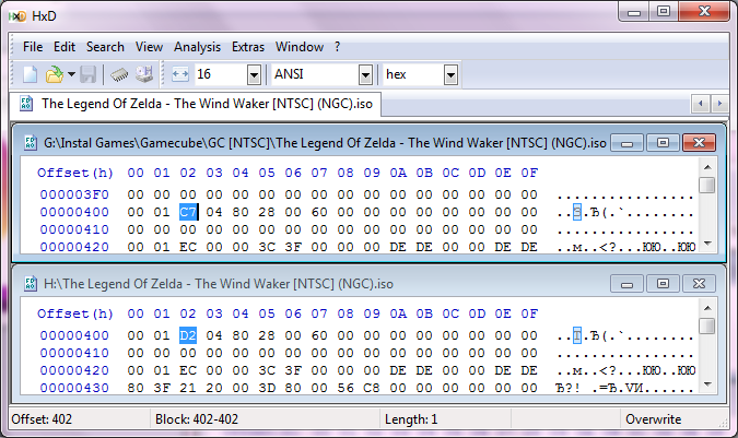

TALANTO
Posts: 43
Joined: Sun Jun 01, 2014 10:41 am
Re: Swiss Nightly Build
Post by TALANTO » Sun Jun 29, 2014 12:41 pm
emu_kidid wrote:Try your 2GB card with CLEAN ISOs after a fresh format, 1 ISO, not compressed per time, does it work fine?
I told you non compressed ISOs don't work. Both versions 174 and 261 give me "Invalid or Corrupt File!"
Zelda WW - "Invalid or Corrupt File!"
Mario Kart- "Invalid or Corrupt File!"
Super Smash Bros. - "Invalid or Corrupt File!"
Can you tell me other apps for compressing?
Edit:
That's interesting Need for Speed Underground didn't show me "Invalid or Corupt File" (non compressed). But the same as before:
r261 - Pink screen for a moment, after that black screen.
r147 - Prepatching, Pink screen for a moment and the game starts. No issues + audio streaming. Like other racing games "in race map loading freezes".
Edit2:
How to fix "Invalid or Corrupt File!":
Swiss searches for this hex code "01 D2 04 80" but some of my isos are "01 C7 04 80" and it gives me the error.
I used hex editor to change the value and after that Zelda WW worked as before "black screen" but without "Ivalid or Corrupt File!" error.
You can fix the issue in some newer version of Swiss. I attached an image to see the address.
Edit3:
You need to compare multiple files because they are different, after compressing this things are fixed and because of this they worked before.
For example Mario kart is with different change:
00 01 D2 24 80 28 00 60 00 00 00 00 00 00 00 00
00 01 D2 04 80 28 00 60 00 00 00 00 00 00 00 00
And for Super Smash Bross:
00 01 B4 E4 80 28 00 60 00 00 00 00 00 00 00 00
FIX "Invalid or Corrupt File!"
(58.75 KiB) Not downloaded yet

TALANTO
Posts: 43
Post by TALANTO » Mon Jun 30, 2014 8:07 am
megalomaniac wrote: also do not test any iso with r174, then use the same iso to test later versions of swiss.
there are patches that get applied directly to the iso that cannot be undone, this changed in later versions of swiss..
once again, do not use r174, then using the same isos with later versions.
I already knew that and I mentioned it before:
TALANTO wrote: - Also if you are using prepatched iso from older revision (like r174) the game may not work.
megalomaniac wrote: have you performed an md5sum check of your clean isos to compare they are intact?
once again. md5sum, make sure you have a validated file because the titles you list work perfectly fine with swiss so there must be some other cause for the messages you are receiving..
Probably yesterday I gave you the wrong example, so I double checked the games.
A game which works........................................................00 01 D2 04 80 28 00 60
GM4P D9A2E9C73F4BE1A0456734445402D35D verified 00 01 D2 24 80 28 00 60 (Mario Kart)
GALP 5E118FC2D85350B7B092D0192BFB0F1A \verified 00 01 B4 E4 80 28 00 60 (Smash Bros)
GZLE D8E4D45AF2032A081A0F446384E9261B \verified 00 01 C7 04 80 28 00 60 (Zelda WW)
D43E 1E23AFC69BFF50A7D20F32C5B739DC06 .verified 00 01 C7 04 80 28 00 60 (ZELDA OCARINA)
Now I realized that it's not true that compressing the game changes the red values. But it's true that if I change the red values with the green one there isn't "Invalid or Corrupt File!" error and the game works (Mario Kart and Smash Bros only). The two Zelda games worked in both ways today.
The next games don't proof my words. They are compressed with DiskEX and work fine:
...........00 01 D2 04 80 28 00 60 (my string)
GTEE.. 00 01 D2 24 80 28 00 60
GM4E. 00 01 D2 24 80 28 00 60
GW5E. 00 01 C7 04 80 28 00 60
GRSE.. 00 01 C7 04 80 28 00 60
GCSP.. 00 00 00 00 00 00 00 00
GZLE.. 00 01 C7 04 80 28 00 60
At last if you are confused like me you can try with Mario Kart or Smash Bros (the PAL versions) and find it by yourself. I made my tests with my 2GB MicroSD because of my previous posts but I will repeat them with my 8GB MicroSD.
Edit:
I tested it with my 8GB memory card (with MK and SSB) and it was the same, but from the second time after formatting the card.
First time the game ran (without any changes, clean ISO) and froze on Nintendo logo. After that my SD card was messed up "Mario Kart Double Dash! [PAL] (NGC).iso" was "NFS MW.iso" and it was unable to read (see attached image). I repaired the memory card and opened the "NFS MW.iso" and it was the Mario Kart file with other name.
(47.64 KiB) Not downloaded yet

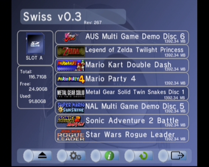

Post by megalomaniac » Sun Jul 06, 2014 6:44 pm
If you already have 1.0 autoboot firmware, all you need is .fzn but it does harm to use both fzn and fzn.fw
I noticed the capacity issue last night also. What size SD do you have? My 2gb cards display correctly from WKF slot but my 64GB does not
keropi
Posts: 167
Post by keropi » Sun Jul 06, 2014 6:58 pm
^ at the moment I am testing with a 16GB one
mautheus
Posts: 80
Location: Brazil
Post by mautheus » Sun Jul 06, 2014 8:47 pm
Hi megalomaniac, and megaloader? Any predictions upgrade?
Posts: 4971
Post by emu_kidid » Sun Jul 06, 2014 10:41 pm
I'll investigate the issue one day soon
Posts: 4971
Post by emu_kidid » Mon Jul 07, 2014 1:22 pm
Updated some minor visual stuff:
- current file highlighting is darker
- extensions hidden for most known file types
- SVN revision on the main screen now
(574.53 KiB) Not downloaded yet
