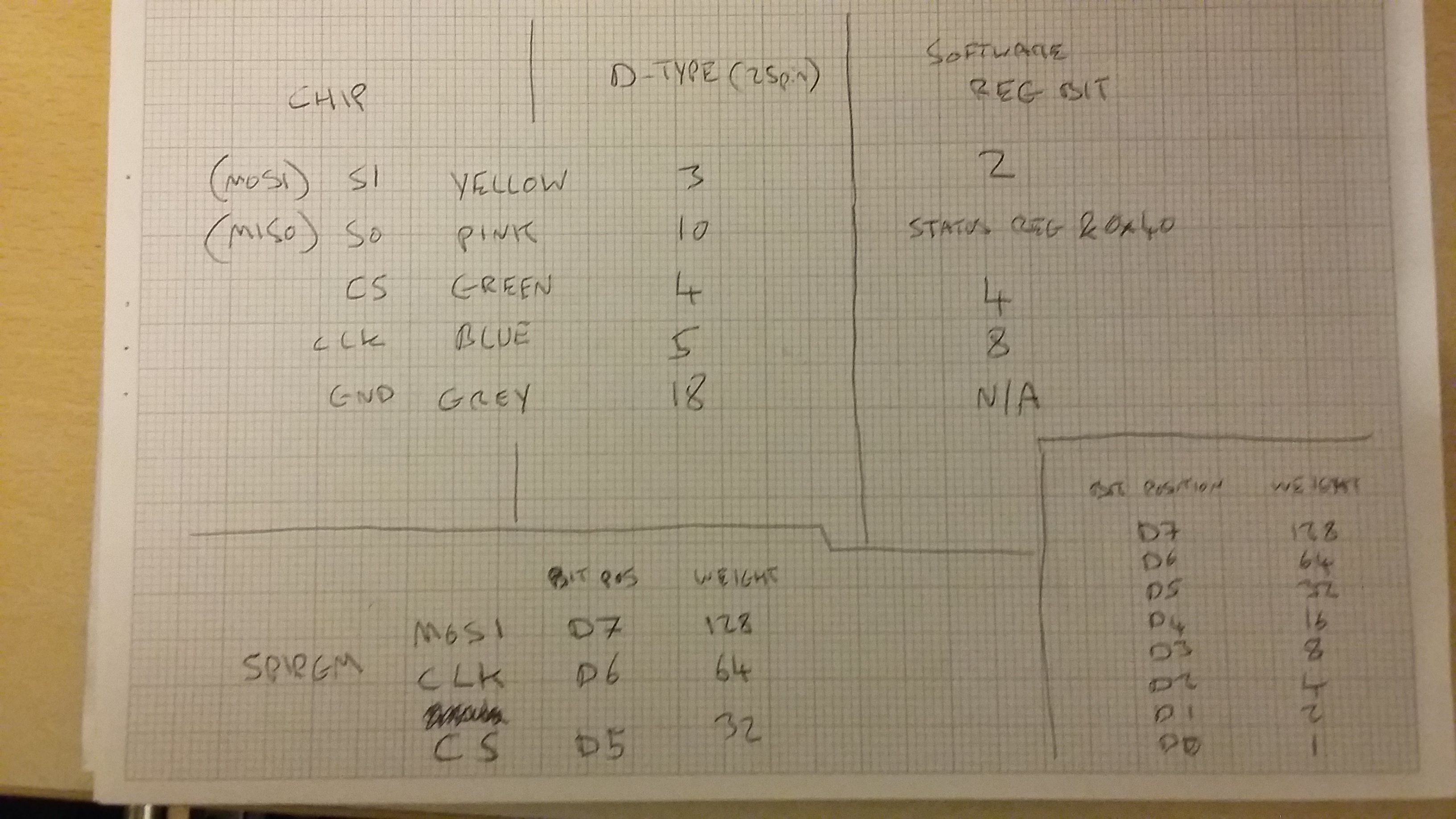

But your code and pin numbers on the picture you've given me don't match. Because of that I don't know if SPI_SI= 2 means MOSI on pin2, SPI_CS= 4 means CS on pin4, ... and where the pin count starts from (0 or 1).
Spoiler
Show
Edit: Maybe this answers my questions but please tell me if this is correct:
#define SPI_POWER                1
#define SPI_SI                   2	// 9
#define SPI_CS                   4	// 7
#define SPI_CLK                  8	// 8
Re: Shuriken Video
Posted: Fri Dec 11, 2015 11:09 pm
by happy_bunny
this is going to be hard to explain the D-TYPE pin numbers and the software reg numbers dont match.
D-TYPE pin1 is strobe (#define SPI_POWER) this should be called some better like #define SPI_SET_DATA_DIRECTION (it powers the output lines)
maybe this will help or confuse even more :-(
(1.7 MiB) Not downloaded yet
so the #defines should be
#define SPI_POWER 1 /* select output (0 is input) data direction */
#define SPI_SI 128 /* D7 (pin 9) */
#define SPI_CLK 64 /* D6 (pin 8) */
#define SPI_CS 32 /* D5 (pin 7) */
thanks for making me think haven't played with this stuff in years :-)
