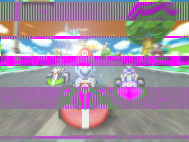

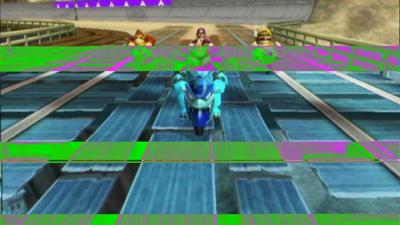

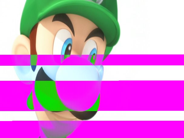

Everything is working fine on the Wii I was under the impression that everything worked on GameCube sorry for the confusion. Screenshots are a little messed up they have green lines going though them. But running live cheats on Mario kart Wii is very cool. I will try some texture hacks next and some more games.
Re: Shuriken USB (USB Gecko SE (clone))
Post by emu_kidid » Sun Mar 29, 2015 9:44 am
Lines through them? sounds like data loss?
happy_bunny
Posts: 106
Post by happy_bunny » Sun Mar 29, 2015 10:26 am
thats what I was thinking at first, but its odd the way the image is displayed in the gc / wii the embedded frame buffer stores the data in YCbCr format like this
Y = brightness
Cr = chrominance (color)
Cb = chrominance (color)
it looks like the Cr & Cb bytes for some of the lines are not getting across or being processed correctly but the Y is, which is odd. If you wanted a black and white image it would display correctly.

The embedded framebuffer never uses YCbCr format. Perhaps you are confusing it with the external framebuffer.
