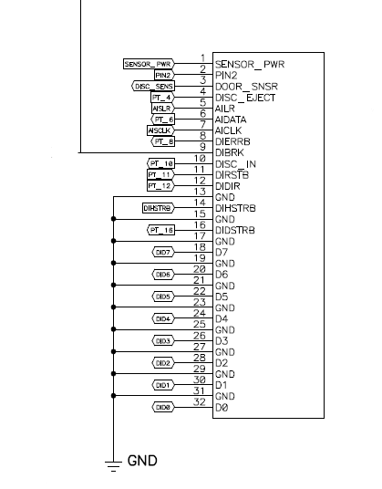

I finally got around to it!
- (33.98 KiB) Not downloaded yet
Awesome! Thx Emu.

So yea, I lied. Had some free time when I got home tonight so here we have it.
Pin:
1: 12v
2: 12v
3: gnd
4: gnd
5: 5v
6: 5v
7: gnd
8: gnd
9: 3.4v
10: 3.4v
11: gnd
12: gnd
Now I need my sundrivers to get here. Happy days ahead! ;P

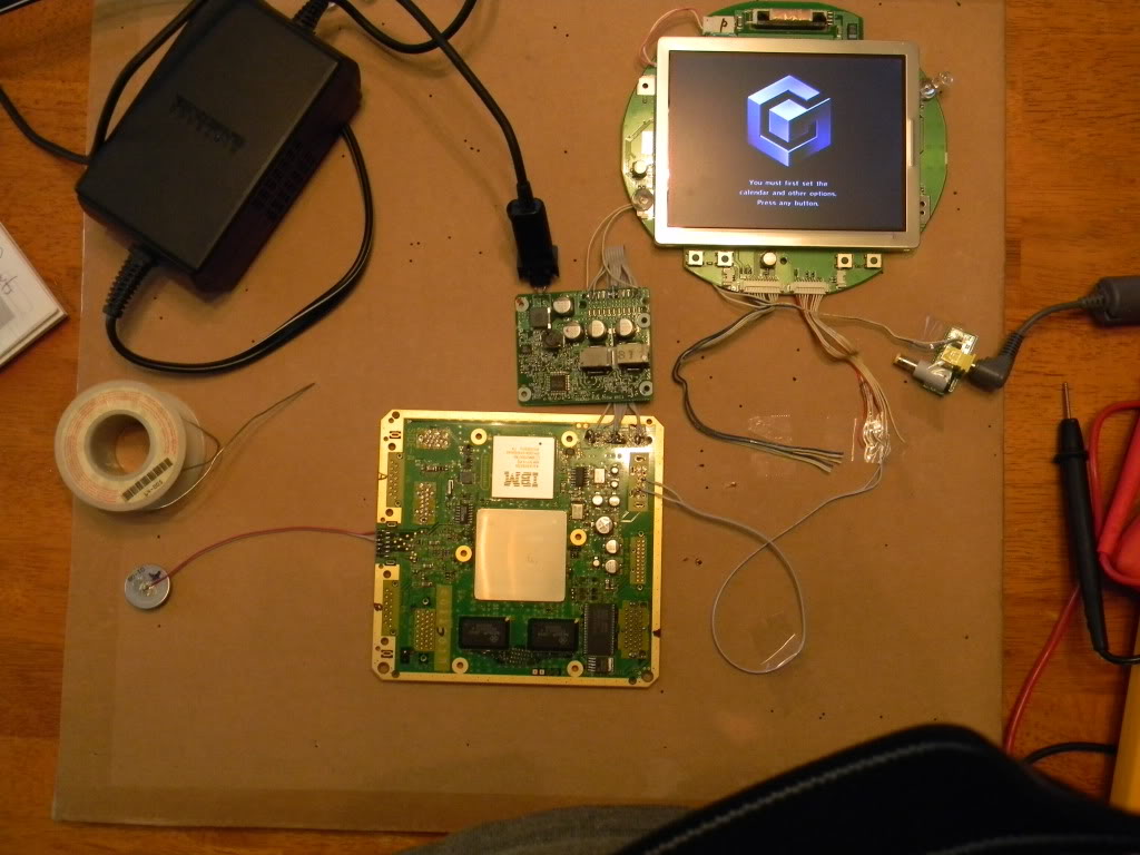

Little progress update with a pic:
Got power wired up and the screen wired temporarily with composite for testing. I just need to solder up a gamepad port quick for testing when I get my sundriver and I'll be all set. More to come soon hopefully

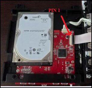

Emu, Here's to hoping you have not wired anything up yet...
In my infinite curiosity and boredom waiting for my sundrivers to get here I opened up my Wii again to do some testing. I found when doing so that the pinout you supplied is correct in its labeling order but reversed as to which pins are which
Pins 2,4,6 and 8 on the GC provide 5v Power.
Pins 10,16,18,20,22,24,26,28,30 and 32 on the GC are Ground and can be bridged together.
Pins 2,4,6,8,10,12,14,16,18 and 20 coming from the Wii (Sundriver) are ground and may be bridged together and connected to said GC ground above.
Pins 29-32 coming from the Wii (Sundriver) will not be connected (for now).
Pins 28(MONI) and 30(MONOUT) on GC are in actuality just ground (All "even" numbered pins on GC are either gnd or voltage. Pins 12(DICOVER) and 14(DIRSTB) confirmed to both output 3.3v from GC mainboard. All "odd" numbered pins seem to be inputs/outputs).
Testing of the pins on the Wii this is what I found: Pin22(DIRSTB) and Pin23(DISC_IN) Confirmed to output 3.3v (same as GC counterpart connections). Pin 32(SENSOR_PWR) and Pin 30(DOOR_SNSR) I have confirmed to output 3.3v constant from Wii Mainboard (I know we previously talked about leaving these disconnected, but I'm thinking now the sundriver will be looking for/need this voltage/signal?). Pin 31(formerly the unknown Pin2) is most definitely not a ground as I suspected. I got an output of 0v from this pin. I did not have anyone around to help me push the front panel buttons while I held my meter at the time but I believe now that this may be a reset signal when the front panel reset button is pressed. Pin 29(DISC_EJECT) also got 0v output, again I believe that when the front panel button is pressed it probably supplies a 3.3v signal to this pin.
For clarity this is Pin1 on the sundriver according to all previously stated here:
Thats it for now... back to waiting :/
