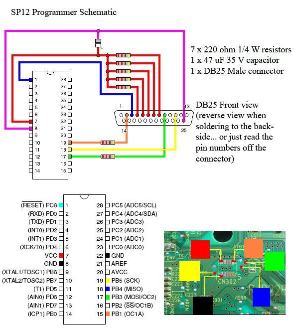

i have a atmega 8l dip flashed with the hex file. everything worked fine. now i want to install it on my cube to test if it works. does anyone know which pin needs to be connected with which pad on the drive board?
ct_the_1
Posts: 98
Location: germany
Re: XenoGC Full Source Code
Post by ct_the_1 » Mon Feb 28, 2011 7:47 pm
yamaharacer wrote:i have a atmega 8l dip flashed with the hex file. everything worked fine. now i want to install it on my cube to test if it works. does anyone know which pin needs to be connected with which pad on the drive board?
try this... (attached file)
edit: i'm not sure if you have to add a resistor ond/or capacitor to make this work, so no guarantee ;-)
