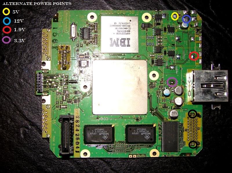

Hey Ashen, can you please post a picture where to solder in a rev C cube?

Here is a nice diagram Hailraizer made for rev C power points:

Ashen wrote:Here is a nice diagram Hailraizer made for rev C power points:
Thanks Ashen, but where is GND then?
Re: WODE/Wiikey "plug and play" adapter installation guide.
Post by Ashen » Mon Jan 23, 2012 4:12 pm
For lack of a Rev C here to show you some good spots, you can just use where I've circled in black in this pic:

Nice Ashen, thanks alot! I'll try out soon.
