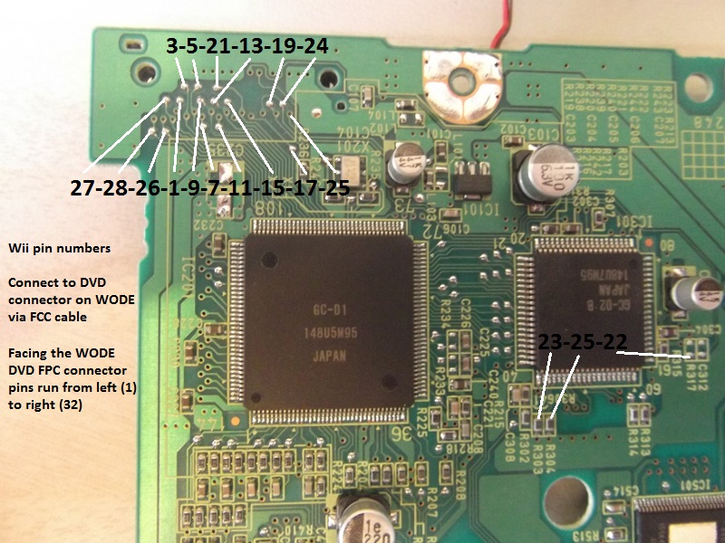

Post by kel01 » Sun Jan 29, 2012 6:52 pm

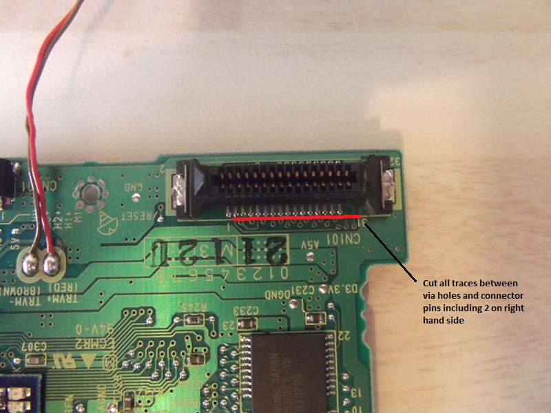

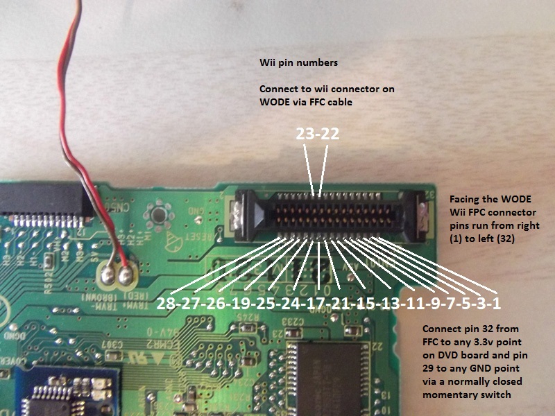

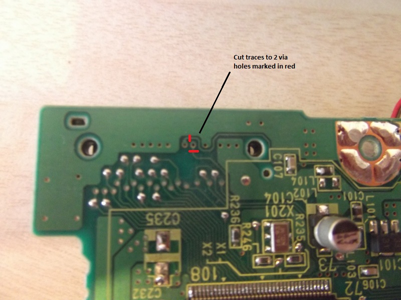

Here's the pics for the connections and traces that need cutting on the front and back of the DVD board.
Cut traces as marked below to break continuity from the drive board to the connector.
You also need to cut the 2 traces on the back of the board marked below as you cannot get to them from the front of the drive board.
Use the pins from the connector on the front of the drive board numbered below to connect the WODE Wii connector to the GC motherboard via FFC cable. I recomend putting some tape over the via holes so that there are no short circuits once the wires are connected.
Use the points numbered below on the back of the drive board to connect the WODE DVD connector to the GC drive via FFC cable. I have marked pin 25 twice to give an alternate point in case you don't want to solder to the via hole.
Forgot to mention that you can bunch all ground connections from FFC cables and solder them to any GND point on each side of the board. If there isn't a GND point where you want to solder them then just make one by scraping some of the green layer from a ground trace on each side of the board. Make sure it is a ground trace with a multimeter though or you might end up frying something :cry:
You can also take the 5v and GND supply for the WODE slave board from the GC drive board if you like. There are a few points on the front of the drive board marked as 5v and as I mentioned above it is easy to find or make your own GND point.
If you want to run backups or out of region originals with the correct video mode on this setup then you will need to install a XenoGC. You may also need to bypass the 150 ohm resistor in series with the pot and then lower the pot to roughly 120 ohms. Needing the pot to be this low has not been confirmed by anybody else yet so I would advise to try with a normal pot setting first then lower accordingly if necesarry.
It has also not been determined yet wether or not long term use with the pot set this low on this setup will affect the life span of the laser so only do this if you are willing to find out the hard way :cry:

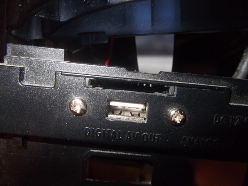

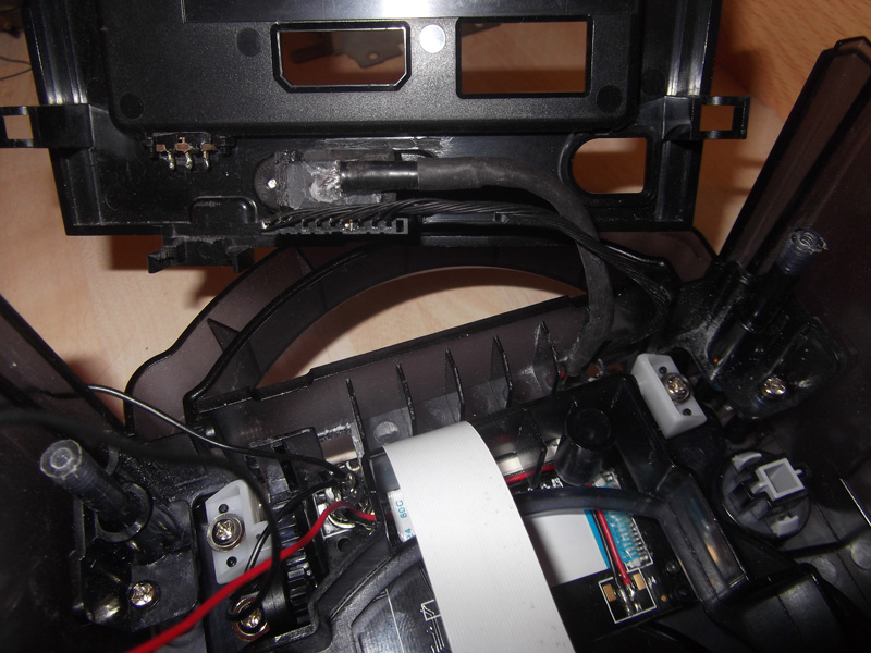

liquitt wrote:can you post another photo of the part where and how you mounted the usb/sd slots?
No problem mate. I'll take some more photos and post them as soon as I can. I'm not 100% sure it will all sqeeze together yet without trapping anything. Still got a bit more work to do to make it all fit.

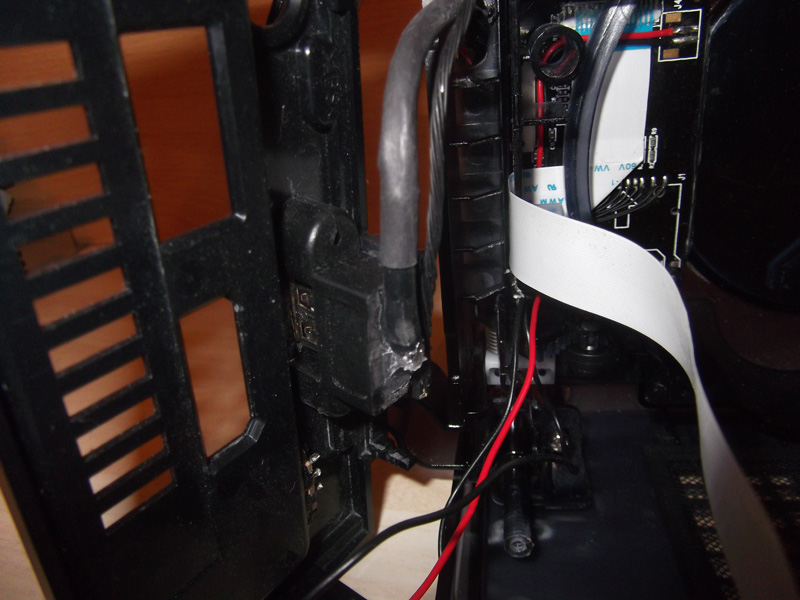

EDIT: Here's a few pics of the USB/SD slot.
I used the Startech USB panel mount connector in the link below. Should be able to find them on ebay easy enough.
http://intrl.startech.com/Cables/USB-2. ... SBPNLAFHD1
I had to very carefully dremel some of the molded housing away so it could fit in the GC without hitting the back of the disc drive. It looks a mess but no body will see it when it when the GC is assembled ;)
I got rid of the USB connector from the slave board and wired the panel mount USB connector straight to the slave board then took the SD card slot from the slave board and super glued it on top of the panel mount housing and then wired it to the slave board with some Kynar wire and finally I cut and drilled the holes for the USB/SD card slots into the back panel for the GC. It's a bit rough at the moment, could do with a bit of sanding and some black screws.
(185.06 KiB) Not downloaded yet
(170.42 KiB) Not downloaded yet
(155.81 KiB) Not downloaded yet
(162.94 KiB) Not downloaded yet

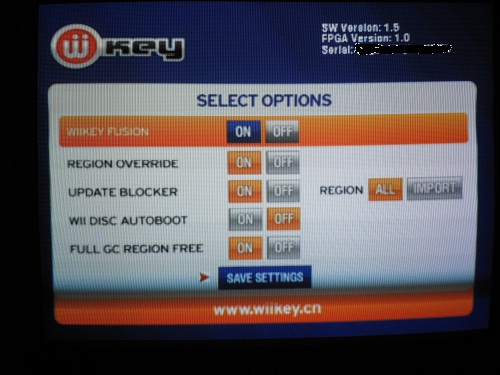

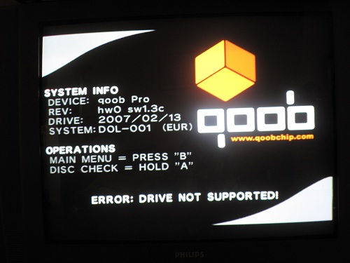

Installed a Wiikey Fusion, not yet the drive, but I have questions:
- Qoob Pro is not compatible, because mine says with Fusion 'DVD DRIVE NOT SUPPORTED' ? : edit: oops, bioschips and drivechips, ofcourse...
- How can I enable 'flat mode' :) ? This is my options screen, when 'Wiikey Fusion' set to off, Fusion still loads (or maybe when it detects a DVD-drive it is passing the signal through)?:
- Can the Fusion give 480p on a PAL Cube? Because everytime the output is a true PAL signal, no matter if a PAL or NTSC game is loaded. And I need NTSC, before enabling 480p with button B I think? edit: maybe Swiss can help, trying.. Ofcourse not, can't load Swiss after Fusion loaded a DVD

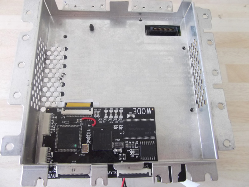

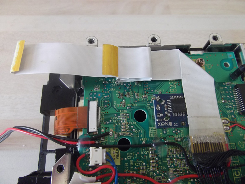

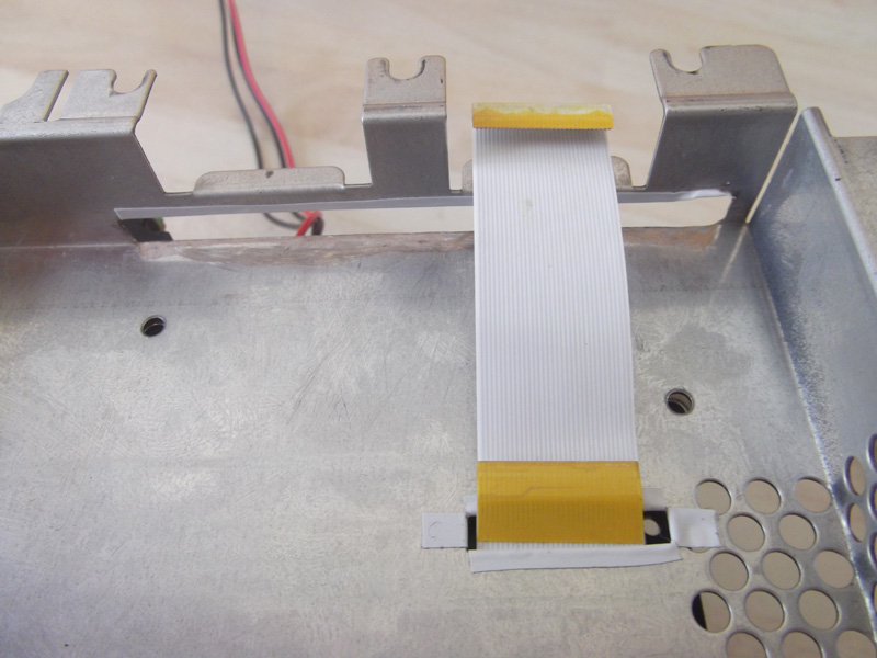

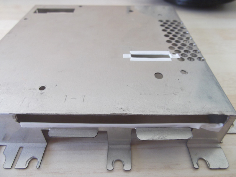

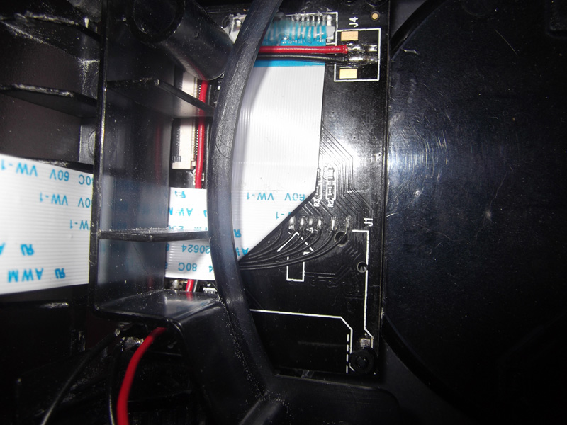

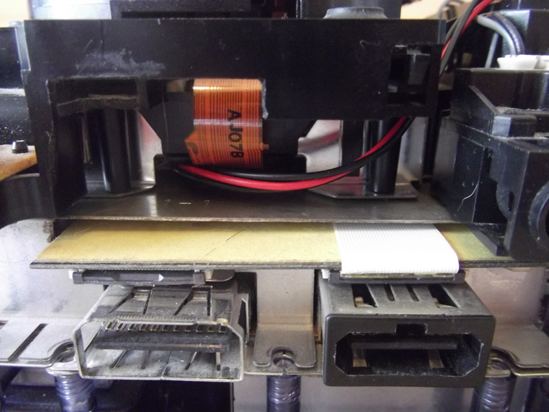

Here's those pics of where I placed the main board that I promised.
The main board is supposed to be stuck to the underside of the shield and sticks out above the 2 video ports. I haven't stuck the board to the shield yet so it's just hanging there at the moment for the sake of the pictures.
Here's another view of the board from below. Again I just placed it there for the sake of the pictures. Once finished the WODE top sticker will be covering the board.
I had to cut a long hole into the shild above the video ports for the main board to stick out of and another small hole on top for the FCC cables to pass through. I just stuck some white tape on for now to protect the board and FCCs.
Here's another view where the FCC cables from the DVD drive pass through the shield.

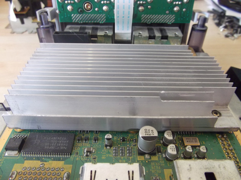

Post by kel01 » Sat Feb 25, 2012 2:09 pm
...Continued
I also had to cut away most of the first fin from the heatsink to make room for the main board and a small bit from the second fin so that the FCC cables could pass through safely.
...and finally here's a pic of where the FCC cables come from the DVD drive.
In regards to disc dumping it doesn't seem to have any problem trying to init the drive. The minimum it gets stuck on is about 3-4% depending on which game I try to dump. I manged to get to about 30% on one disc but it always throws the same error ([223] read disk failed) IIRC which doesn't really explain much. I'm going to revisit the DVD drive FPC connector that I reattached to the WODE board soon, maybe there is a dry solder joint somewhere.
I'm still having a few teething problems with this setup though to be honest, hence why I have not got around to putting everything together properly yet.
I get an intermittent "an error has occured...blah, blah" message when turning the GC on, mainly if the GC has been powered off for a while but after the first boot I can turn it off and on without any problems as long as it isn't turned off for too long :?
Also the eject button doesn't work if any video or audio cables are plugged into the GC :? It seems that some interference is driving the eject line low even when disconnected from GND via the eject switch. Should hopefully be able to fix this with a pull-up resistor to 1.9v on the eject line to pin 29 in theory :?:
I can post some more pics of how I fitted the slave board soon if anyone is interested?
