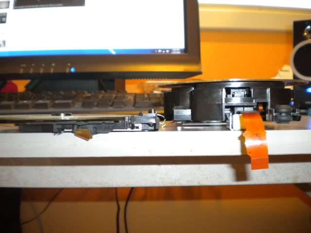

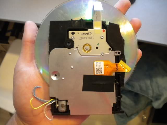

How "slim" did you manage to get the wii drive without the slot load mech? Do you think it is possible to slim the slot load mech aswell? I don't have the money to buy a wii drive for testing.
Post by Ashen » Thu Feb 10, 2011 5:41 pm
These are pics of a Wii drive slimmed down by Palmertech of the ModRetro forums. All cred for these pics goes to him.
