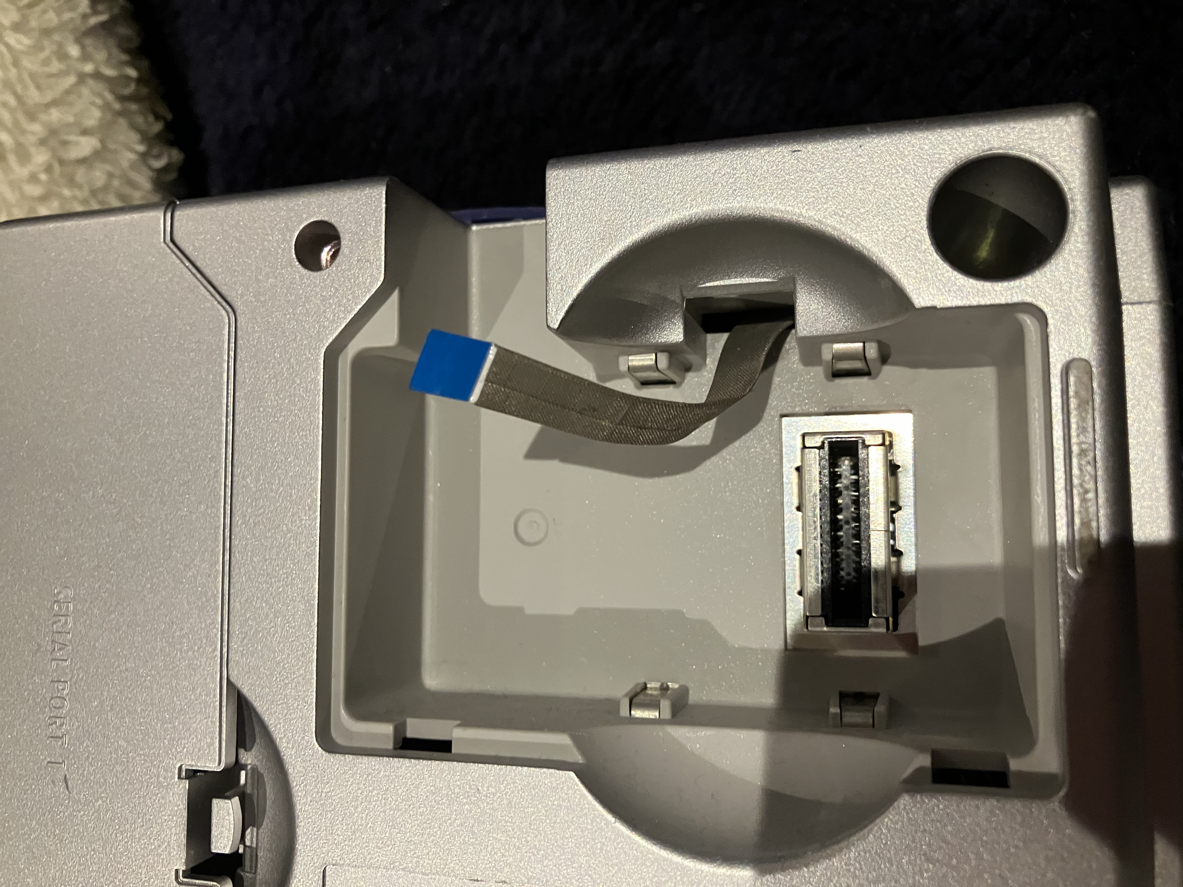

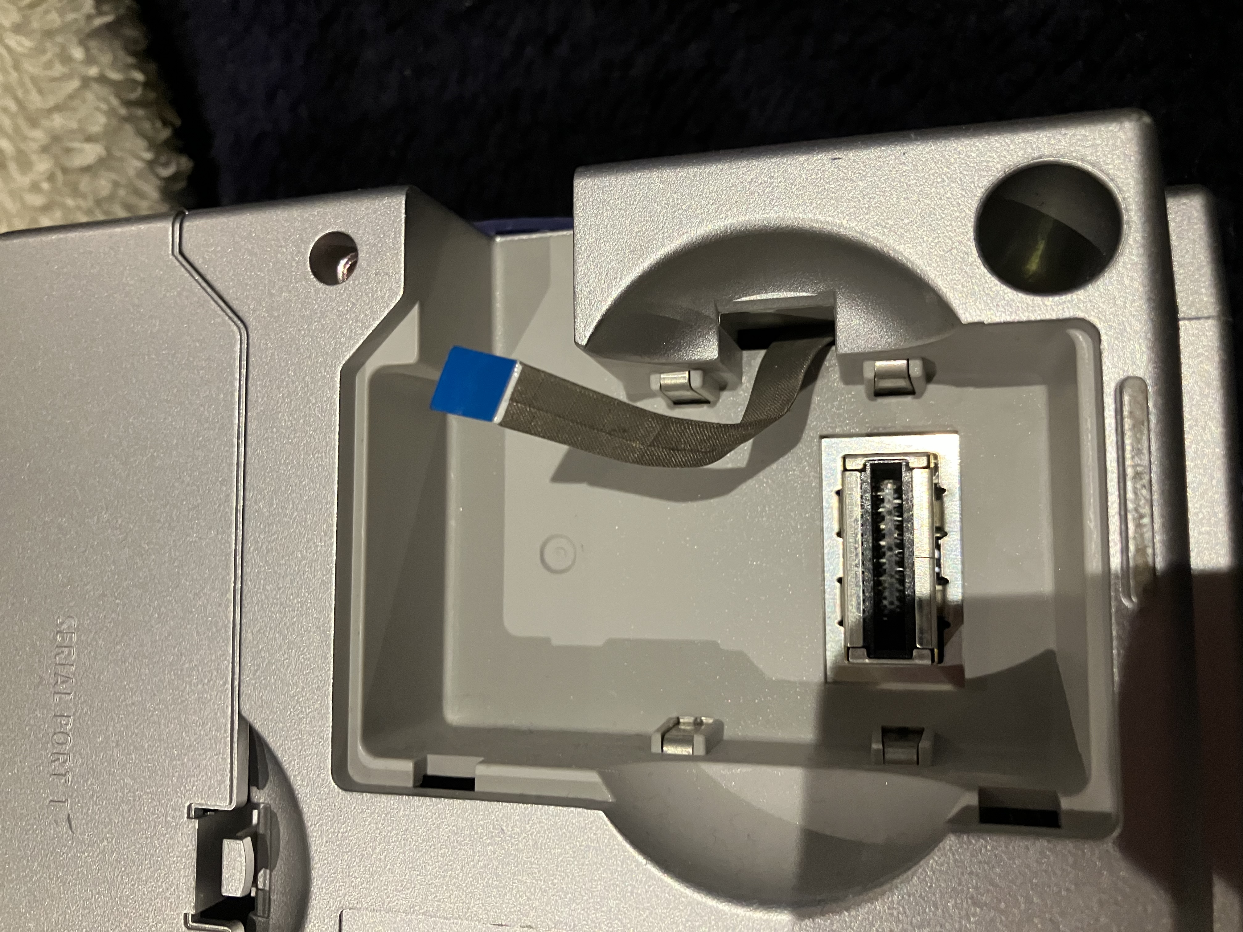

Gday guys,
I have seen similar questions but i too am asking. I have a Qoob Pro however over time i have lost the USB to FCC adaptor. My soldering skills are non existent
now is there a replacement board i can get or am i up s**t creek?
Cheere guys i want to run swiss from the chip and i really dont want to go replacing mod chips. I rather pit a GC Loader in and im not touching the clone garbage. B
- (3.24 MiB) Not downloaded yet
Re: Qoob Chip
The programmer board you’re missing is very hard to find. The only way I can think of you getting a hold of one is go on eBay and get another GameCube with a Qoob Pro that has the programmer board and use that.Schnapa wrote: ↑Wed Jan 25, 2023 10:25 amGday guys,
I have seen similar questions but i too am asking. I have a Qoob Pro however over time i have lost the USB to FCC adaptor. My soldering skills are non existentnow is there a replacement board i can get or am i up s**t creek?
