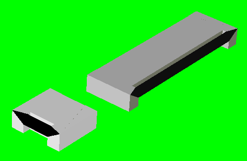

for the first batch of MEGAdrive PCBs, i was using a design program that was proprietary format. I have used this design program for years since it allows the home hobbiest the ability to print and make at home...also since i was very familiar with it, i wanted to make the first batch with something i was comfortable using...
i am currently in process of moving all my designs over to an open source format...this will allow virtually any factory to produce the PCBs...
the program i am using now also allows 3D views of the board but i have to create all the backend data and 3D models...
here is an example view of the 32pin FFC footprint and connector i created...
