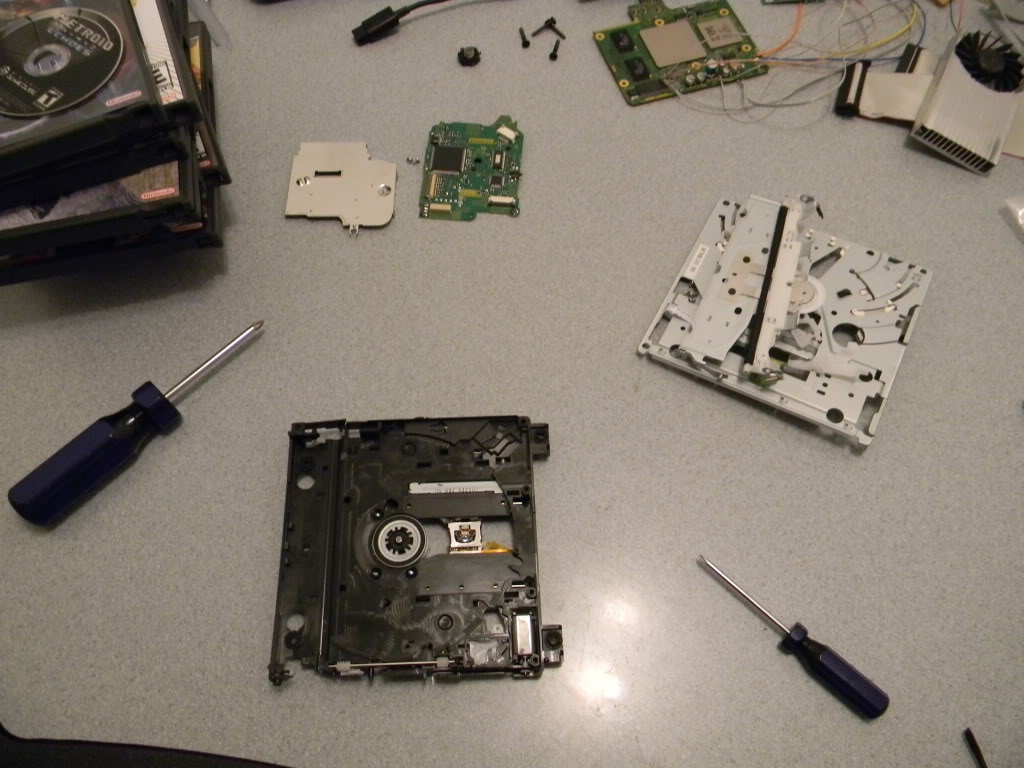

So... What better to do with a free afternoon and some brand new Wii disc drives? Start cutting them apart of course! :D :D :D
Semi slimmed Wii drive teaser video (please excuse my ghetto electrical tape holding the disc down, need to install top loading spindle still. Destroyed my PSone screen also, had to resort to video capture software on my netbook ><):
http://www.youtube.com/watch?v=MQuufqFvj5k
(115.06 KiB) Not downloaded yet

Ashen, that looks great :) I've gotta take a soldering iron to a DOL-001 tonight ;)
Post by Ashen » Mon Feb 28, 2011 2:55 am
Emu, forgot to mention. I sent 3.3v to pin 32 before i chopped those new drives up. No difference with the disc loading mech. It didnt hurt anything either though. 3.3v may be needed on this pin for chips like wiikey/wode/sundriver still.
Posts: 4948
Post by emu_kidid » Mon Feb 28, 2011 8:09 am
Ashen, I noticed that on the video it boots straight up from the GC menu, what's different about it now? Also, where'd you get those drives from? I'm interested in buying one :)

Oke I have some interesting news..... Last week I connected a NTSC DMS wiidrive to my NTSC DOL-11 gamecube. I soldered directly to the FFC cable and wired a discdrive connector from an old discdrive board I had laying around.
I got a couple of different modchips to play around with and have come to the following conclusions:
- Normally connected it will play all original NTSC games. They also direct boot. So I don't think it has anything to do with the discdrive revision but just the length of the wires.
- First generation WiiKey connected will allow me to play all original games from all regions but no backups. I was however able to boot a GCOS Wii gamecube collection disc a couple of times. However after the first 2 times I was able to boot it it no longer works.... When I booted it I was able to select the dvd drive. It than saw the wii drive correctly and booted it. Then the menu came up where I was able to select a game from the list. Once a game was selected I would get to the menu where you can select which video ouput you want to start the game in. At that screen it hung. I couldn't do anything.
- The SunKey drive chip did have some other results. I was able to boot the GCOS disc every time and select the video region. Once it rebooted it would just go back to the BOOT DVD menu of the GCOS disc. It won't however boot a normal backup and it will also not boot any original games from any region. Strange...
I'm gonna try a couple more things and make sure the chips are updated to the most recent version. The WiiKey Fusion is also going to be tested.

emu_kidid wrote:Ashen, I noticed that on the video it boots straight up from the GC menu, what's different about it now? Also, where'd you get those drives from? I'm interested in buying one :)
Not really sure what is different now besides the drive revision. The only thing I changed at all is the wire length. This new revision of the Wii drive seems much more prone to latency issues than my dms drive. As long as the game is in the drive before power on now it is autobooting them :) here's where I bought my drives from: http://crazydealguy.mybisi.com/product/ ... ntendo-wii you may be better off looking on e-bay first though. I saw some drives on there for $30ish.

THE DISCOVERY OF THE CENTURY!!!!! http://www.youtube.com/watch?v=jht0PBJVTZE
Thanks to Ashen, Emu_Kidid and everybody else involved with this mod (including myself :-P)
Wiikey fusion updated to 1.5. WiiKey Fusion must be connect to 3.3v to work. That's what the 3.3v line is for on the discdrive pinout like Ashen said. Still some game testing to do. But both games in the video have been played for quite awhile and work 100%!!

Here's an old cut up gamecube board picture as size comparison.
All you need are the gamecube mobo, regulator, wiikey fusion and the sd card reader addon. I kid you not.... that makes things soooo tiny. All you need is a good cooling system for the cpu and gpu, connect a screen and controller and your set. Ofcourse batteries but that depends on the regulator you use.
