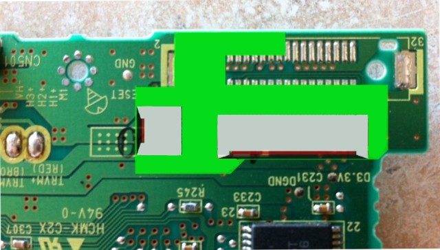

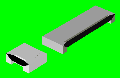

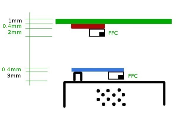

PART 2
The story of v4
Aug 27 2013, the initial concept was conceived for how to approach the next generation MEGAdrive ( now known as v4 ). This version was actually in development months before v2. Thru all the design changes and different approaches during the v4 development, a few of the previously scrapped ideas lead to the creation of v2 and then the improved v3.
v4 is by far the most complexed design I have created for the MEGAdrive project. The complexity of this design presented two issues:
1. finding a user friendly method of installation...
2. making a user friendly plug n play design that will actually fit within the limited space available...
There must have been over 20 design revisions during this development with most of the revisions requiring a complete start over from the beginning. I found myself continuously unsatisfied with the end results. It appeared as if the closer i came to achieving a great fit, the harder the installation became. The greatest challenge during this development was to maintain a user friendly design. What is known and has been a constant goal was to position the modchip between the drivecage and the drive board like this:
The advantage to this design is access to the mainboard would not be any different for how we typically access the mainboard during routine cleaning or inspection of the mainboard, fan, vents, etc etc. About 20 screws are removed from the drivecage. Then the drivecage + dvd drive are lifted off as one piece. This means the modchip will also be removed easily without having to touch it at all, thus minimizing and potential risk of damage . The modded drive could also be swapped into any other mainboard. This would allow a user friendly design since access to the driveboard itself is a very very rare occurrence. Other than adjusting the laser pot, what other reason is there to access the dvd driveboard? With this design in mind, progress moved forward to discover and create the solution.
It all started out from an idea presented by emu_kidid. His idea was to remove the drive connector from the dvd drive board. That connector would be soldered onto a PCB with an FFC connector for direct connection to the HOST side of the modchip and a second FFC connector audiostreaming data.
The drive board would have second PCB with an FFC connector for direct connection to the DVD side of the modchip and a second FFC connector for audio streaming as show in this beta development pic
While emu_kidid's idea was great, it turns out there were physical limitations which would prevent this design from moving forward due to the increased height the DVD drive would have to be lifted from the "drive cage." Using washers, the drive can be lifted maximum of about 1mm (if i remember correctly). Lifting the drive any higher would present issues screwing on the top half of the GC case back on normally. The FFC connectors would be the sole components defeating this design. To put this in perspective here is a crappy drawing:
Due to these clearance issues, this design direction was scrapped but the initial input alone from emu_kidid implanted in my mind a plethora of possibilities and directions to investigate. The initial design attempt created a great foundation of understanding for identifying the limitations of designing an acceptable solution. Since the FFC connectors could not be used with this design, the need to bypass the connectors was required. While looking at the GC controller board, it has an FFC cable directly soldered onto it. Why not create a design similar which would bypass the FFC connector? That direction could be possible but it would also require soldering 5v to the driveboard since the modchip is only capable of passing 3v. I wanted to eliminate the need for soldering as much as possible for anyone who purchased this design. I've come to understand soldering is an evil word and some people will simply turn away and wait for something that requires no soldering. SDML comes to mind. People who are typically nervous about turning a screwdriver, opening a GC, and performing soldering lean toward SDML as an acceptable solution since there is no potential for damage. While i have heard SDML is great, it does come with some limitations. Later on i will discuss a potential MEGAdrive vs SDML challenge.

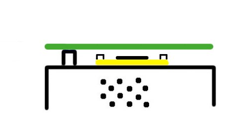

PART 3
The story of v4
Oct 7 2013, I reviewed all the previous designs and investigations to conclude there was only one directional possibility that could make this MEGAdrive version a success, a flexible PCB. This would allow for the most clearance to fit while also allowing for a creative solution where normal PCBs would have limitations.
I started preparing by brainstorming connectivity of data, power, gnd, audiostreaming, and pin29 while also having a dvd drive plug. It seemed more and more there was no choice but to include a requirement for a minimal amount of soldering. I had to weigh these options because no option thus far seemed to absolutly be solder free. How would this flexible design be any different? Over the next few months I approached the design with all these variables hoping to find solutions as I went along in the process. The design was created and modified many times while struggling just to find something "acceptable." Some thing acceptable...as in something good enough. I had already spend months with other design directions and I was ready to settle for anything acceptable.
What was I missing? Why did every design seem to not be practical? Where and how can everything fit properly? The answer was discovered after taking a break to drink lots of beer. Good ol' ale, how did I neglect you during these trying times?
Since I am working with a flexible PCB, the solution was simple: treat a 2 layer flexible design like a 4 layer design? With everything set in motion, all previous flexible designs were scrapped and this new idea was started. This time every single requirement was successful placed within the new design. Due to the new design the entire scope of the installation also greatly changed due to its complexity. The assembly of the design is easily beyond the abilities of the average modder and possibly very challenging for highly advanced modders. This will not stop anyone from enjoying this version because all soldering will be performed in advance to still allow a simple plug n play solution.
The design was completed but not yet 100% acceptable compared to my initial vision. Subtle changes were performed and slight improvements. The one major concern i had was due to the fact that it was a flexible PCB. My concern was due to possible accidental damage from its delicate nature. Then i received my mystery package from liquitt. Within that package was a GBA begging for a backlit screen replacement. The modification for the screen requires a flexible PCB and many people of various skill levels have performed this installation without major issues and the flexible PCB has also held up to "some abuse." Had liquitt not sent the GBA in the mystery package, I might still be contemplating the practical use of my flexible design. Thank You liquitt.
After a few more subtle design changes, even up until last night, this project has been under constant development for 6 months. I have now completed this project and feel 100% positive about this design, its ability to have full functionality for WKF/WASP + a DVD drive, and its easy of installation for the end user (fully assembled by me).
V4 is ready to send off for fabrication.

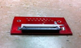

PART 4
The story of v5 and v6
Sometime in January 2013, Diminuendo approached me with a special request to make a custom MEGAdrive PCB for use in his portable GameCube. His only requirement was for the design to solder onto the mainboard from the bottom, unlike the MEGAdrive V1 which solders on top of the mainboard. The request was simple enough. Make a version which directly connects to the bottom side of the DVD drive port. During the planning and thought process of designing it occurred to me to also investigate a version which would connect directly to the DVD filters. With the limited time I had available to focus on the project for Diminuendo, I decided to make a simple DVD connector bottom mount which would also be the easiest method of connectivity. So I created a bottom mount MEGAdrive and shipped it off to Diminuendo and left the idea of a DVD filter connection for a later time when I could dedicate more time to the design. I think it was a 3am idea to even consider the DVD filters. Even more reason to hold off on it till I had had more time to investigate.
The DVD connector bottom mount design was suppose to be unveiled and featured in a build Diminuendo was working on but that never happened. WHY? Diminuendo destroyed the board. Yea, all that hard work down the drain. He killed the design because he used a type of wire that had some kind of coating which would not allow the solder to set onto. The only known prototype in existance was ruined. Here is the only known photo of the prototype board sent to Diminuendo before its ill fated destruction.
The idea of releasing a portable version of MEGAdrive was put on hold because if someone as skilled as Diminuendo could destroy the board, maybe it was best to forget about releasing this version to avoid the potential from others having similar experiences. Yet, one problem that continued to plague me is the thought of how many people try to make a portable and fail in their progress due to the complexities involved in connecting a WKF/WASP. It is difficult enough to connect a WKF/WASP to the GC and even worse to troubleshoot any issues that arise. These continued issues were my main concern in offering a solution which would minimize the need to troubleshoot and possibly allow for a problem free method of connectivity.
Generic FFC breakboards are a great solution for connectivity of the FFC cable, but they still require proper wiring. As shown in numerous build threads, the wiring itself can be confusing and sometimes disasterous. Even wiring directly to the modchip itself shows mixed results as the modchip might seem to work for some titles and fails with other titles, all the while being directly related to improper connectivity. With a MEGAdrive designed specifically for portable use, I have eliminated the need for concern of proper wiring. Simply solder as indicated and connect an FFC cable. Your only concern has now been minimized to ensuring you have proper solder joints.
MEGAdrive for portables will be available in two versions. A bottom mount version which conneccts to the DVD connector port suitable for most board cuts and another version which connects to the filters suitable for an OMGWTF board cut. The failue of Diminuendo's attempt was not in vain. It also allow me to consider how i could improve the design by upgrading the materials and pad finish. Nothing but the best offered will be used. I demand high quality. These projects are a reflection of my hard work and I want to enure nothing but the best is available for all to use.
Conclusion
As of this post, all designs have been completed and are in process of being sent off for production.
Once i receive the boards, I will be able to commence assembly and distribution of sales....
