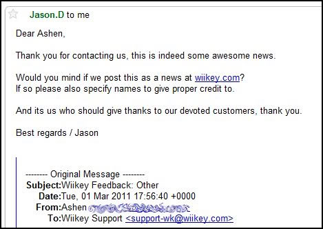

In other news, keep and eye on the Wiikey official site news section ;)

Would be awesome to be credited by the wiikey team themselves. We've added another feature for them. They only need to make a little add on adapter and they can make more money :lol: Thanks for contacting them. Maybe they will be able to do something about there firmware. Maybe more compatible for the gamecube! Aaah you can always hope :roll:
