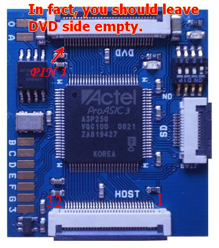

Post by bearteam » Fri Mar 11, 2011 12:19 am
Ashen, the pin order of Wiikey 3 may be clearer as following pic.
edit:Sorry for my mistake. I have alreay corrected it.
(407.65 KiB) Not downloaded yet
