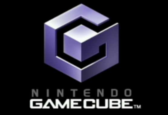

I made more testing this afternoon.
It seems that the compatibility is not good, many games hang when the GC logo shows. When the blue LED light on WIIKEY keep shining before GC logo, the game will hang. If the light flashes for sevral times, mmm, the game will pass the logo successfully and run perfectly.
Here the list of games I tested:
BATMAN:DARK TOMORROW (both NTSC-U and NTSC-J work)
RESIDENT EVIL 2 (both NTSC-U and NTSC-J work)
Generation of Chaos Exceed(NTSC-J,works well)
varanoir(NTSC-J,works well)
the games below all hang on the logo:
Chibi-Robo!
Resident Evil Disc1
IKARUGA
Chibi-Robo!
Resident Evil Disc1
IKARUGA

Both Resident Evil and Ikaruga has streaming audio,bearteam wrote:the games below all hang on the logo:
Chibi-Robo!
Resident Evil Disc1
IKARUGA
could it have something to do with that?
No idea about Chibi-Robo! though...

No, the results are the same as before:(Ashen wrote:Bearteam, just for the sake of trying. Wire up a regular on/off switch between pin 29 and ground. Ditch the 1.9v line altogether. See if you get any different results.
I am sure the ISOs I used are good becasuse they are Redumped. I downloaded them from here: NO ISO LINKS!
I made some testing last night.
Before those games hanged on the screen, I kept pressing A button, then I could enter the Game Selection. It showed "Reading Disc" .I think that's why those games hang. Maybe it's because Wiikey could not emulate those ISOs correctly on GC , or even on Wii. I don't own a Wii and I can't test those games on Wii.
I built an ISO with Swiss 0.1r33 and Disney Soccer, and the Swiss booted successfully. I could see the Disney Soccer.gcm in the DVD list, but when I tried to boot the game, I got nothing but black screen. Hoping Emu_kidid could fixed it.
