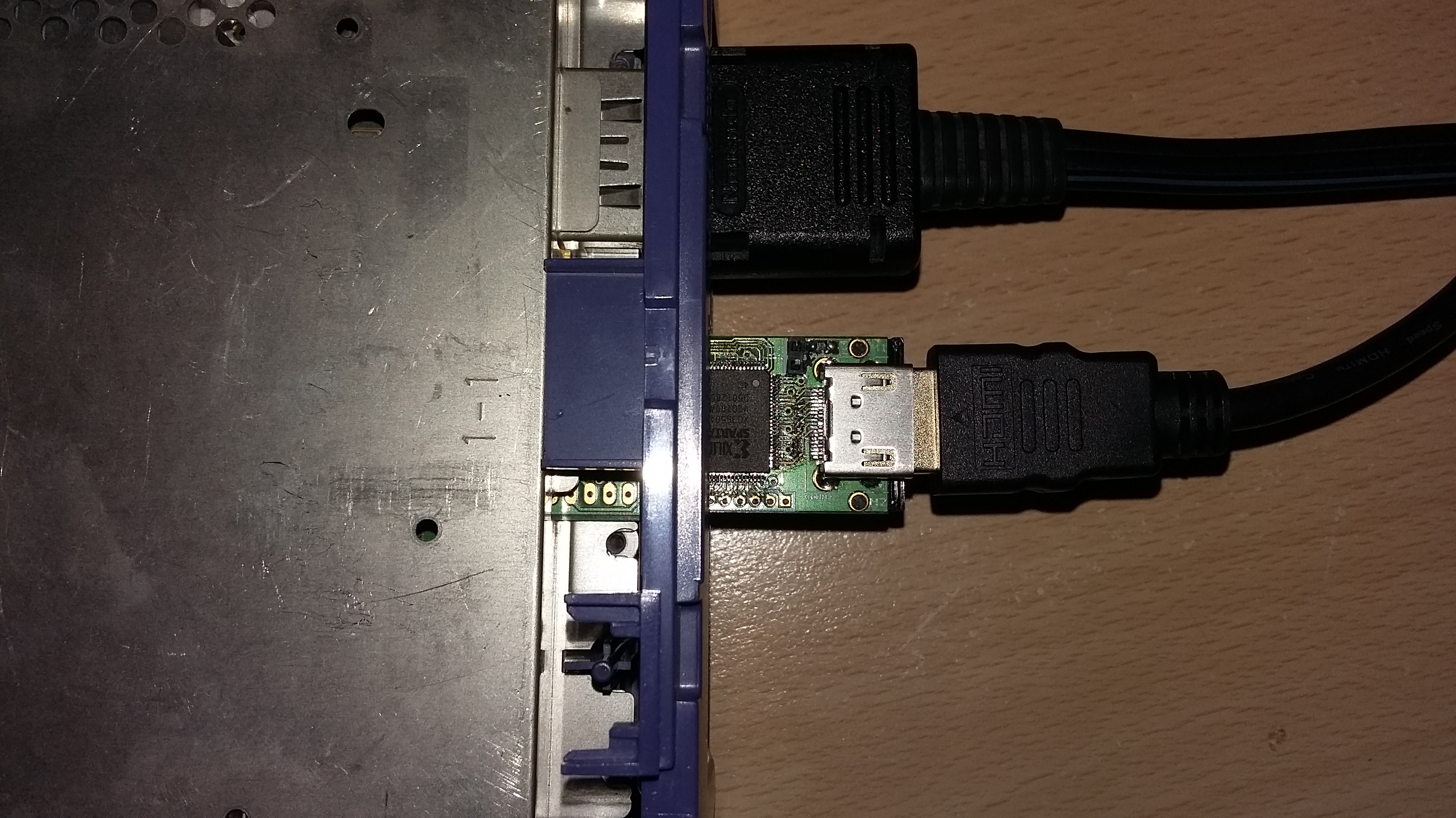

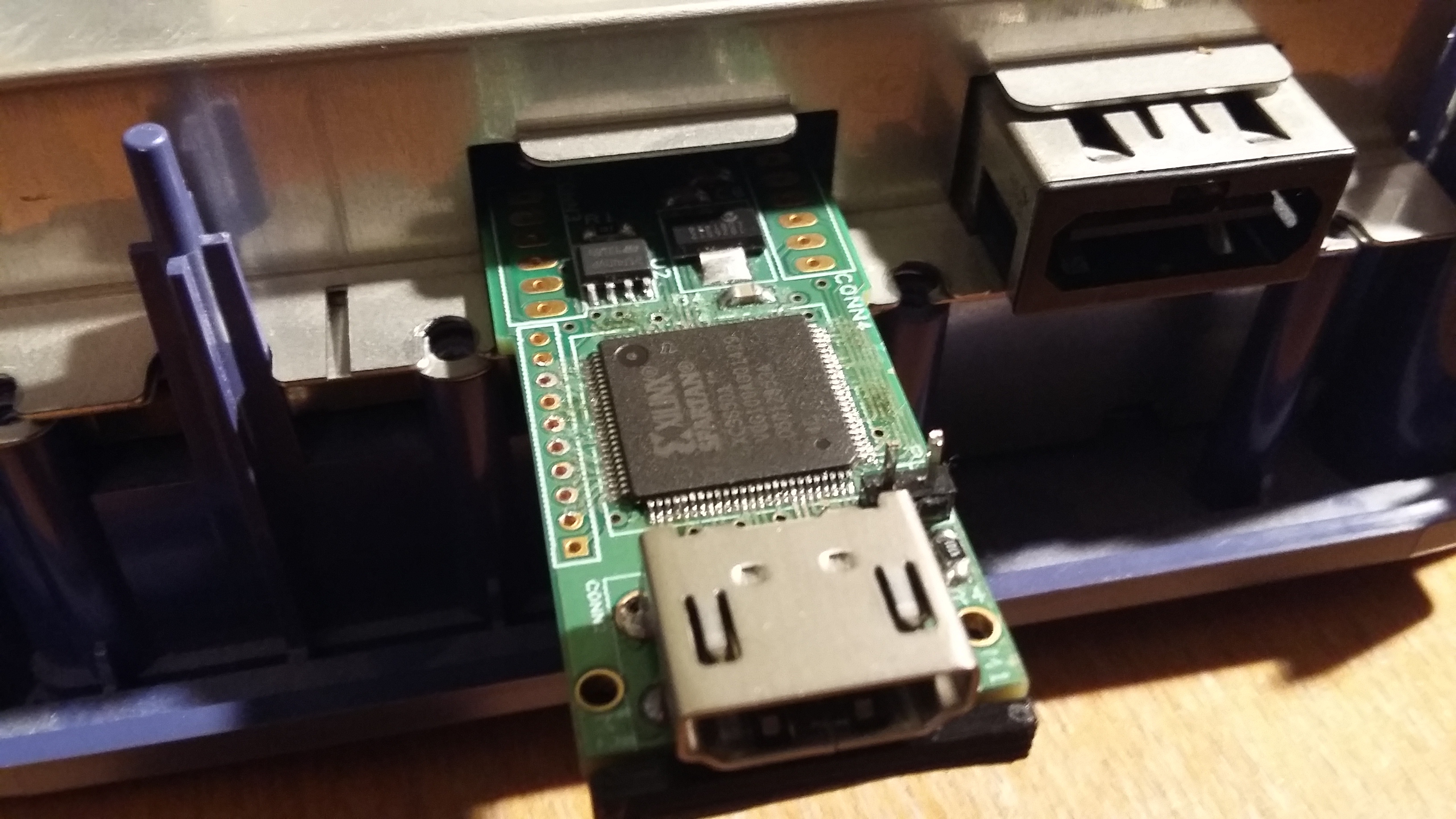

I'll show you some pics durning my working on this:
NTSC-J GC, without dvd drive, so hang at power on:
NTSC-U GC, but it too old that can't read the disk:
The SMS pic was taken form my PAL GC.
