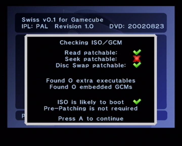

Here's some more progress:
(41.7 KiB) Not downloaded yet

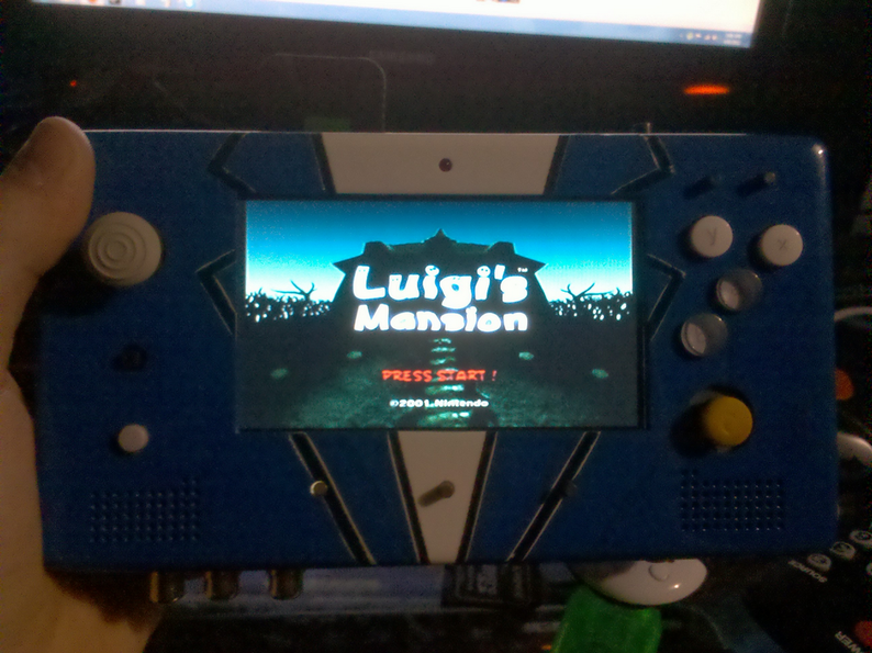

EMU_KIDID YOU ARE JUST SO AWESOME!
Also I love the new look of swiss, very wii homebrew channel feel.
(652.15 KiB) Not downloaded yet
