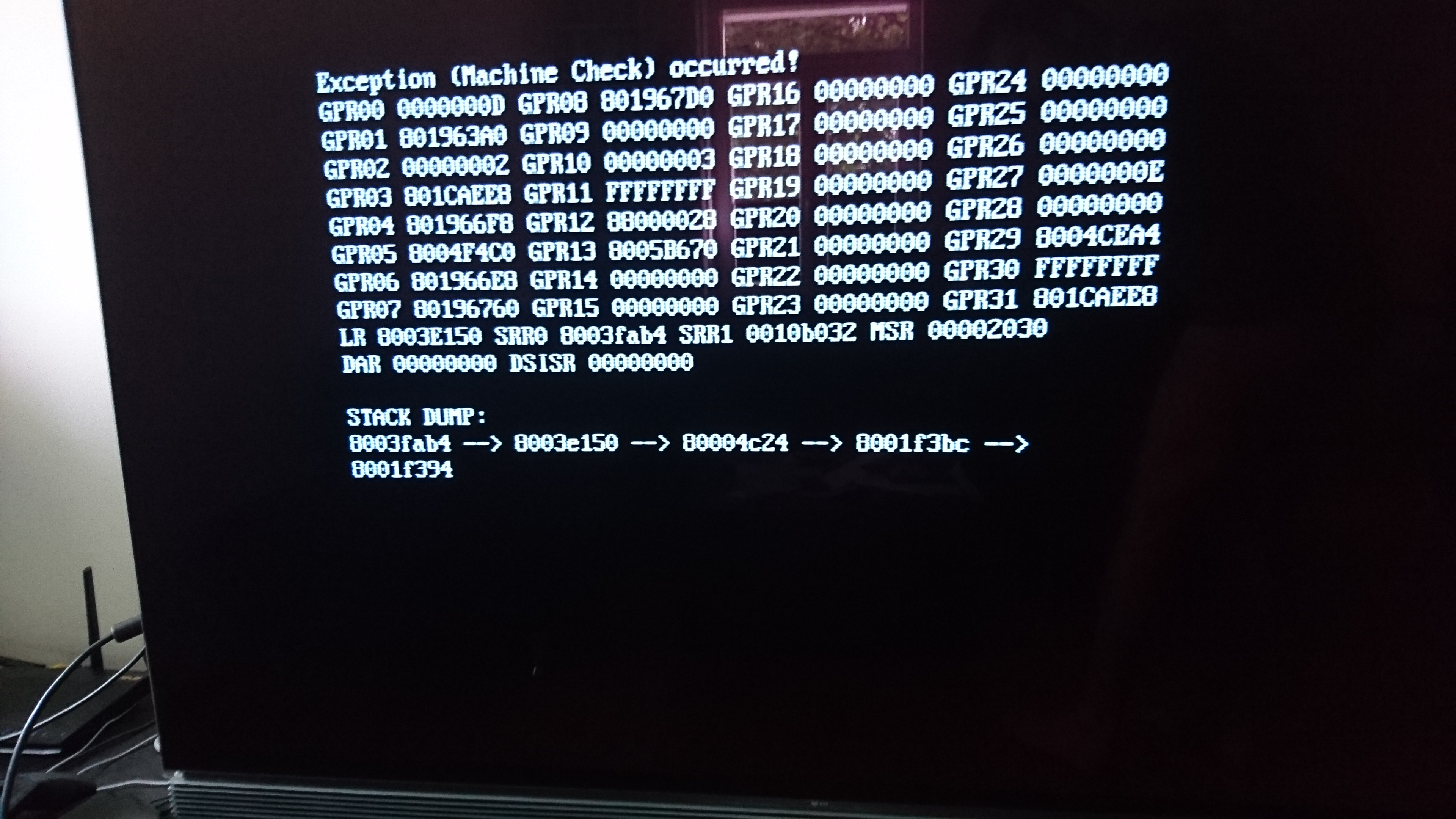

I now got my rgb cable... The picture is great with my Framemeister but i still did not manage GBI to work. While playing with the launch setting in swiss i managed to get some different results feom the black picture. For example when i Run LL Version with pal 60 in 480i i get a crash dump. (attachment)
I dont know if it is a step back or forward but at least I got a picture.
OH with the RGB cable ULL version now works!!
(2.35 MiB) Not downloaded yet

Post by Extrems » Sun Jun 25, 2017 1:45 pm
Yikes, that's a L2 cache double bit error. Your CPU might have a defect.

Post by DJravingMonkey » Sun Jun 25, 2017 2:19 pm
Interesting, everything works fine...
