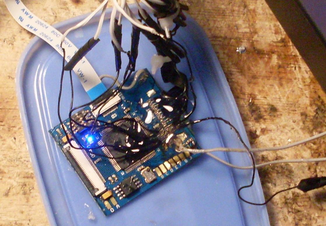

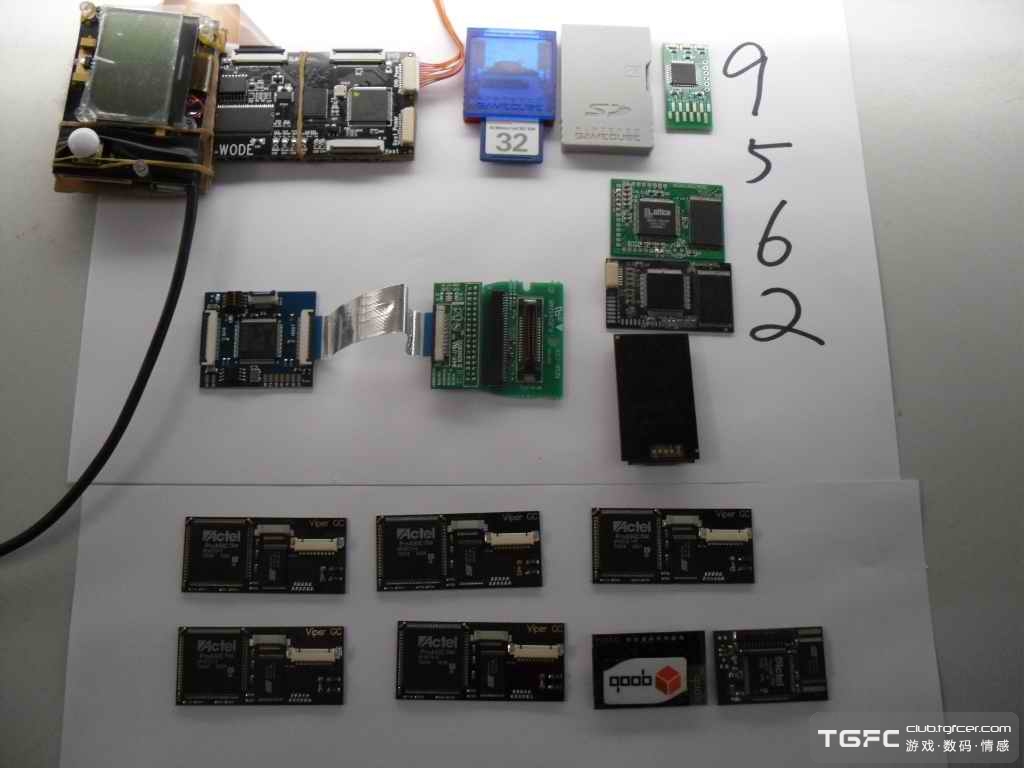

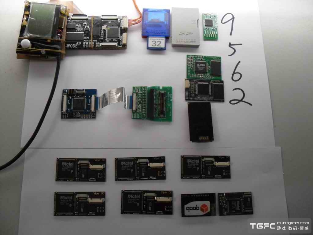

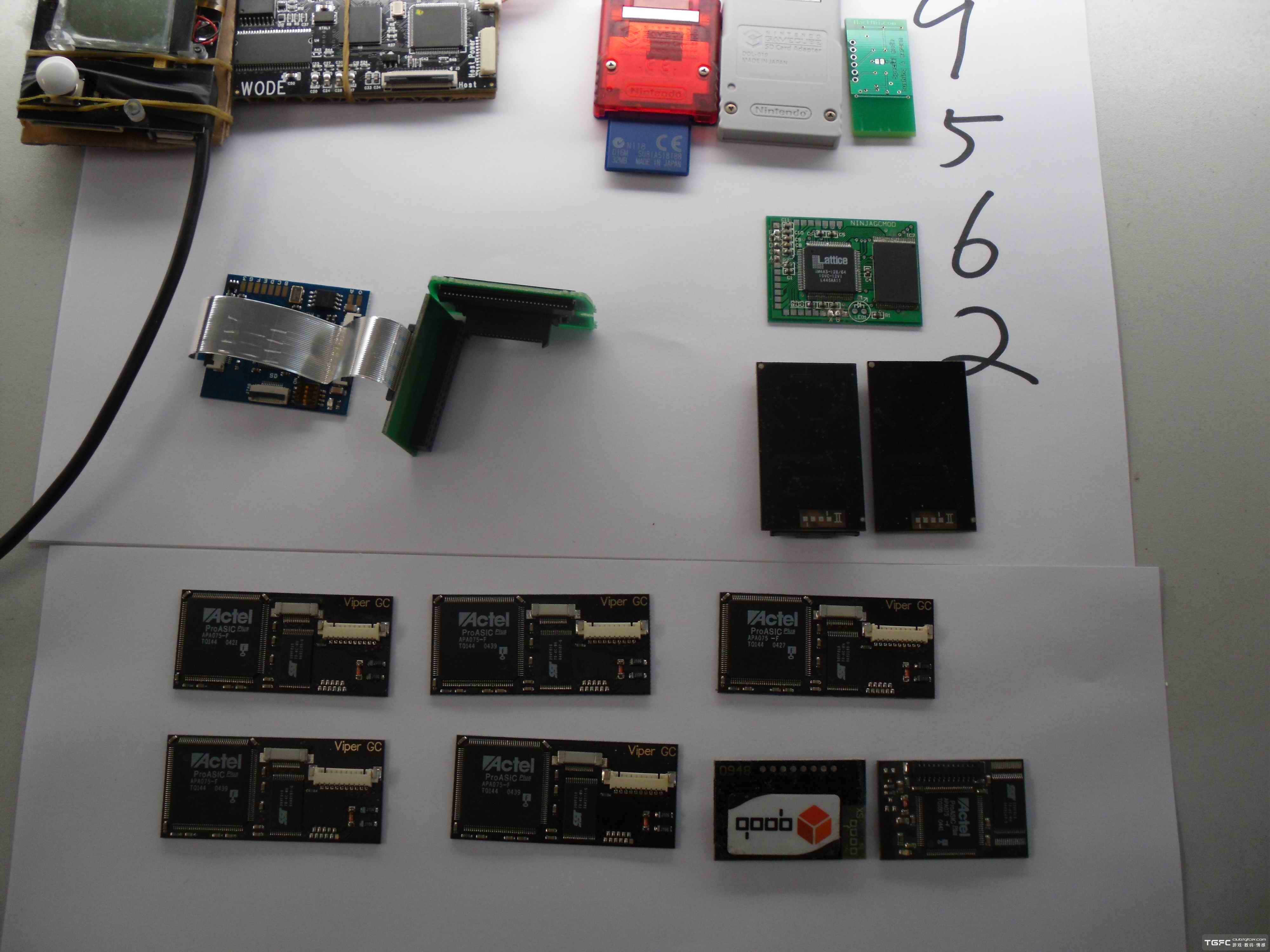

zhou9562, where'd you get that FFC board with GC DVD connector pads?? VERY interested in some
Panasonic Q GC DVD connector pads

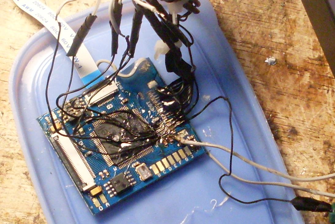

must Welding to ffc board

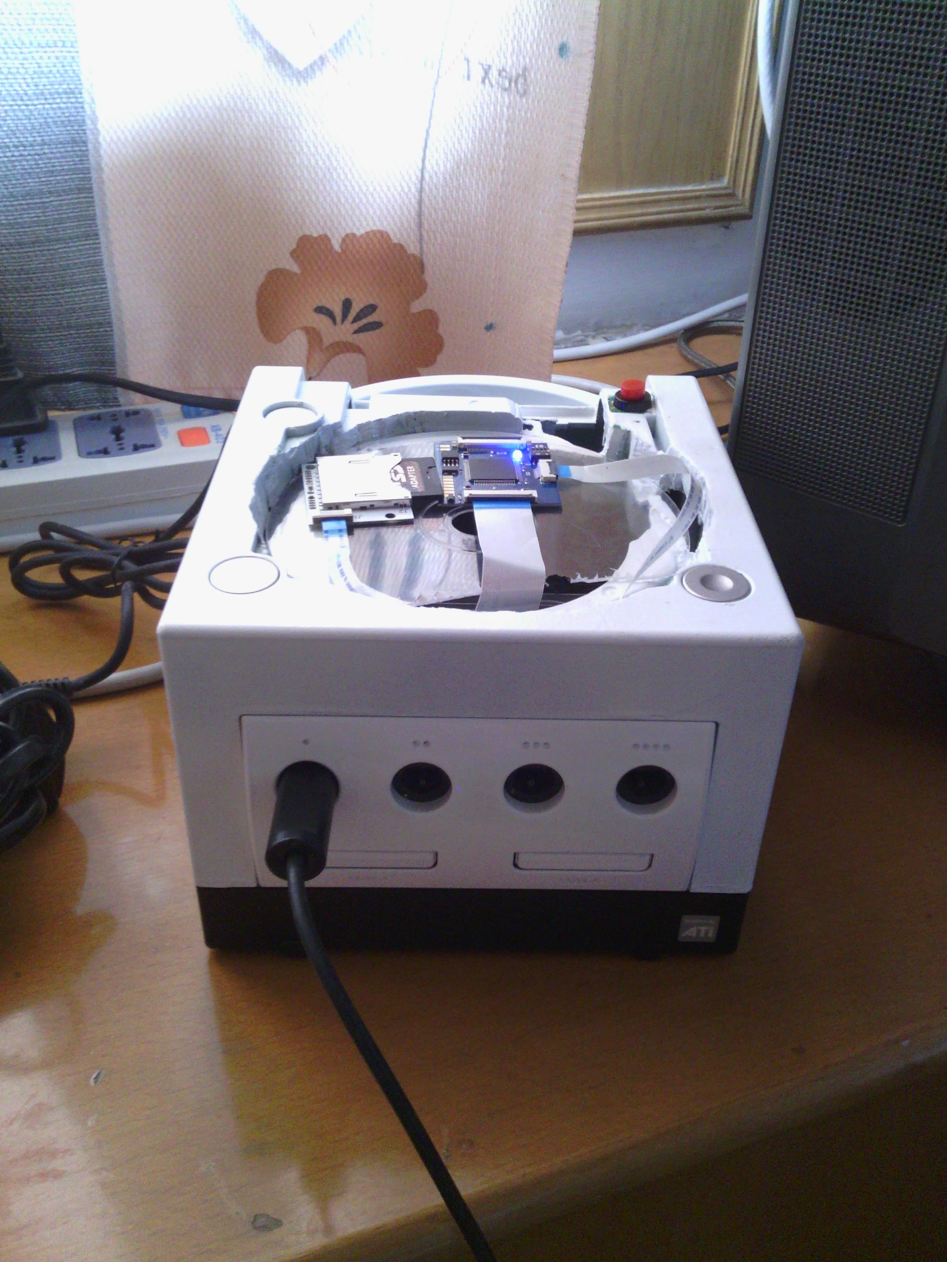

The red switch is a self locking switch.

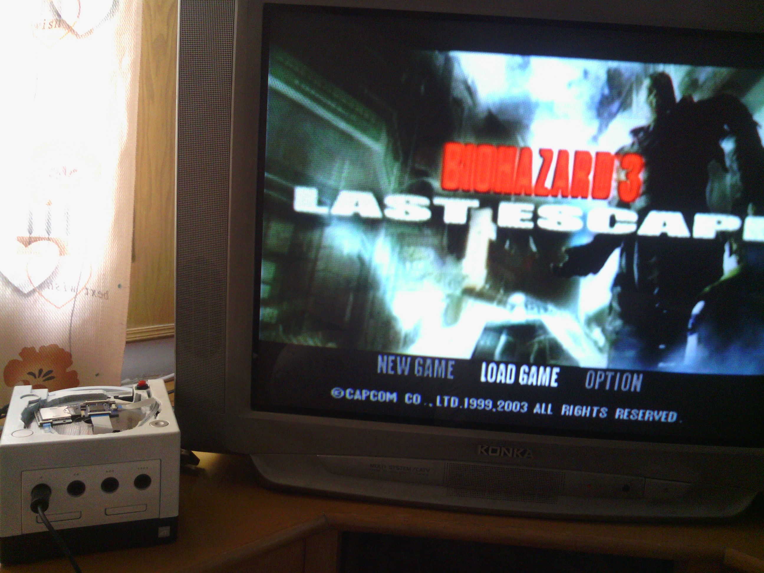

IPL1.0, NTSC-J.
IPL1.0, NTSC-J.

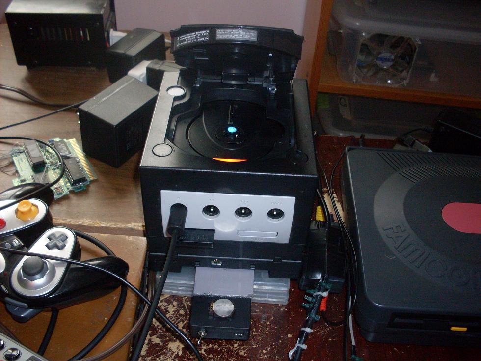

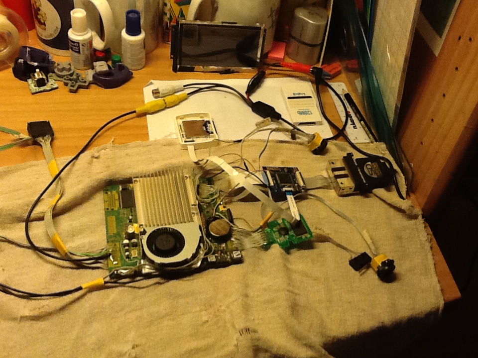

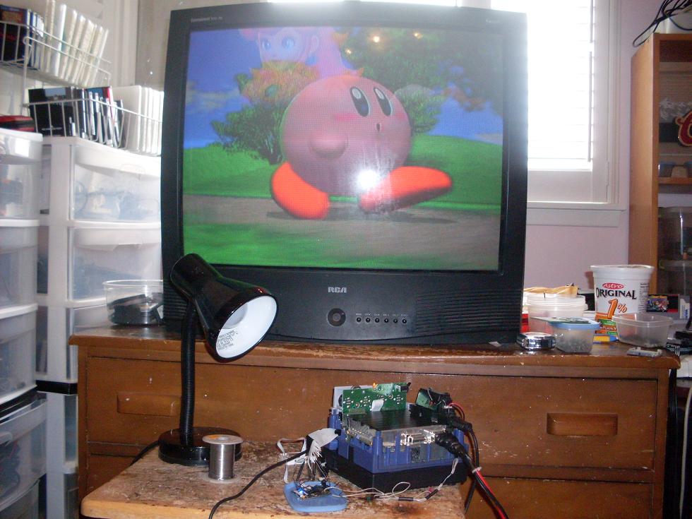

my GCP in it's current state: (near completion)
19/10/12
HISTORY!
well, why you say?
i received my commissioned modded gc from Ashen, whom i had sent my stuff to him to mod for me, as i cannot do such stuff successfully,
list of my gc's features (credit goes to Ashen for the awesome modding):
1) Wiikey fusion wired to GC
2) Bottom Ports Removed (space saver!!!)
3) Slot A removed/ Slot B extended with wires
4) Memory card 1 (1028 blocks with some of my saves) wired to Slot A.
5) trimmed gc motherboard, Minimalist GC cut (huge space saver!!!)
6) extended controller port 2
7) Cut/Modded controller for Player 1.
8) SDPT switch for the gc disk lid switch for Multi Disk games
9) Added an Eject switch type needed for wiikey fusion.
10) Replaced Original powerboard with a custom regulator of 7.4v and wired to system's Heatsink
11) Replaced stock GC fan with a PS2 fan & wired it's cables to system.
12) Added wires for Shockslayer LM368 Audio amp (GND/+5v/L audio/R audio) for easy wiring to the amp.
13) Kept AV's Yellow plug for connecting to screen's yellow plug for video.
14) extended the Output port for external (out) for AV or RGB to TV.
15) Replaced GC control stick with the control stick of the super pad 64
16) used Digital tact switch mod for L/R buttons
17) Added Gamecube Bios battery holder for easy +3v Lithium battery input.
which he did a FANTASTIC job, may i say
im SO happy, my portable is like to 95% now.

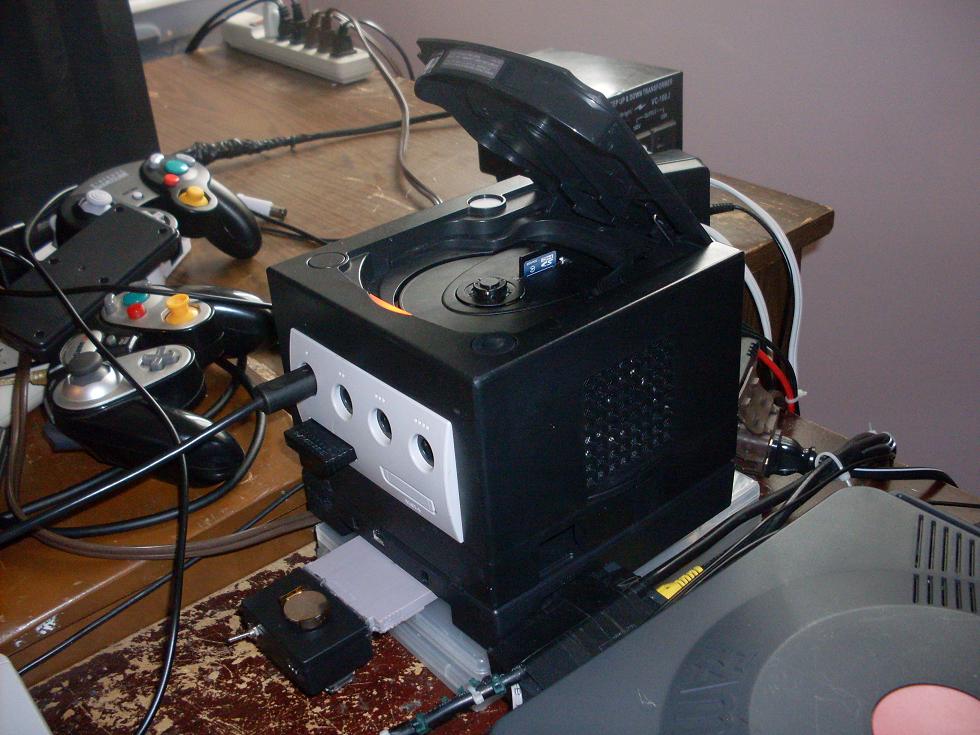

WIP for sure. I am just waiting to build a programmer for my xenogc to make my wiikey fusion gc into a xenofusion gc. Give her a paint job or go out for a full size dvd case. Haven't decided yet. I would use the xeno flash utility but its been a whike since I really worked with anything I don't think it woukd turn out.
Got a suggestion on what to do from here let me know, I am definitely adding leds for the xeno and wkf. Just having brain farts on what to do.

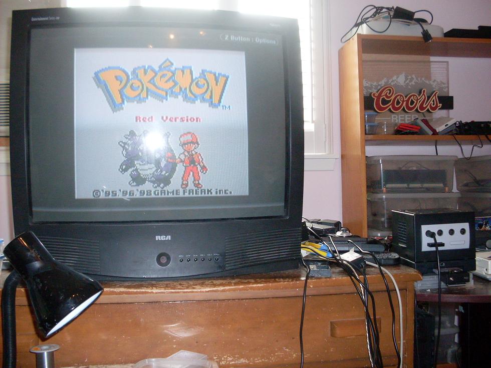

Who needs ribbons..
Playing a romhack I helped make of marioland as a full colour gameboy color rom, using a devcart I quickly built:

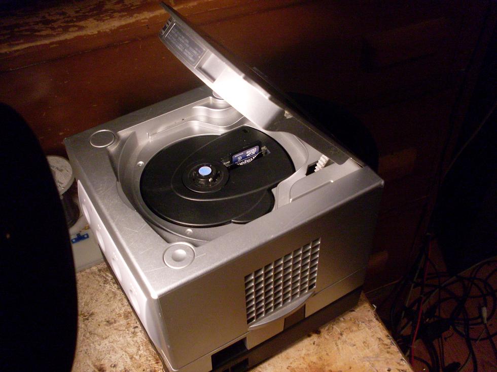

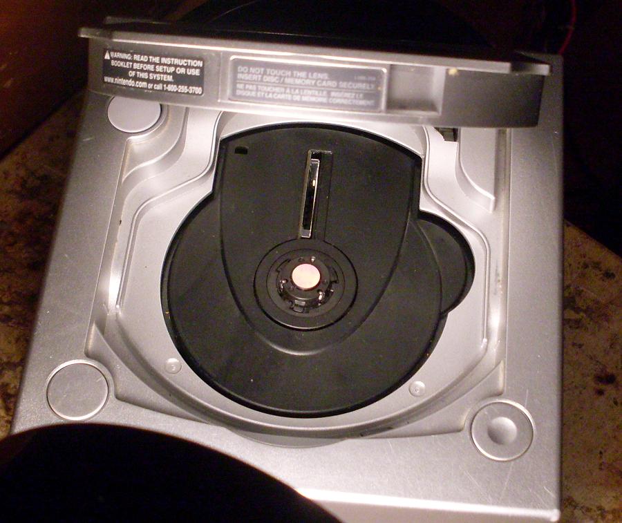

After dropping the sd card into the hole next to the slot and taking the console apart to retrieve it I decided to fix that:
I also taped the sd slot ribbon cable down so the plastic bits from the lid no longer collide with it when opening / closing the lid. Sorry I keep posting new pics I just started modding my first gamecube last week so I'm going through the paces quickly.

I like the placement of your SD card slot! Though it's unfortunate that your DVD drive will no longer function
I look at it from the perspective that I now have a bunch of fully working dvd drive replacement parts haha.deckard wrote:I like the placement of your SD card slot! Though it's unfortunate that your DVD drive will no longer function

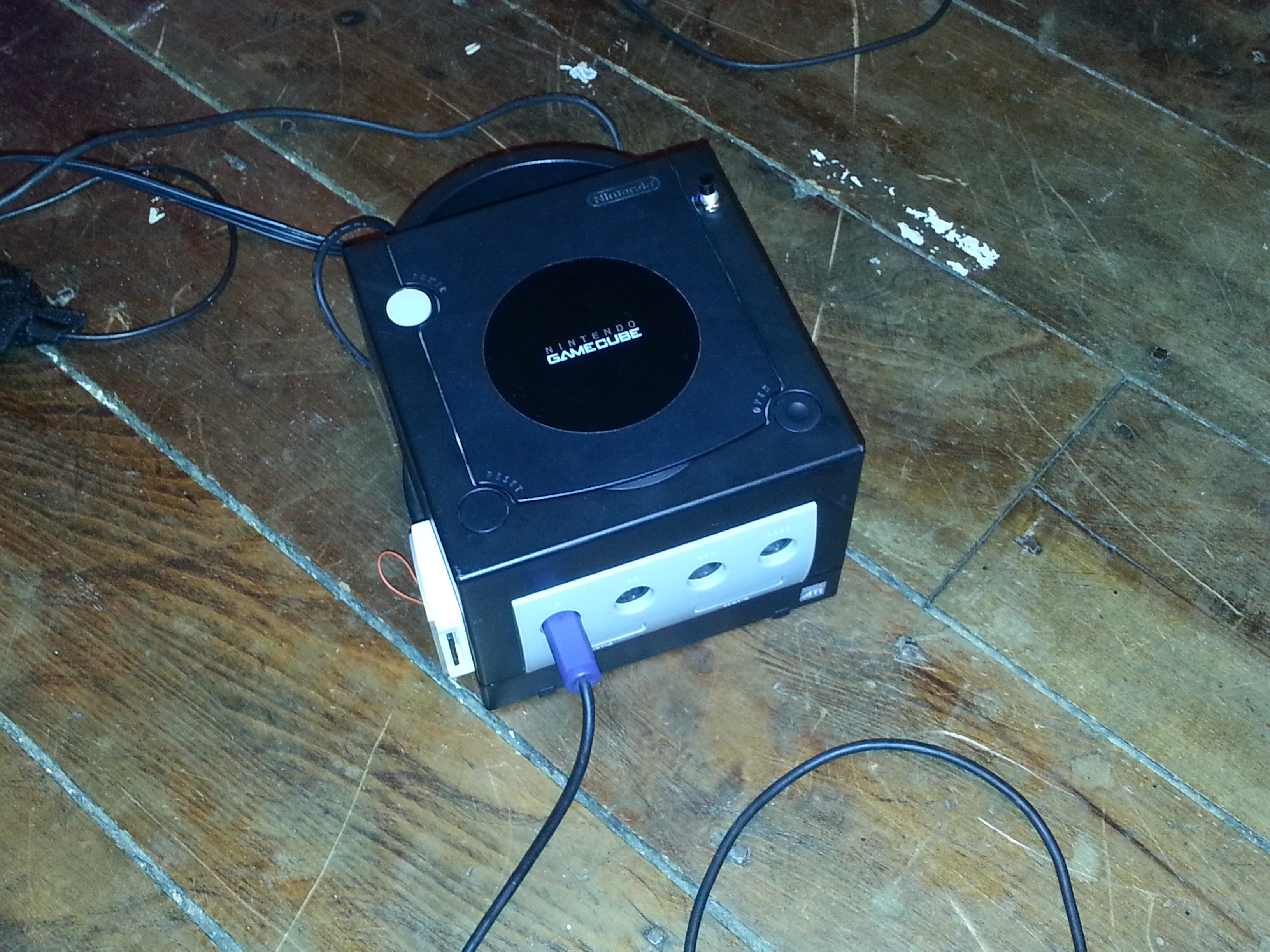

I'll post one soon, just got my wiikey fusion for 25$. Just gotta wire that bitch up and smoke up the WKF IcedCube. (Also planning on adding internal memorycard, internal wifi receivers for wavebirds, and do the n64 gameboy player mod and add wavebird receiver and gc to n64 converter inside it. Going for the ultimacube, all in one gaming station).
Wish me luck, I can't wait to use the WKF
Edit: It's a clone, but it's confirmed to work just like the WKF for swiss autoboot and NGC.
