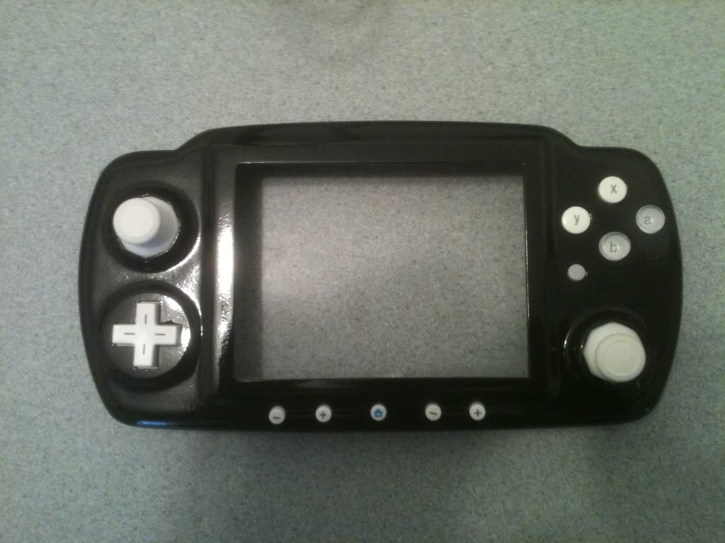

Post by Ashen » Tue May 03, 2011 5:42 pm
Opinion needed on this:
What do you guys think about the white buttons against the black case? Its up to emu in the end of course. This one is his. I know the photo is sideways.. Sorry cant do much about it from my iPhone.
Opinions welcome!!
(108.69 KiB) Not downloaded yet
Post by emu_kidid » Wed May 04, 2011 2:39 am
Looks good to me :)

Post by epoch » Wed May 04, 2011 2:42 am
Ashen wrote:Opinion needed on this:
Opinions welcome!!
the contrast between black/white is actually quite awesome! i like it better than the original pictures you showed here...
(and man, you DO have skillz! mad props!)

Post by Hells Guardian » Wed May 04, 2011 2:48 am
I love it but I still say that slot B should just be an EXI port instead of an internal Gecko...
Post by Ashen » Wed May 04, 2011 3:33 am
Awesome, Thx for the feedback guys! Fixed the picture rotation now that I'm finally home. I also like the contrast of the face buttons, I have painted L/R and the double Z buttons black though because it was a bit much having them white also. Paint and clear coat still needs to set a few days before I can do any real work to it still.
Hells Guardian wrote:I love it but I still say that slot B should just be an EXI port instead of an internal Gecko...
This will be considered for the next revision of the portable on both slots A/B. At this point its to late for me to change these ones without having to mess with the cases. The reason I designed everything internal this go was to make the case more streamlined and not have anything bulky sticking out besides the 2 SD cards. This was just my personal preference.

Post by kevstah2004 » Wed May 04, 2011 7:08 am
Prefer the white one, gloss black plastic always looks cheap imo, I prefer matt.
How about some metalic colours with gold buttons.

Post by Ashen » Wed May 04, 2011 12:08 pm
kevstah2004 wrote:gloss black always looks cheap imo
:D
Seriously though, all joking aside. Thx for the feedback guys. All duly noted for my future efforts. As far as this one goes. Emu seems happy, so I'm happy. :)

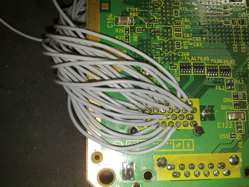

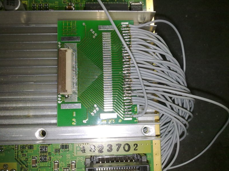

Post by streetuff » Thu May 05, 2011 8:47 pm
hi!
just joined the forums...
got my ffc adapter and wiikey fusion these days and soldered it to my gc today.
unfortunately that brown hinge on the ffc adapter got loose.
did not managed to boot the wiikey fusion yet :/
regards
streetuff
(118.4 KiB) Not downloaded yet
(132.84 KiB) Not downloaded yet
Post by Ashen » Thu May 05, 2011 10:43 pm
Welcome to the forums! Nice soldering job there. What FFC connector is that? Is the hinge broken? Not salvageable at all? :/
Posts: 1814
Post by liquitt » Fri May 06, 2011 4:41 am
i was going to say that, really good soldering job there!
might need your skills in the future :P
since the hinge only locks the cable in there it shouldnt be too hard to fix, e.g. ghettostyle with tape :)
Post by emu_kidid » Fri May 06, 2011 4:51 am
sometimes I've found that when the hinge snaps off completely, it's still good you just have to: Put the flex cable in with no hinge, then carefully wedge the hinge in and hot glue it shut (it's usually a tight fit but the glue makes sure a knock won't put it out of place).
