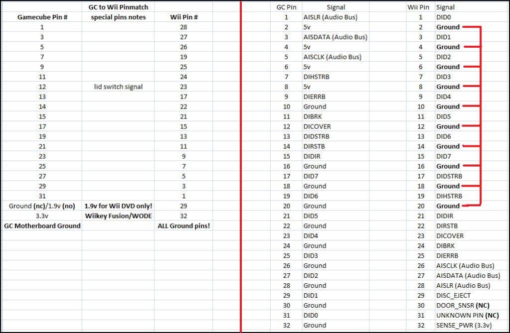

Yes, for the disc swap trick to work on a Wii you would need to install a switch between pin 23 on the Wiikey Fusion and Wii motherboard to toggle the gamecubes lidswitch signal. I can confirm that the disc swap does work on a Wii if you do this.
Ok Ashen. So, in which point on Wii motherboard the on/off switch must be solded???
Thank you for your help.
There is really no good way to do it ON the motherboard itself. You'll need to modify the ribbon cable with pin 23 going to a switch then back to pin 23 to the MB.
Ashen, I think the best way is to cut the contact between pin 23 on Wiikey Fusion board (green mark on image) and to solder an on/off switch between the ribbon cable and the Wiikey Fusion chipset. Of course the on/off switch will be on outside of the Wii.
Follow the scheme:
Will it really works???
Follow the scheme:
Ashen, I have another doubt. The switch on pin 23 of Wiikey Fusion on the "on" position means the Gamecube's lid is opened or closed???
If the "on" position means the lid is opened, I guess is not possible to use a tact switch. So could I really use a tact switch on pin 23 of Wiikey Fusion???
Thx.
Thx.
That looks like a fine way to do it. I'd scratch the trace of that line though, trying to wire right to those pins will end badly. Break the trace in the middle and scrape the blue stuff off and wire to that.
You can use a momentary switch but it needs to be normally closed, just like the pin 29 connection. The original GC lidswitch also works fine.
