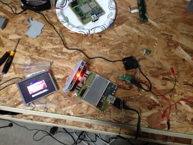

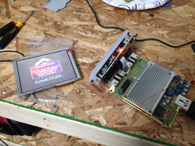

well hard wired my video for the screen tested and worked fine, then tried hard wiring the power, red to + on back of and ground to ground on video pin on mobo, screen turned on, then pop from the the the positive, mobo shut down fan and all, wont turn back on... damn, gotta go buy new gc tomorrow

FAN SHOULD ALWAYS TURN ON
you might have blown the ac adapter only

Okay I will check it out. Is there a way to avoid this next time?
Re: GCP WKF/Worklog
double check your wiring, check continuity, and check again before power up...

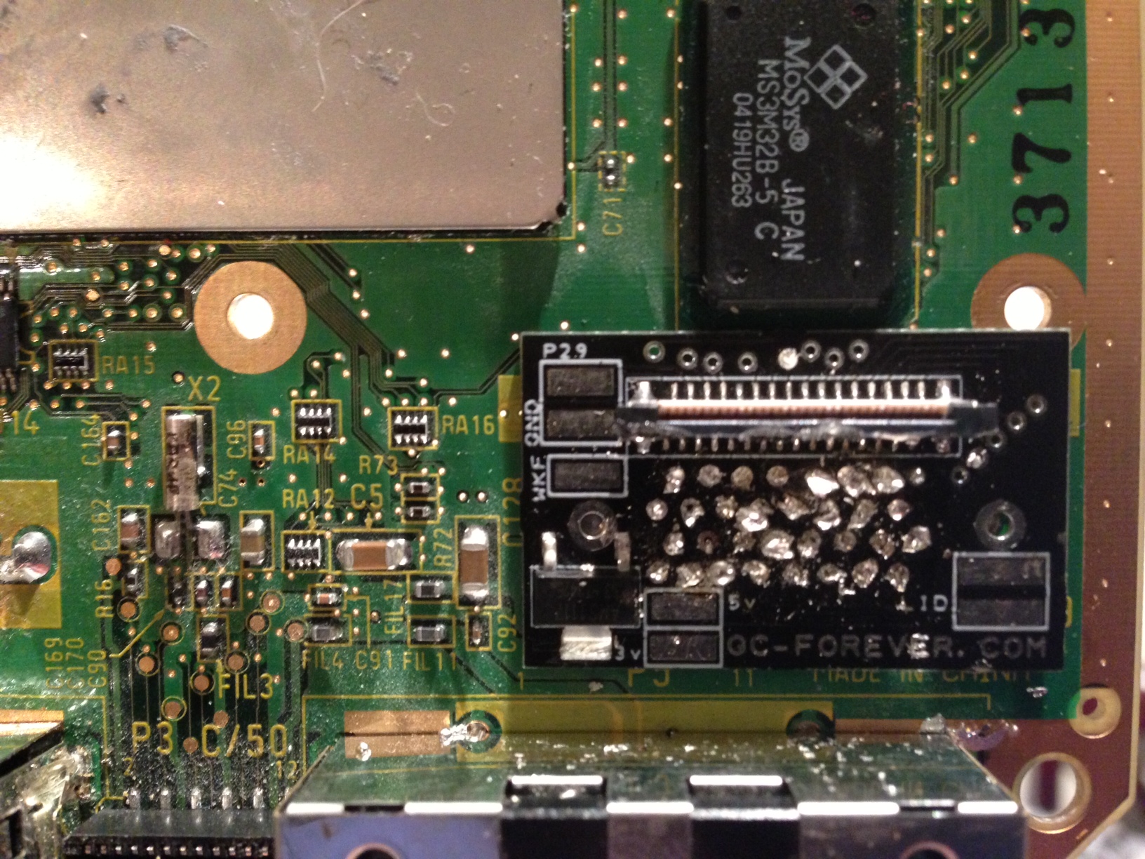

Are the pins from the DVD drive just supposed to fit inside the holes for the mega dr?
Re: GCP WKF/Worklog
yup, it will be harder to fit if you have globs of solder at the pin ends...
just cut the globs and use the clean pin area to fit it right thru...

Ok we'll the way I'm doing it is the clean side of the pins I've got them all trimmed down and straight and going to try in slide it on. Hopefully according to your directions pin 29 goes to top left of motherboard which I'm guessing is toward the power?
- heres the worst solder job in the world still learning!!!
- (794.79 KiB) Not downloaded yet
Re: GCP WKF/Worklog
clean up the solder joints...you want to make sure there are no shorts before powering on the system...
since you are building a portable, you will want to solder the two lid switch wires to each pad marked lid...
then solder your pin29 switch lead to the pad marked pin29
then double check again to be certain none of these solder joints are shorted, then power on the system....

are you soldering for the first time? seems so, and also seems there is no flux anymore. the solder points look realy mat.

Yup first timer here! I'm going to pull it out and redo it as its not up to even my standards ha thanks for the advice man!

maybe you should practice on something else instead rather than waste this beautiful piece of hardware?
