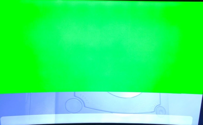

I've encountered a different problem, possible due to my misunderstanding of how boot.dol autolaunch is supposed to work.
For example, I attempted to place the Snes9x GX boot.dol in the root of my SD card, but received this screen on boot with r416.
I need to do more testing, but just had an opportunity to post it (an image of it is attached to my post). It's a green screen partially overlayed over SWISS, and is completely crashed / doesn't allow me to interact.
I am going to come back to the folder freezing shortly and attempt to get more data regarding that, and will probably edit my posts to make the information laid out more concise for each issue.

Posts: 4735
Re: Swiss Nightly Build
Post by emu_kidid » Mon Jul 31, 2017 2:26 am
ochentay4 wrote: "Reboot" its just a reboot or it goes to Swiss Menu?
Also, this should be on the wiki: "The reboot combination is R+Z+B+D-Pad Down"
Reboot is just a hard reboot for now, getting it to load Swiss or a DOL of your choosing will be slightly more difficult and is still a work in progress.
Also, the wiki is for everyone to edit, register and have at it ;)
boktai1000 wrote: I actually do have a BBA connected - there is no exception screen, it just locks up with the last state of SWISS shown and is frozen to any sort of input that requires me to physically get up and reset. So it looks like it's just in the menu like normal, with the directory highlighted that I wanted to go into, except frozen.
I'll see if I can reproduce it and let you know - usually the crash was when trying to go into my games folder which I previously had named "aGames" for sorting alphabetically at the top, and also when I named it "games" all lowercase I think it locked too. I can get exact structure breakdown to you via a PM if I reproduce.
The issue where Swiss hangs is because the BBA is trying to initialise at the same time as you're trying to read from SD card. Wait 10-15 seconds before attempting to browse your SD card and I believe you won't experience any issues with browsing it. I might just have the BBA initialisation block Swiss at startup (and make it optional - off by default).
