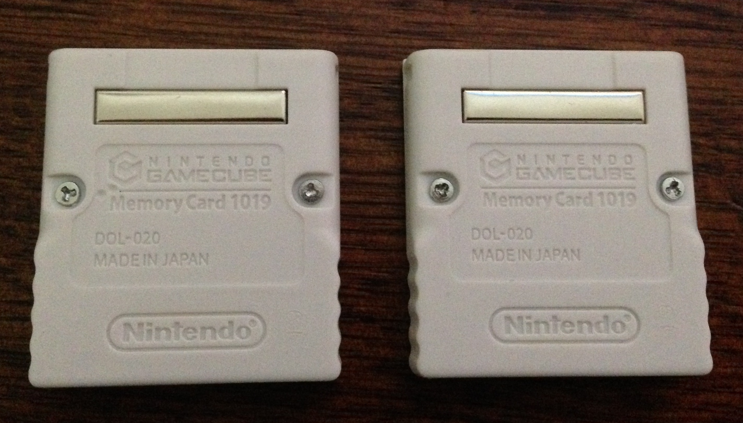

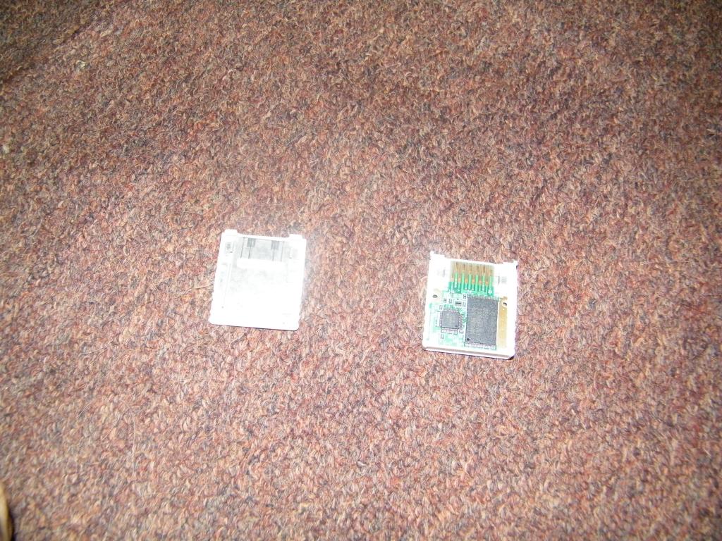

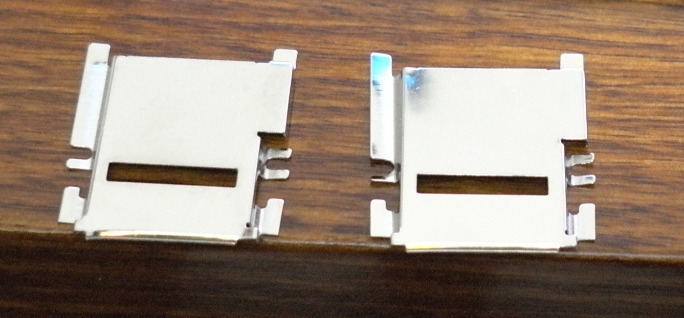

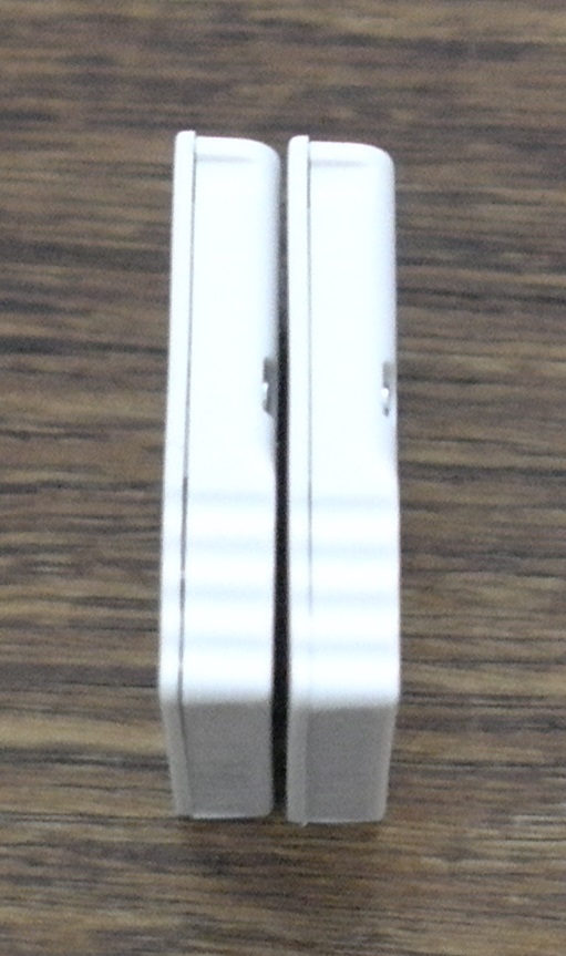

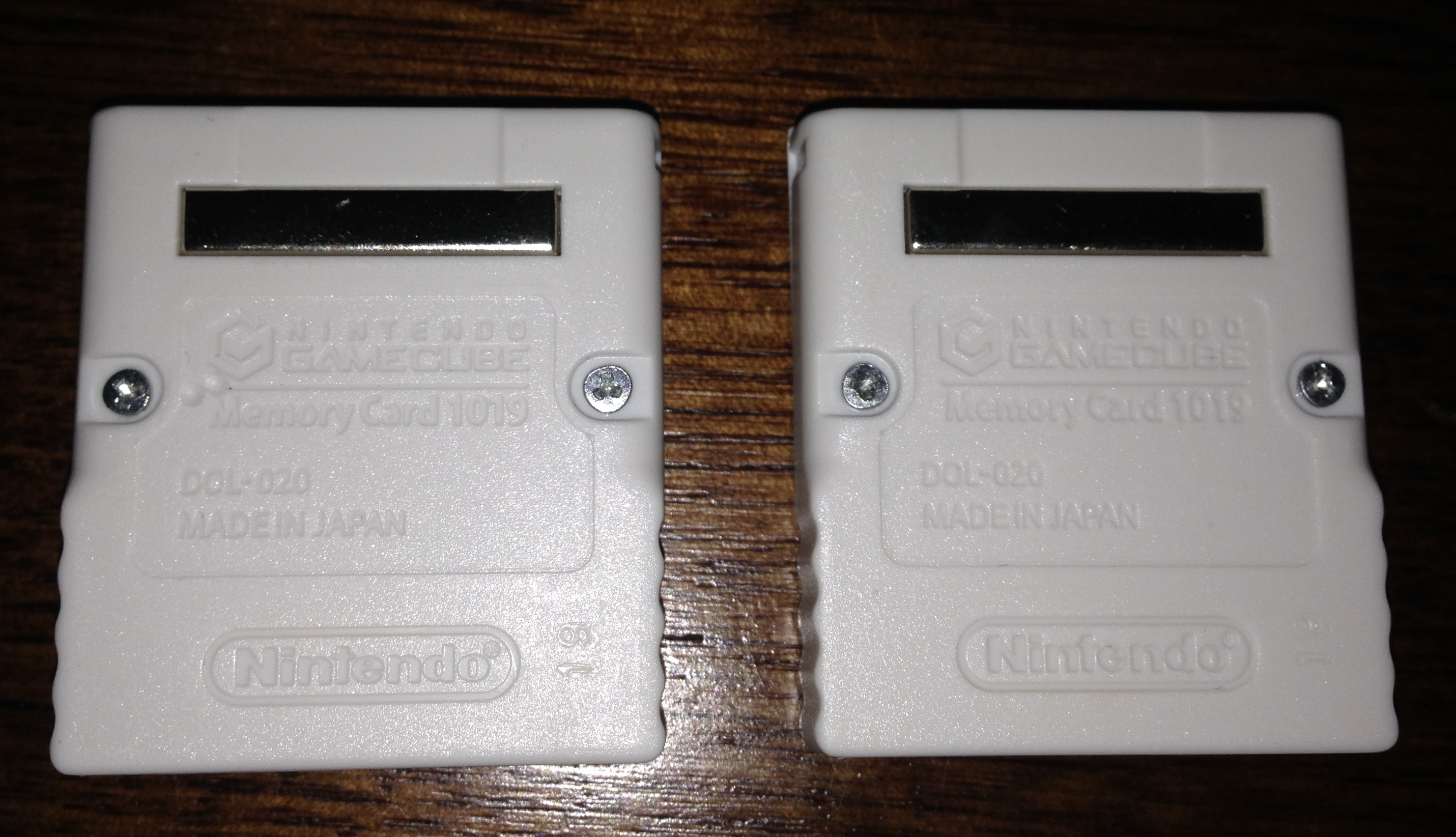

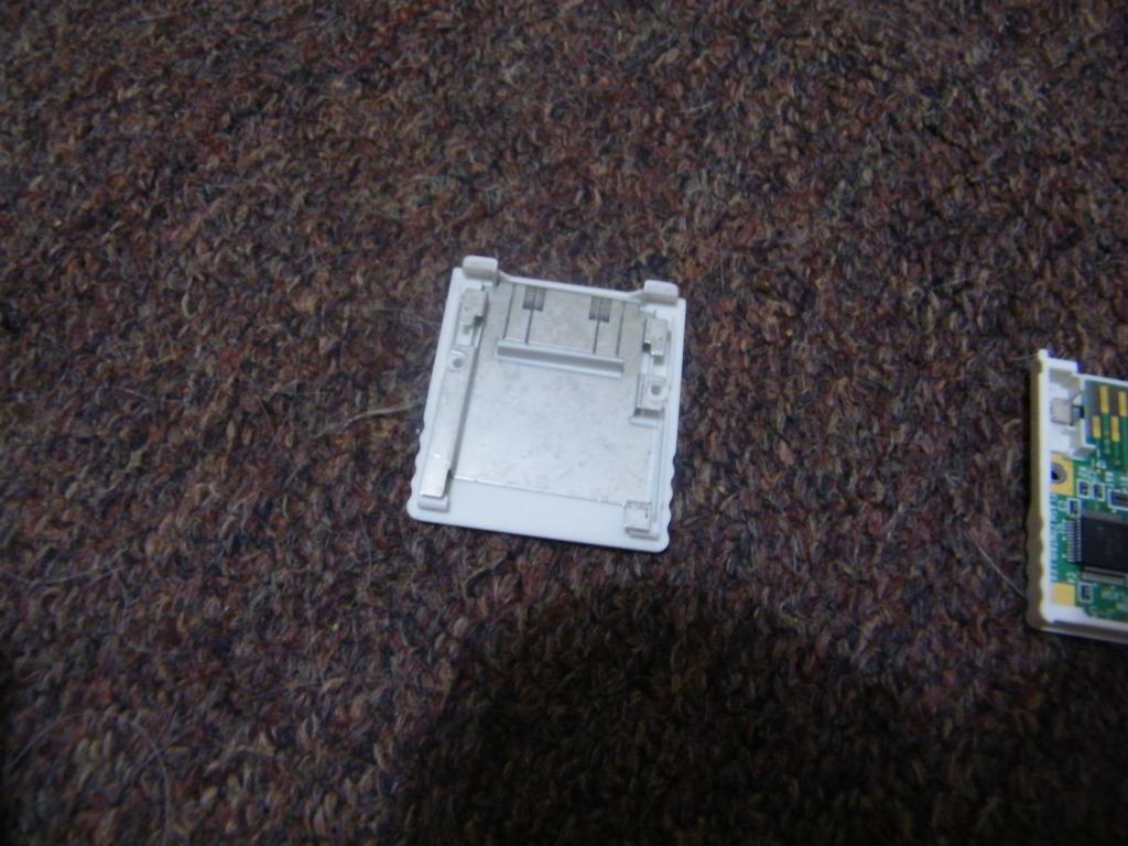

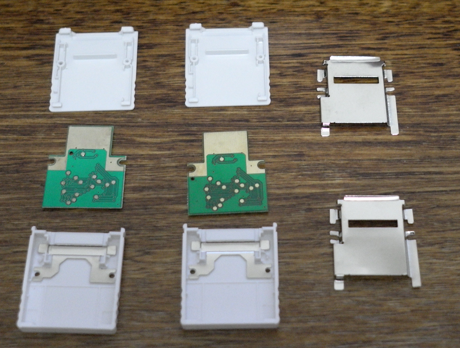

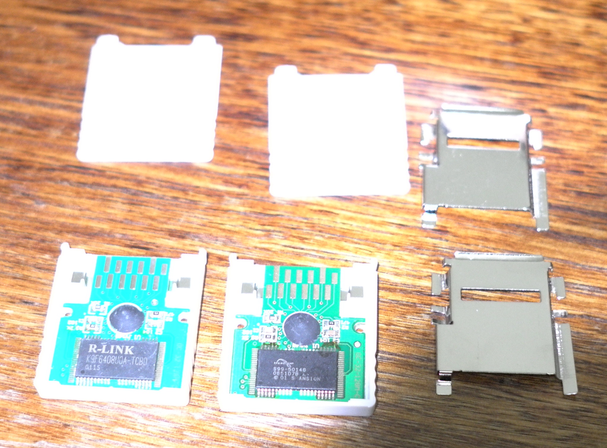

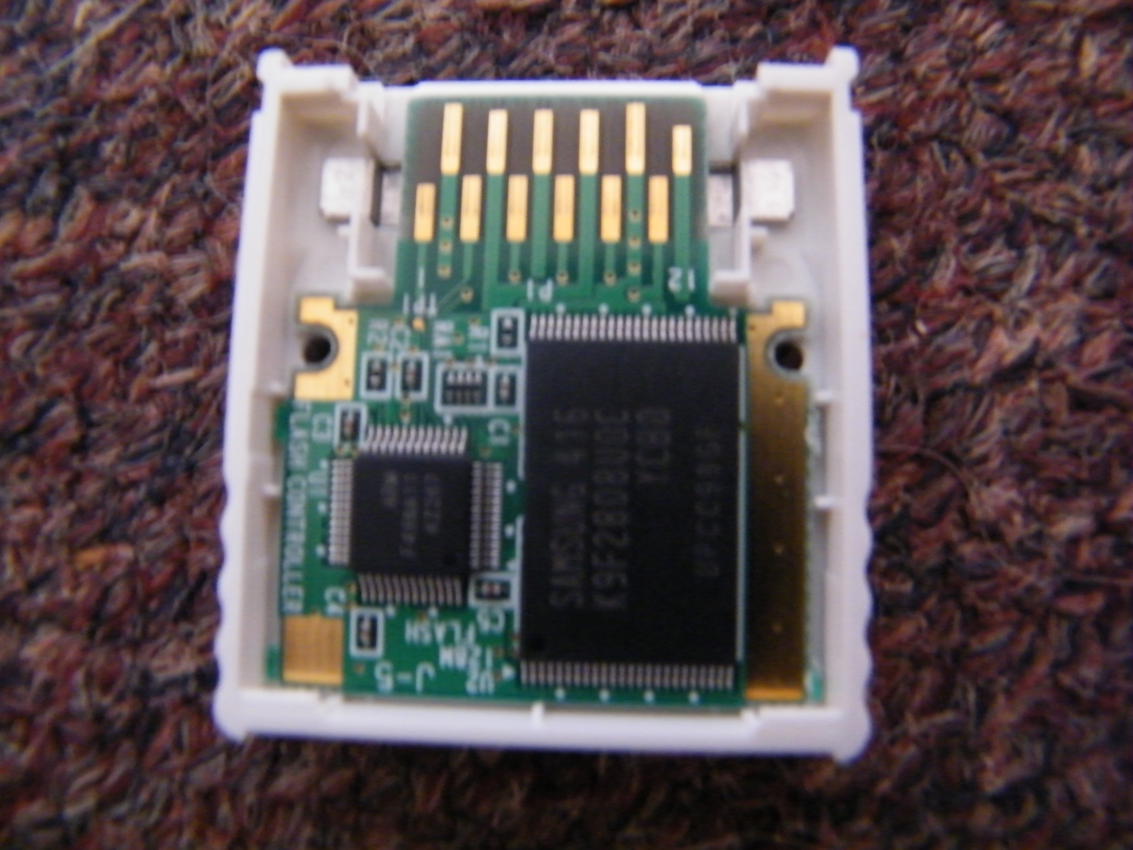

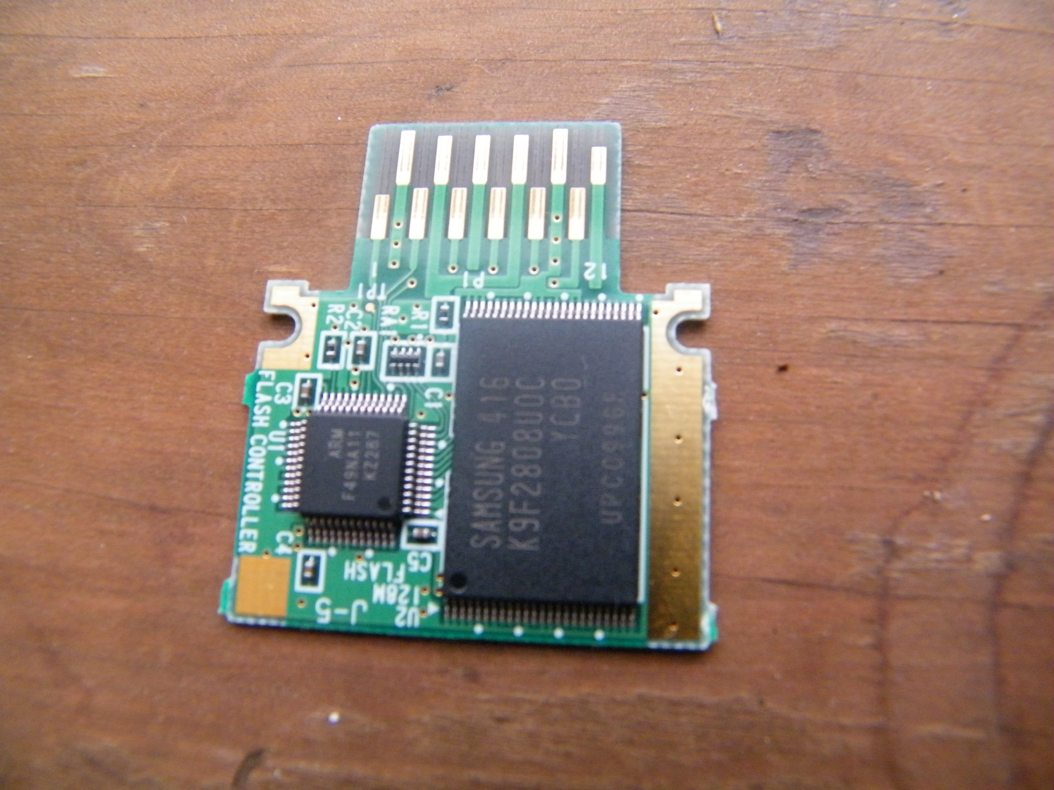

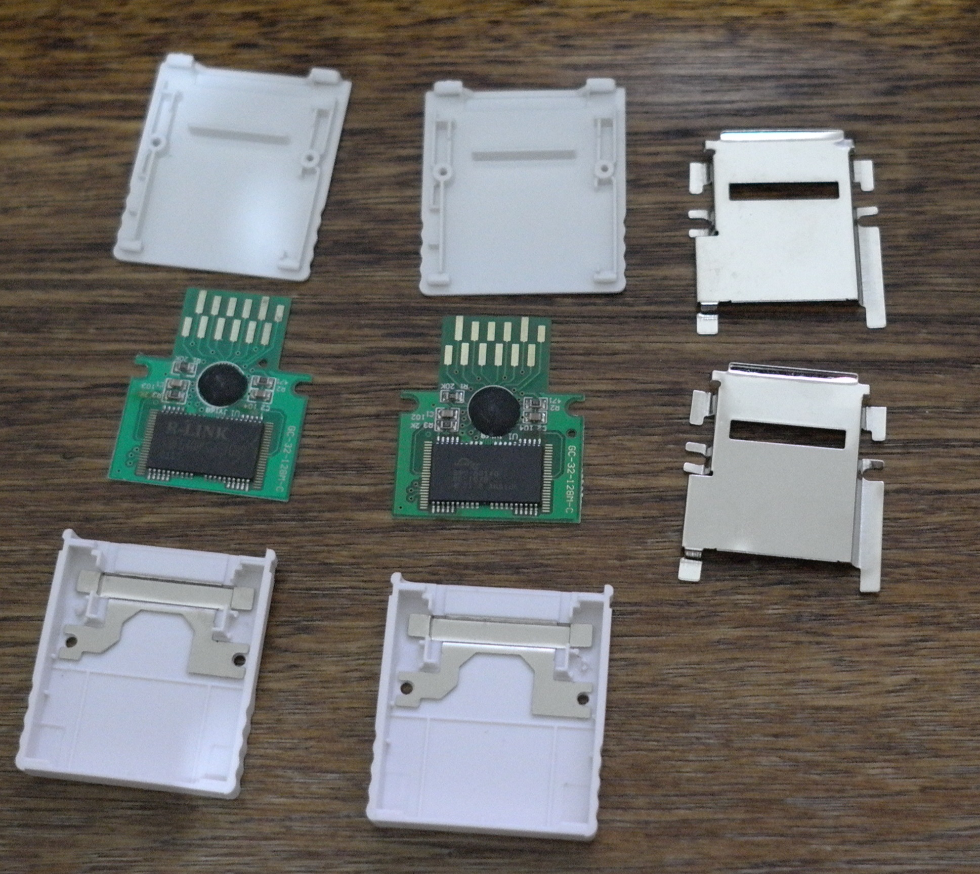

why is fake? see photo. I got 2 and they not even the same chip. lol Anyone who have a real genuine official Nintendo GameCube 1019 memory card. please open it up, take some photo and post it here. Thank you very much.

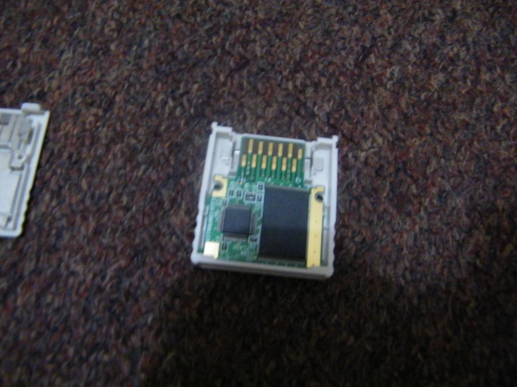

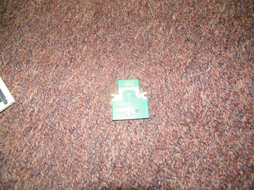

more photo. thanks for watching.
Re: Fake memory card 1019! must have a look! need your help!
With the camera set to 10MP not sure why so blurry.

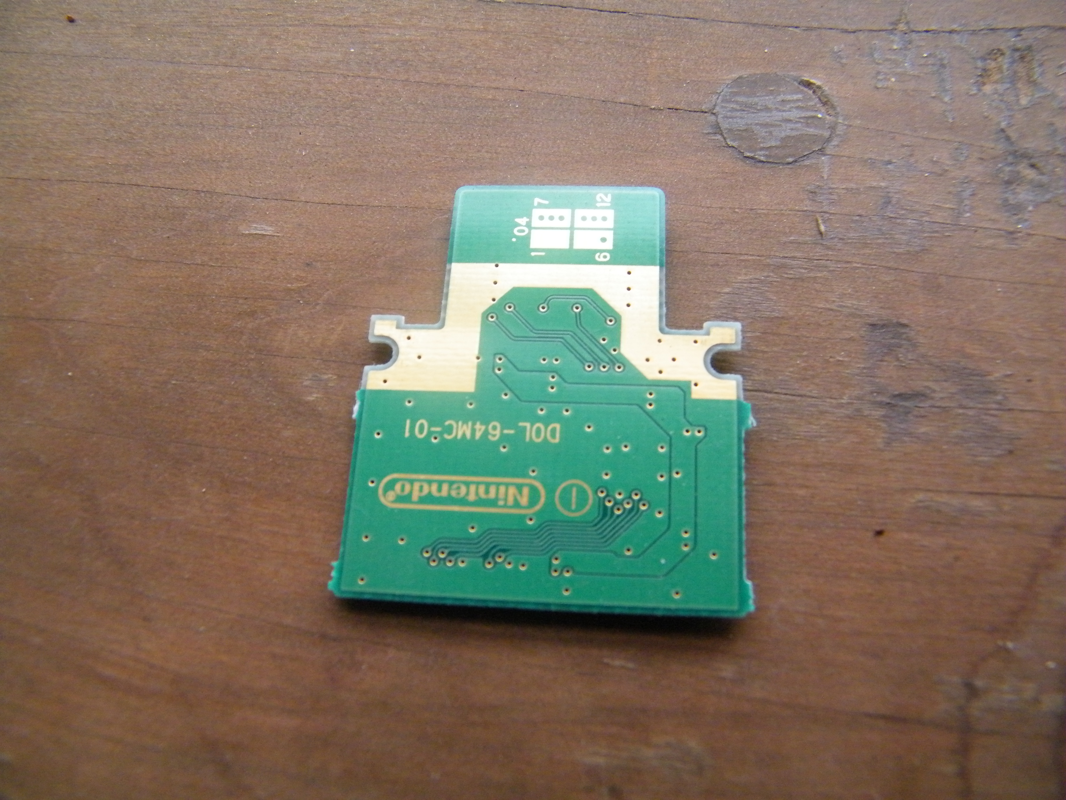

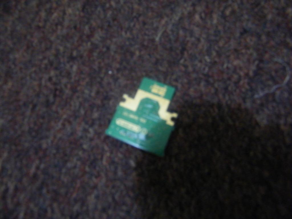

The chip pcb has 'Nintendo' and 'DOL-64MC-01' on it.
Where it plugs in it has 4 rectangles, top left one has one circle on the far left, top right one is blank, and the bottom two have 3 circles, where going clockwise and starting from top-left there is '6', '1', '7', '12', and on the right next to the top right and bottom right ones is '.04'.
On the other sides there is 'FLASH CONTROLLER' written on PCB, and there are 2 chips. The smaller chip has 'ARM' 'F49NA11' 'K2287' and the larger chip has 'SAMSUNG 416' 'K9F2808UOC' 'YCBO' 'UPCC99GF'.

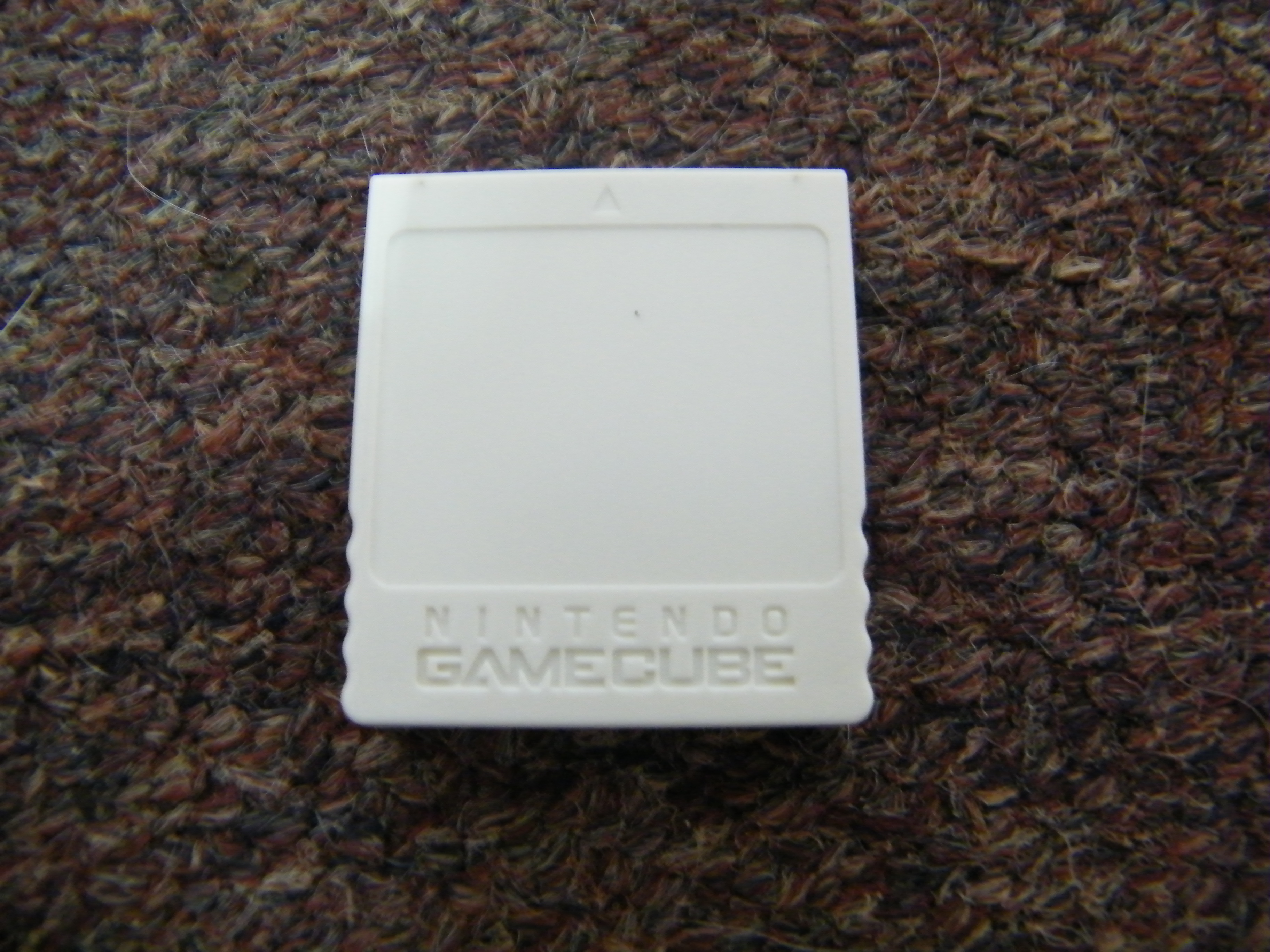

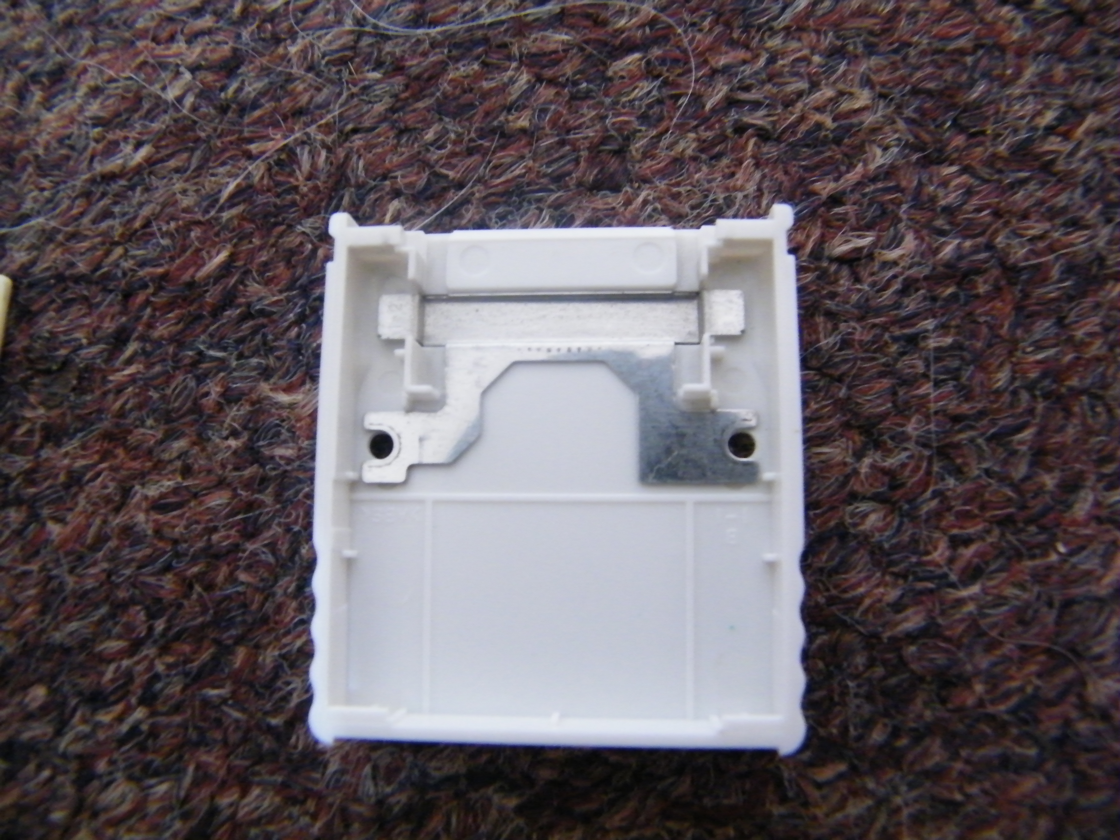

Frontside of mem card is a plastic up arrow at the top and a hollow area for a sticker, and 'NINTENDO GAMECUBE' at the bottom.

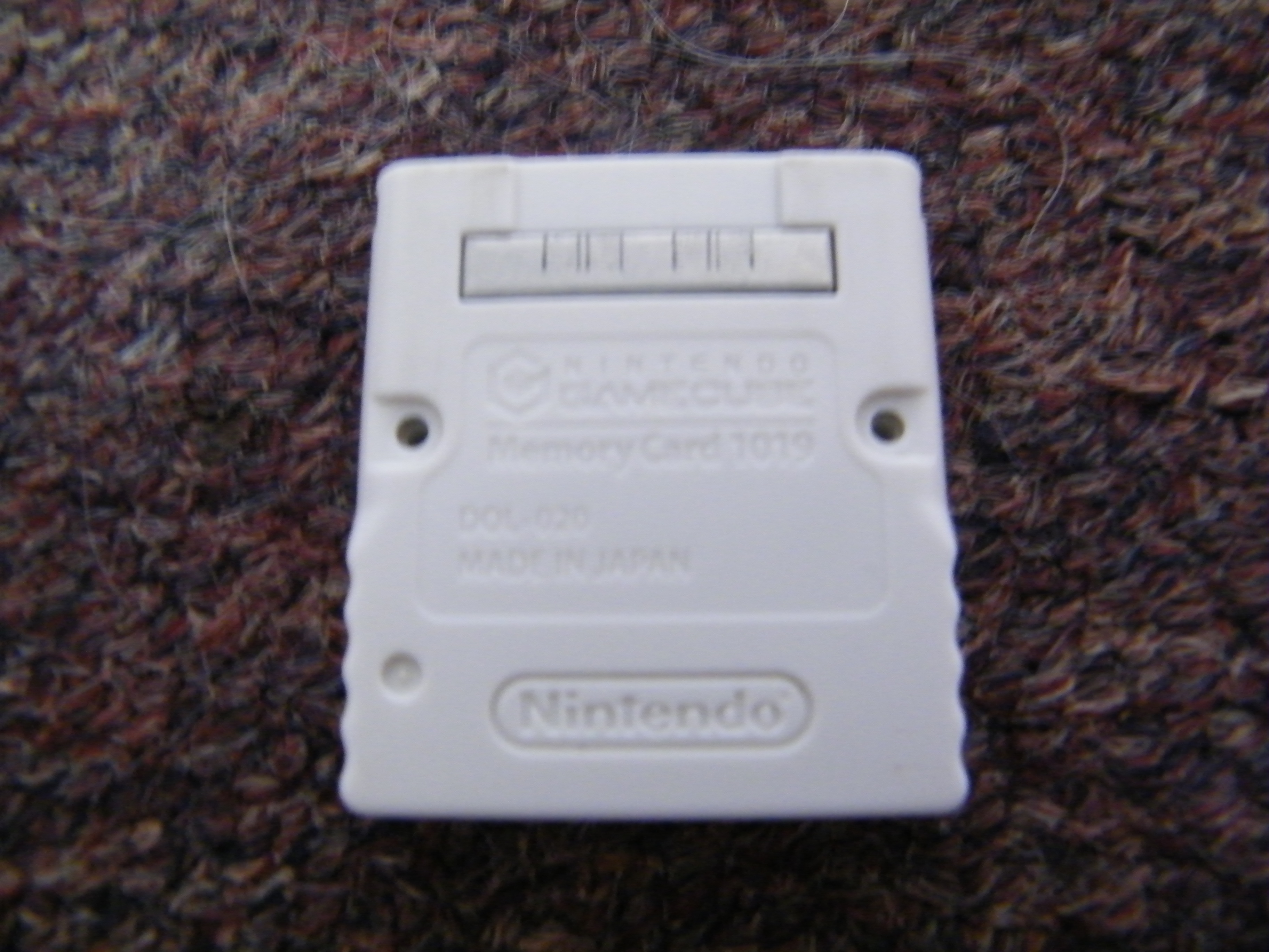

Backside of mem card plastic is 'NINTENDO GAMECUBE' 'Memory Card 1019' 'DOL-020' 'MADE IN JAPAN' 'NINTENDO'.
Photos are too big to attach and didn't allow for split 7z 001 filetype.
- (207.62 KiB) Not downloaded yet
- (52.7 KiB) Not downloaded yet
- (82.94 KiB) Not downloaded yet
- (104.6 KiB) Not downloaded yet
- (199.82 KiB) Not downloaded yet
SEGAdc yours is fake, here is pics from my legit one

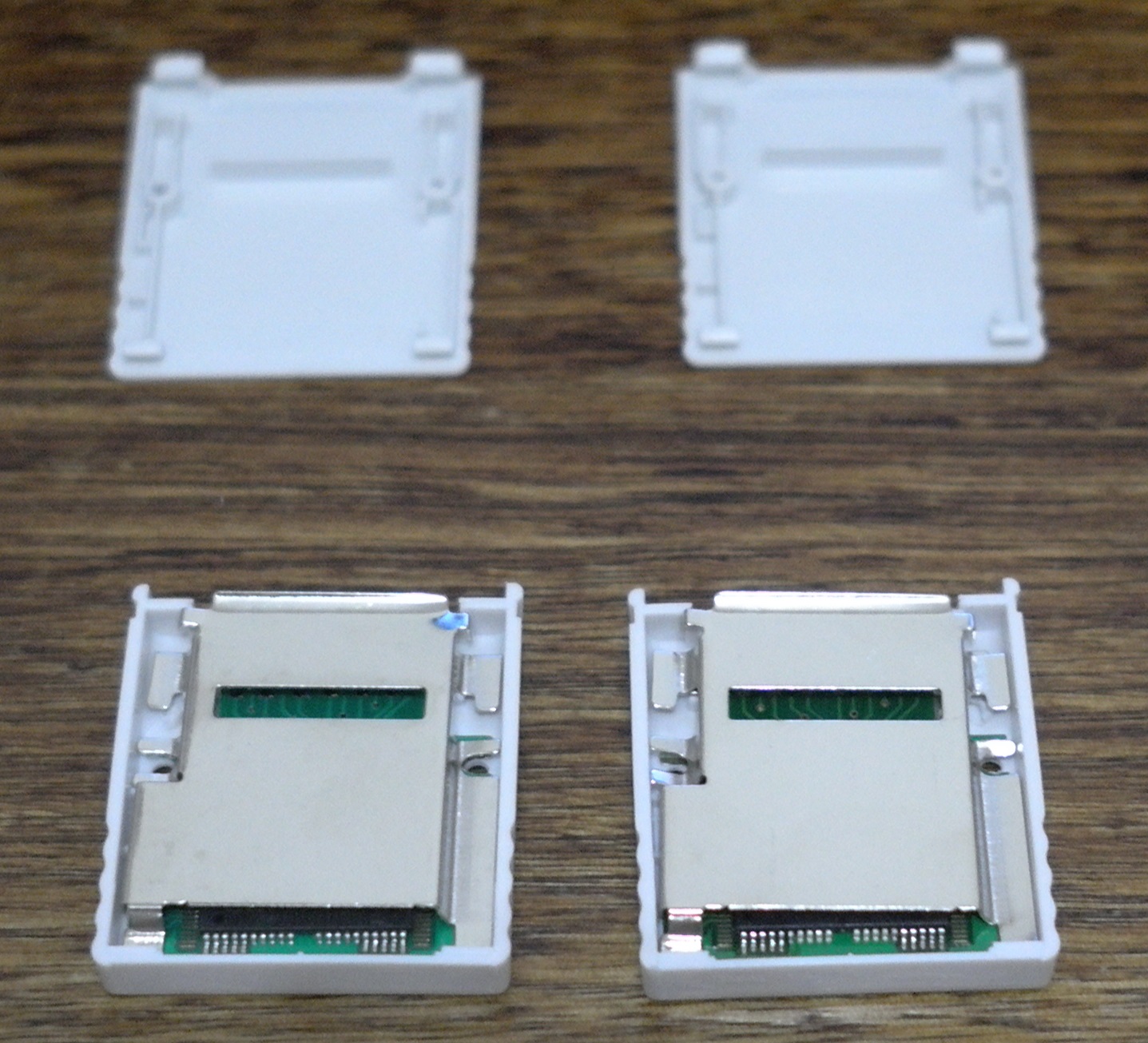

EDIT:
Here.
EDIT:
Here.
- Memory Card Casing Back Inside (with out PCB)
- (1.91 MiB) Not downloaded yet
- Memory Card Casing Back Inside (with PCB)
- (1.74 MiB) Not downloaded yet
- Memory Card Casing Front Inside
- (2.09 MiB) Not downloaded yet
- (1.58 MiB) Not downloaded yet
- (1.83 MiB) Not downloaded yet

More
- PCB Closeup Bottom
- (2.38 MiB) Not downloaded yet
- PCB Closeup Top
- (2.24 MiB) Not downloaded yet

These don't work anymore, can they be reposted?Shadow666 wrote: ↑Sun Aug 17, 2014 12:28 am SEGAdc yours is fake, here is pics from my legit one
https://www.dropbox.com/s/7dh0fv1fkn9mc ... 191953.jpg
https://www.dropbox.com/s/of6hv1svg391a ... 192007.jpg
In my mind I got one of those cards from back in the day from Play-Asia. But it came in this packaging https://www.reddit.com/r/Gamecube/comme ... e_and_now/. Is it confirmed that packaging is a giveaway it's a fake? I don't think I've ever seen the 1019 DOL-20 memory card in a 251 DOL-14 like packaging...? I'll see if I can open it up any time soon.
So what does it need to be a legit memory card?
EDIT:
Guess this helps viewtopic.php?p=47773&hilit=1019#p46405 https://imgur.com/a/1019-fake-card-xZfkUwc
