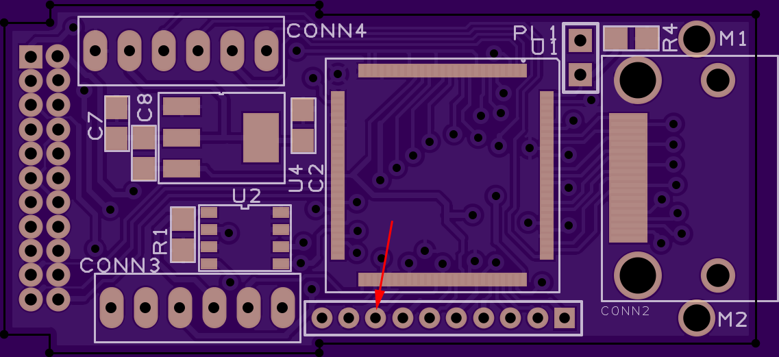

Ok everything is on order including a few other projects that will be on the back burner for now. The pad snoop input is on what pin of the FPGA? I have a picture here of the board from OSH-park. Once I get everything built and working I will share the project on OSH park so no one else has to convert the files to there format just order some if you need to there 11.20usd for 3
Re: Shuriken video v2 build with xc3s200a
This one:andre104623 wrote:The pad snoop input is on what pin of the FPGA?
There:I have a picture here of the board from OSH-park.

Ah ok that was the same spot for the SPDIF output when the XC3S50A was used. Does this also have the SPDIF out as well I mean I won't really be needing it but just nice to know in the futureUnseen wrote:This one:andre104623 wrote:The pad snoop input is on what pin of the FPGA?
I have to admit that I didn't check where SPDIF was on the 3S50 - I just chose the point closest to the Gamecube that was available. SPDIF is also available, if I remember correctly it should be on the square pad closest to the HDMI connector.andre104623 wrote:Ah ok that was the same spot for the SPDIF output when the XC3S50A was used. Does this also have the SPDIF out as well I mean I won't really be needing it but just nice to know in the future

Ok cool thanks unseen. I thought it was 8 pin on the spare but just wanted to make sureUnseen wrote:I have to admit that I didn't check where SPDIF was on the 3S50 - I just chose the point closest to the Gamecube that was available. SPDIF is also available, if I remember correctly it should be on the square pad closest to the HDMI connector.andre104623 wrote:Ah ok that was the same spot for the SPDIF output when the XC3S50A was used. Does this also have the SPDIF out as well I mean I won't really be needing it but just nice to know in the future

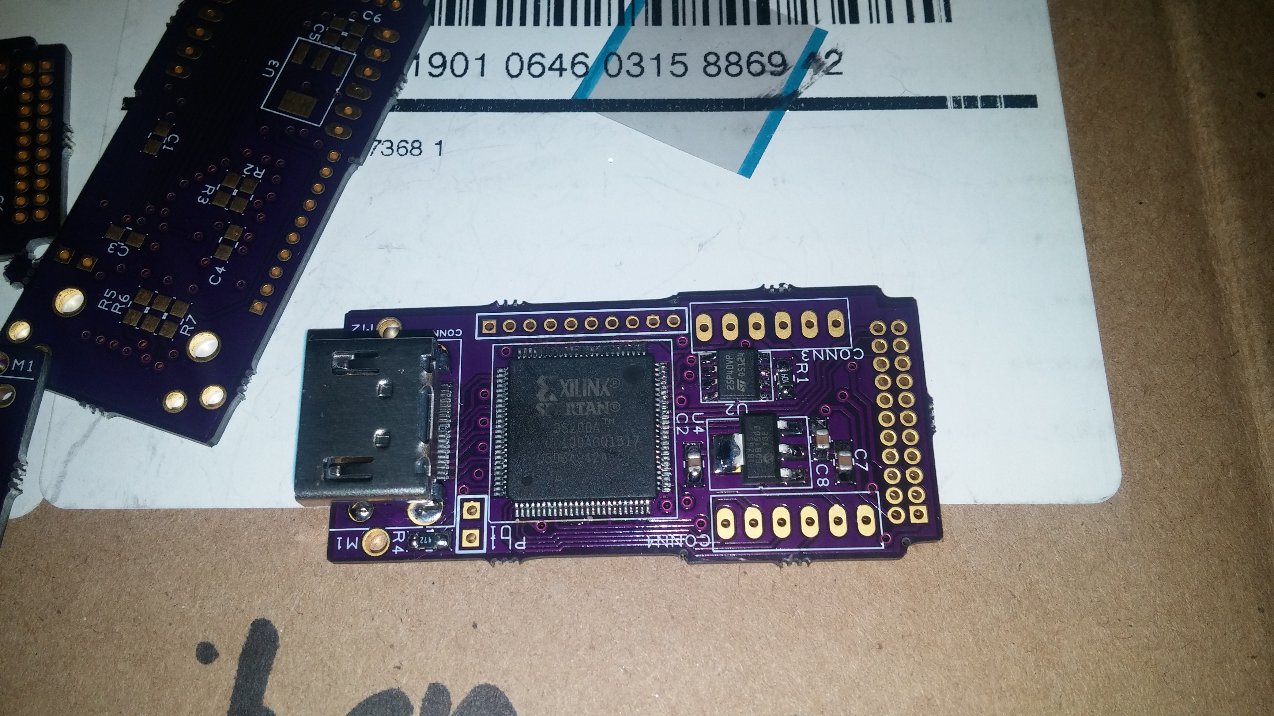

The shuriken video V2 is back from the fab and look good I got done building 3 gcvideo-lite board and 3 Shuriken video V2 with xc3s200a FPGA I have 6 more blank PCBs of both lite version and Shuriken video V2 so if anyone would like one send me a PM. The lite version is on hold right now becuase my programmer is having issues flashing the lattice FPGA so I ordered a programmer. One more week for the lite version but the Shuriken video works like a charm OSD and all. I made the Shuriken video v1 and v2 a shared projects on OSHPARK so just look them up if you would like to build them yourself

what value are C7 and C8 ? it looks like 100nF, this is from my website
Note: C7 should be 4.7uF and C8 should be 1uF both tantalum type caps to reduce noise.
I would really recommend you use those values as they are stated in the datasheet for that vreg (1206 size should fit 16V will do).

Ok i will do that. I have to be honest its been a while since I visited the website. I'll order the caps tonight from digikey. I havent hooked up the spdif output and i havent had any problems so far only tested it for a few hours seems to be working fine no artifacts or unwanted noise.happy_bunny wrote:what value are C7 and C8 ? it looks like 100nF, this is from my website

Sorry guys been busy. But the Shuriken video v2 is confirmed working perfectly with or without the higher rated caps doesnt seem to make any change. So I have 3 ready to go and with finish the other 3 when the first batch is gone then I will be done with this project at this time. Maybe i will make others if people really want more
