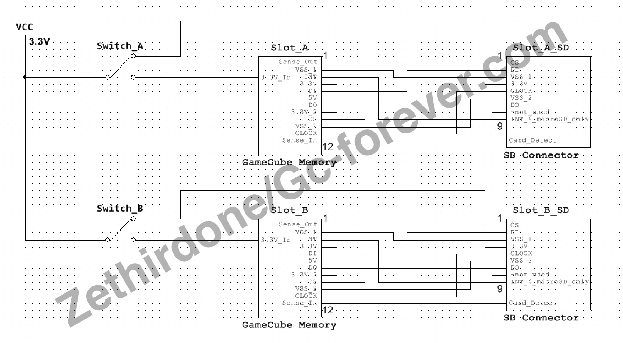

Don't answer all at the same time! I did a schematic on my free time to explain how I would proceed.
- This has not been tested
- (343.68 KiB) Not downloaded yet
I would cut the vcc trace that go to each memory slot, and would power them with a 1P2T switch to choose if I want to power the front slot or the sd adapter. From what I understood from my SD connector, the card detect pin return the vcc signal if a card is inserted and the sense in(pin 12) is expecting 3.3v(high level) when a device is connected. My only incertitude is because a card is still inserted in the front slot, all the signals are merged together, but the front card is not powered. I think that it would not interfer with the SD adapter but i'm not sure. If it is the case I would need to use something like a 8 poles double throw switch to break all signal from SD and memory Slot.
Re: SDgecko DIY slot inside gamecube
Posted: Sat Apr 02, 2016 9:34 pm
by novenary
You won't need the SD gecko in slot A. You don't need a power switch either, just have the SD card sense switch short sense in/out on the GC when a card is present.
Posted: Sat Apr 02, 2016 9:45 pm
by zethirdone
So only one card in slot B is use, but I want to leave both card inserted and only switch from sd to memory card when I desire, leaving both connected at the same time on the same pin, the GC would send data to both and also read from both(would make probably errors). But I understand what you want to suggest me is simply insert SD and Remove memory card or the opposite.
Posted: Sun Apr 03, 2016 2:34 pm
by Aurelio
Apply the switch to the CS pins, not the 3.3v line
Posted: Sun Apr 03, 2016 2:49 pm
by novenary
CS is active low.
Posted: Sun Apr 03, 2016 3:30 pm
by zethirdone
Aurelio wrote:Apply the switch to the CS pins, not the 3.3v line
I thought to use the chip select signal, but if I break only CS and and the front slot is selected with the switch with no card inside, sense will still be HIGH from the sd card detect. That's why I thought cutting the power to one or the other would make appear them as disconnect.
Streetwalker wrote:CS is active low.
Good to know.
On the other end, two pull up resistor to each CS pin and break it with a 2p2t switch, I could use at the same time the same switch on my sense signal to avoid detecting a card on the other slot.
What do you think?
