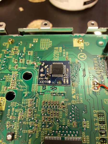

Can we see your solder work? Might have a dying laser. What was the potentiometer set to when you got it and what did you set it to?

Post by Seniorcelica » Sat Dec 02, 2017 1:35 am
She's all back together but solder is good as I've done lots and lots.. wanna say it was 400 ish went down to 120 ish

Post by boredomca » Sat Dec 02, 2017 2:44 am
Nice work there, looks pretty clean. I prefer and recommend the wire install, less of a chance of shorts.
I would also recommend pot at around 180, 150 minimum but I've read on here about one guy saying 80 was the only setting that worked for him.
I've had the same problem you currently have, both multimeters I own couldn't pick up any short and all the leads tested fine. Resoldered and it worked so that's worth a shot although your soldering looks on point

Your soldering would have nothing to do with it because the Xeno isn't even required once the drive code has been uploaded at boot time (unless if you open/close the lid and the drive resets itself), so even if you had an intermittent connection as long as it can patch the drive you're fine.
