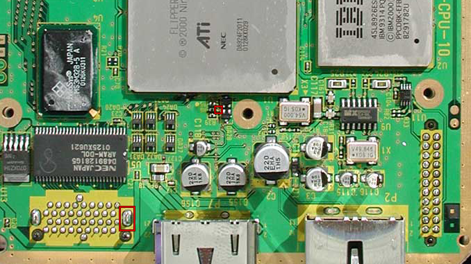

I do still want a permanent solution though. The region switch resource you provided was helpful. In reading the document and referencing the region switch docs on the gc-forever wiki I realized a solution that should bypass the issue on NTSC-J DOL-001 models when using the through-holes. The wiki states that the GameCube reads the sense signal for 3.3v for NTSC-J and 0v for NTSC-U. In my circumstance I only need to attach the switch from the incoming sense by R6 to ground to switch to NTSC-U as as the default sense is high on NTSC-J. I ended up using the center-aligned through-hole by R6 and connecting it to the large ground pin on the hi-speed port by the component video output. Since I avoid the other "top" through-hole which has, from my understanding, inconsistent voltage, there should not and has not been any issues with video (using GCVideo).
My solution uses the ground contact and through-hole pictured below. I find this solution (for NTSC-J) to be easier to solder as there is only 1 tiny solder point which relieves the stress of not accidentally desoldering the other joint if you have a "beefy" tip. Every time I go to do this mod I forget how absurdly small these components and contacts are.
NOTE: There are known issues when using component video with the hole method on a Japanese system. This is due to the fact that the top hole used also runs to ground.

Just to chime in, but I screwed up half a NTSC-J region switch mod and eventually found this thread while searching about how to remedy my mistake. I got the first wire to successfully attach to one of R6's solder pads, but wasn't able to attach the second one correctly due to a thorough bungling and burning of the remaining pad on my part.
Very fortunately, soldering the remaining wire to the large ground pin on the hi-speed port per this alternative reg. switch method saved my bacon and my switch was able to function because of it; it was leagues easier attaching my second wire to something as big and isolated as that ground pin is. Thank you dearly for brainstorming this method, StarkNebula!
