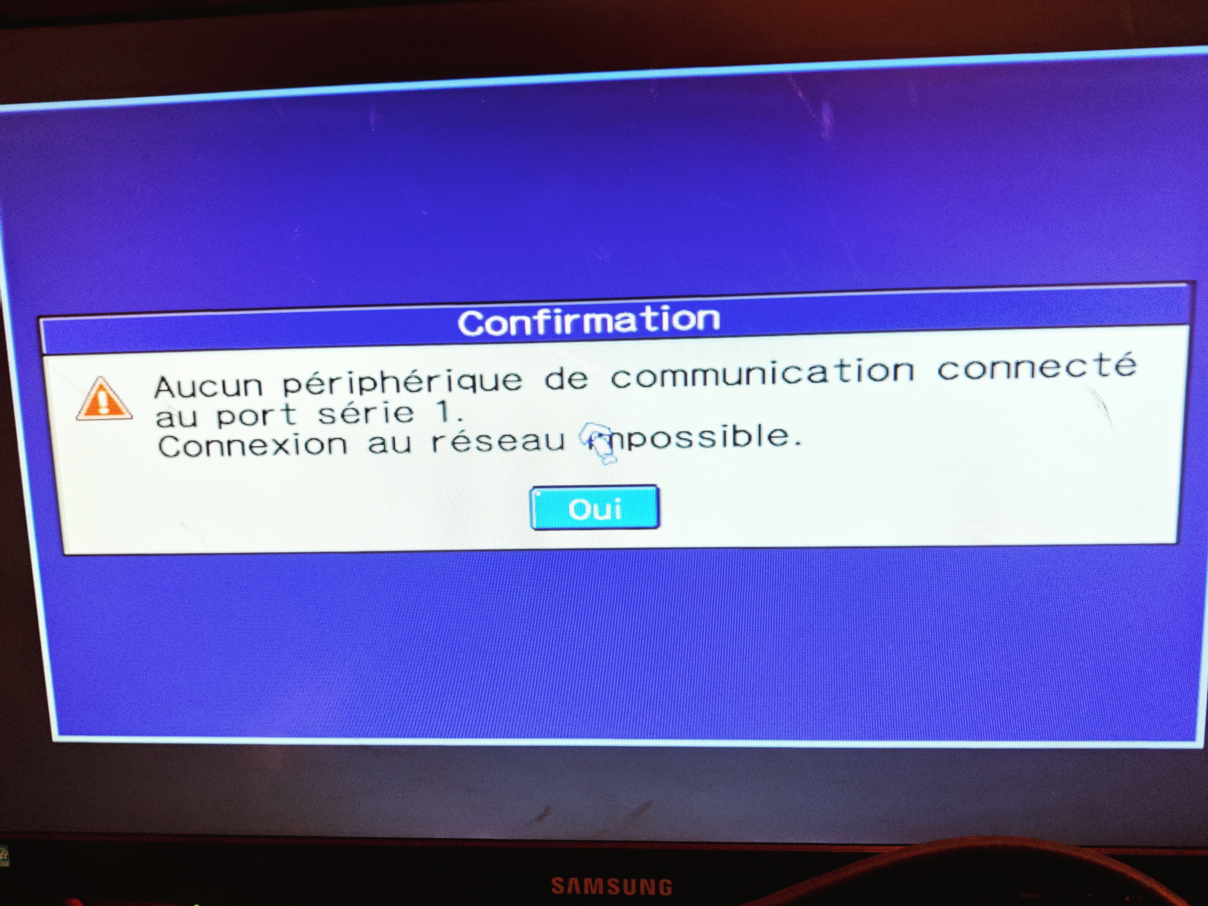

hello everyone, here I explain my problem, i have a GameCube with swiss installer and i have the eth2gc device to play online phantasy star v1 & 2 but here is impossible to connect. is there a manipulation to do to configure the network because the GameCube tells me that there is no network device.... everything is connected well.... Thank you very much see you soon

Hello and Welcome, how is this device attached to your GC?
I personally bought two ETH2GC in the memory card slot flavour off Alix, and can tell you the 3D printing is of the lamest quality I've ever seen! You may have to grind it a little so it can get all the way inside and raise the contacts in the deep. Also, check for the PCB width, because if it's more than expected, it can damage your console's slots, and prevent the exposed tracks to get close enough to the spring contacts.
Then, check in SWISS to see what's wrong, it should confirm the peripheral issue, check for BBA emulation setting too.

Re bonsoir vous avez raison.
Avez-vous une idée de comment l'activer ?
Impossible de mettre en "yes"
