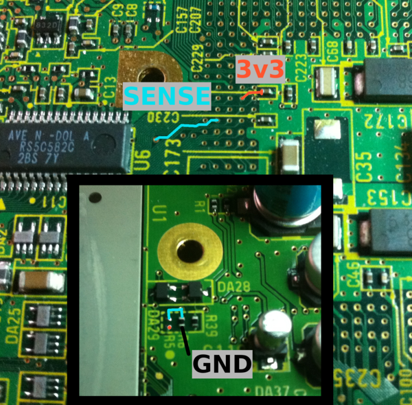

== How it works ==
[[File:REGION_MOD_FLIPPER.png|thumb|600px|alt=Alternate|''Sense, 3v3 and GND shown from Top and Bottom view of Mainboard'']]
The trace shown in blue is for Region Sense. When 3v3 is detected on Sense then GameCube is set for NTSC-J region. When 0v is detected on Sense then GameCube is set for NTSC-U.<br><br>
*To convert an NTSC-J GameCube to NTSC-U, Sense is simply shorted to GND along R6.
*To convert an NTSC-U Gamecube to NTSC-J, Sense is simply provided 3v3 along R5.<br><br>
<small>NOTE: 3v3 shown for illustration only and can be provided from any 3v3 location to Sense</small>

How it works
Alternate
  • To convert an NTSC-J GameCube to NTSC-U, Sense is simply shorted to GND along R6.
  • To convert an NTSC-U Gamecube to NTSC-J, Sense is simply provided 3v3 along R5.
