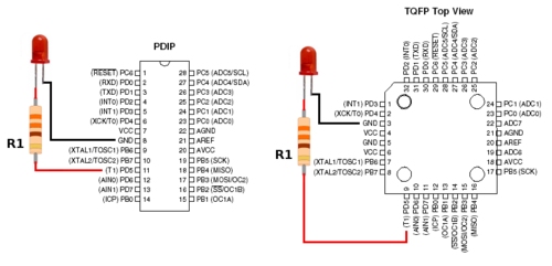

The foundation for Xeno Fusion is based upon basic LED connectivity.
The diagram in figure 1 shows an LED connected to an Atmega8 (XenoGC) at pin PD5 and GND. Current flows from the anode to the cathode and a resistor is used for current limiting protection.
fig. 1
Atmega8L (XenoGC) operates at 3.3v and will deliver up to 3.3v @ 40mA output per pin.
If an LED is rated at 2.0v forward voltage with up to 20mA forward current, then a current-limiting resistor value of 220ohms will provide 5.9mA of operational current which is under 20mA of forward current allowing a safe operation condition for the LED. Also the current-limiting resistor creates a 1.3v voltage drop.
current = (( supply voltage - forward voltage ) / resistor value ) * 1000
current = (( 3.3v - 2v ) / 220 ohm) * 1000
current = (( 1.3v ) / 220ohm) * 1000
current = (( 0.0059 ) * 1000
current = 5.9 mA
voltage drop = resistance * current
voltage drop = 220ohm * 5.9 mA
voltage drop = ~ 1.3v
