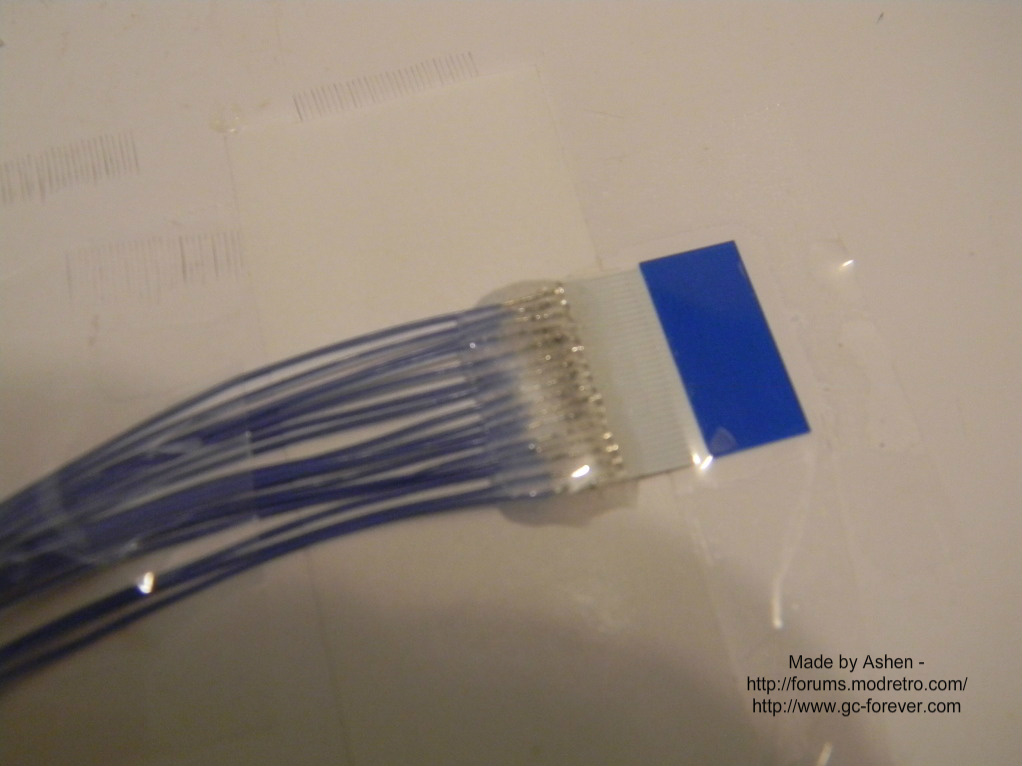

3. (DVD/Wiikey/WODE) The third option is to solder directly to the ribbon cable leads. This can be very precarious work and for long term use may not be reliable depending on your soldering skills. However it is do'able. The easiest way I found is to split every lead on one end of the ribbon cable with a razor blade and fold every other lead back to avoid bridging. Hold the bent back leads in place with some double sided tape placed beneath them. Tinning the leads before hand should aid in making a proper connection. The leads on the ribbon cable are very easy to burn through so make sure you use as little heat and contact time as necessary with your soldering iron. After confirming continuity on all pins covering the soldered end of the ribbon cable in hot glue or epoxy is recommended to avoid future broken connections. Here is an example of this method:
