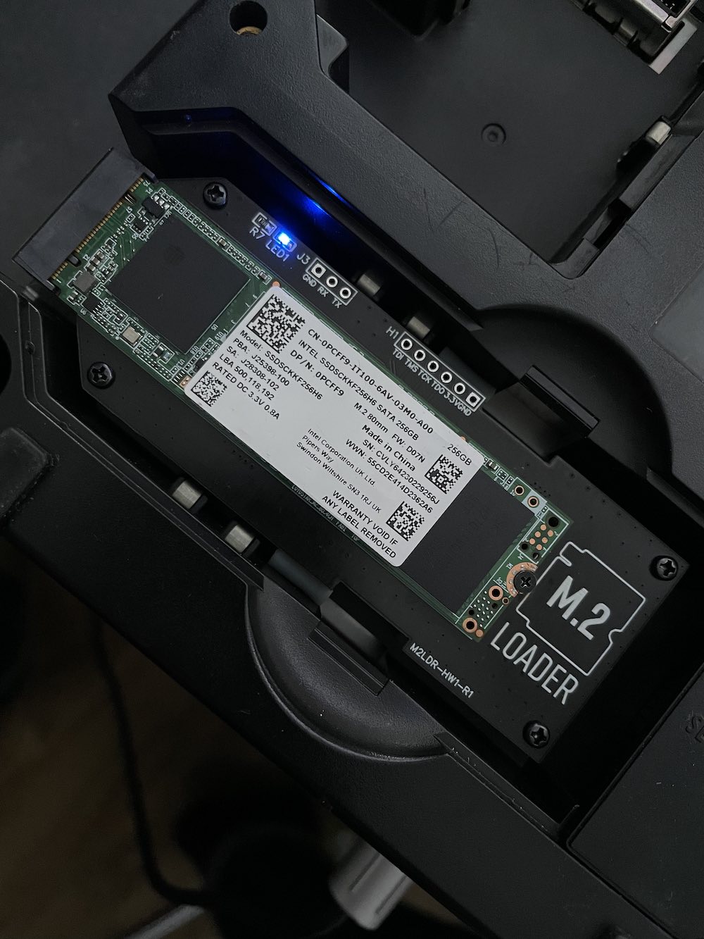

It works! Extrems did all the needed changes to Swiss in order to provide support for IDE-EXI over Serial Port 1 so he is the real hero. He did that without having the hardware and it worked first try.
There are some issues with the board but I'd say pretty minor:
- wrong M.2 footprint
- I used some thick tracks for 3.3V line but I need to make a huge plane instead to give the linear regulator enough surface to dissipate the heat (it gets burning hot right now)
I will make another revision next week which should fix both issues.

Here is the new board revision. I had to change linear regulator used previously, it was generating a lot of heat. New switching power regulator supplies 3.3V@2A from 12V rail
The thermals are under control now. I kinda love the matte black finish, in black Cube it gives that stealthy look. I'm looking for a black SSD next
BTW. Extrems updated Not64 to be compatible with M.2 Loader. Need to test it soon.
