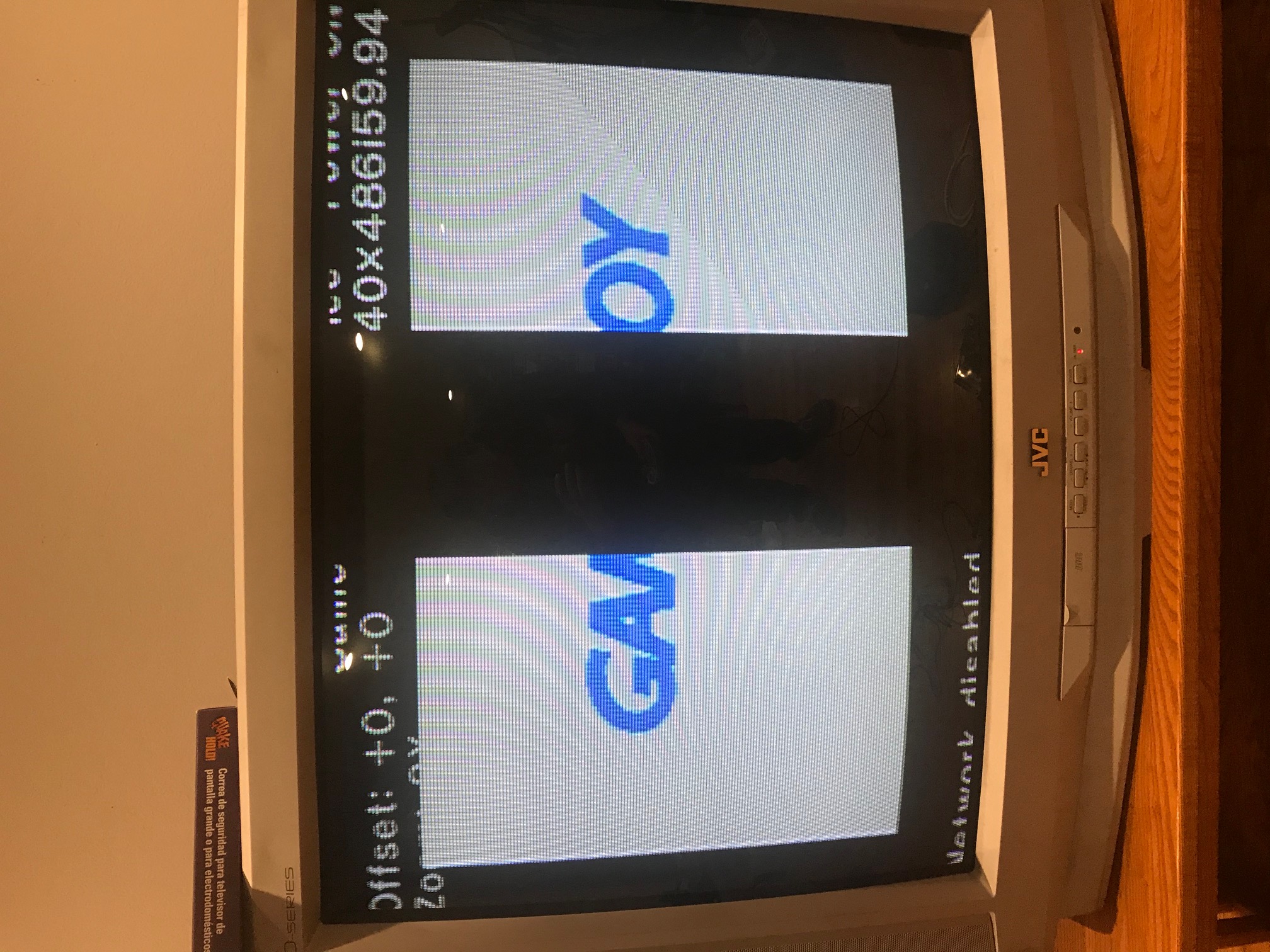

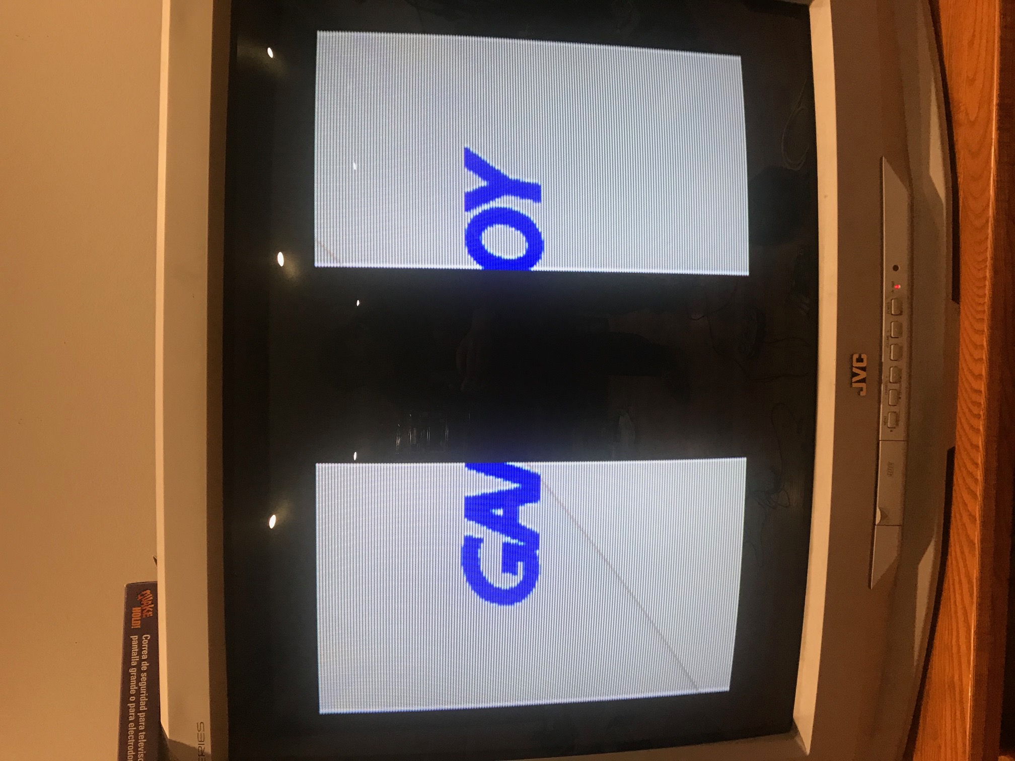

I am trying to use the GBI on my JVC D series CRT with Carby Component cables. I am using the Action Replay and SD card loader, swiss r756, gbi 20191107.
SR mode looks awesome, but both the other modes have a huge black bar in the middle of the screen.

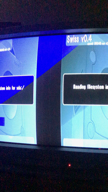

Also, and maybe related, when I boot Swiss a very brief split screen appears (maybe 1/10th of a second), before it flashes and fixes itself.

This is GCVideo's blanking regeneration at work. You bought a defective product.

Extrems wrote: Wed Jan 08, 2020 5:10 am This is GCVideo's blanking regeneration at work. You bought a defective product.
Thanks for the quick reply! Are you saying that my Carby Component is defective, or all Carby Component will behave this way?
Thanks!
Extrems
Posts: 1369
Location: Québec, Canada
Re: Game Boy Interface Huge Vertical Black Bar
Post by Extrems » Wed Jan 08, 2020 5:17 am
All Carby Component Cables will behave this way.
