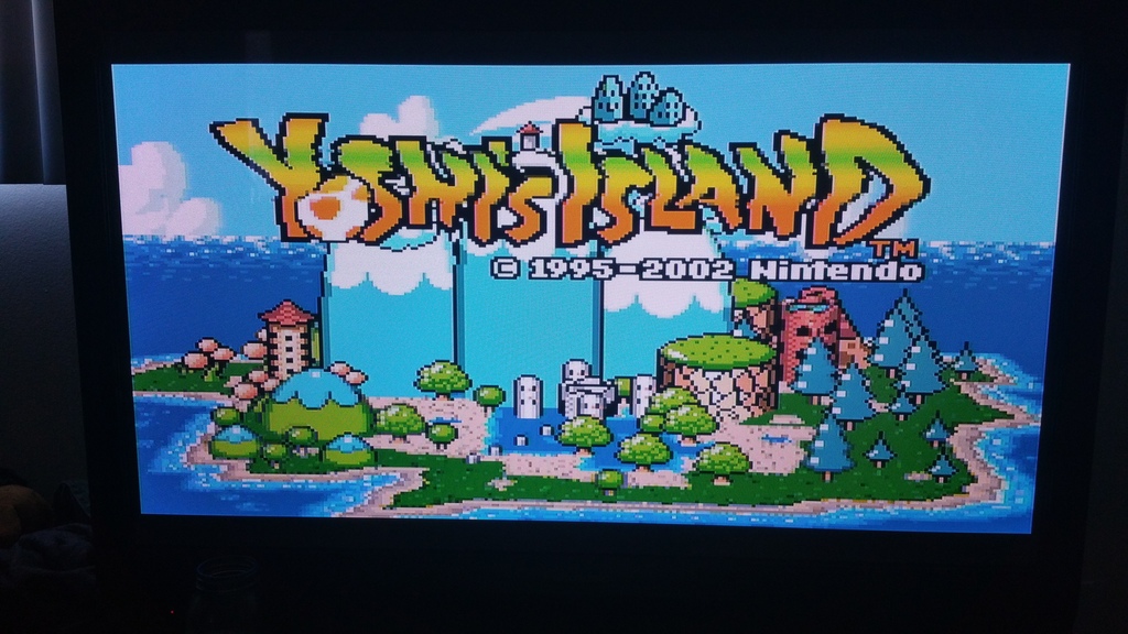

I finally performed the HDMI mod on my GC. Here is GBI on my 50" plasma (GBI loaded off of my Max Drive Pro) zoomed at 2.5X:
