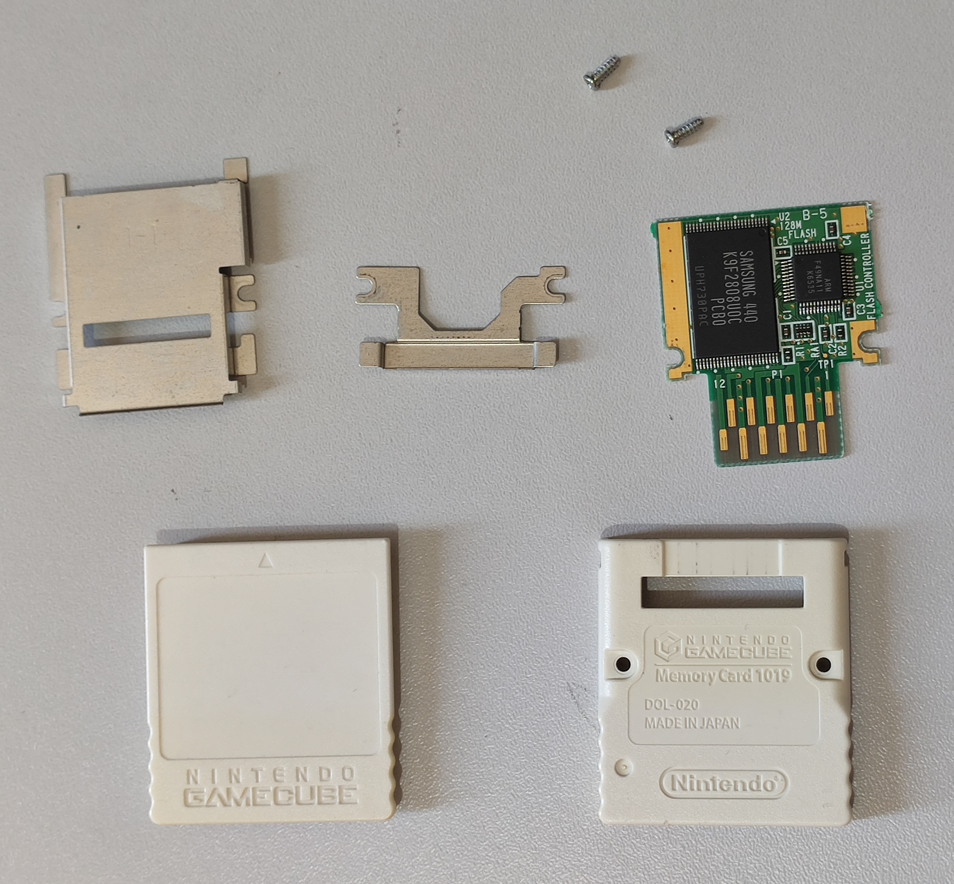

Here are some pictures of my
1019 memory card, for comparison purposes. Btw, the plastic shell is strong and sturdy.

Here is my card. Is also slower than my Big Ben 1019 card.
EDIT: I have exact the same box as the thread starter, including manual and card stickers.
EDIT2: I don't think they are fake. Who would do the effort of faking good manuals, the stickers and shielding? There is also a stamp at the back side bottom right. I think those are different revisions. But the card of lufeig seems to be have a higher probability of being original.
EDIT3: Oh, did a little more research, but they seem to be fake. I think the only original one is the card of lufeig.
EDIT4: Here is the most obvious difference between fake and original: Only on original cards there is a dot at the backside left bottom corner.

So, I've got my original
1019 card now, see my attachments. As I said before, you need to watch for the dot, as marked here:

gmipf wrote: ↑Wed Nov 18, 2020 5:16 pm
Damn, they really seem to have made good fakes back in the early 00's already :/
